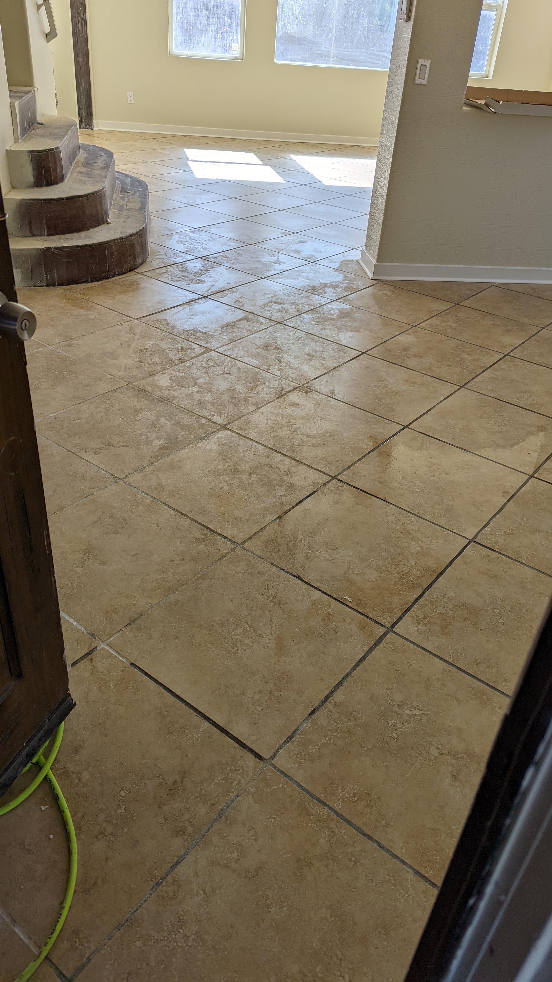

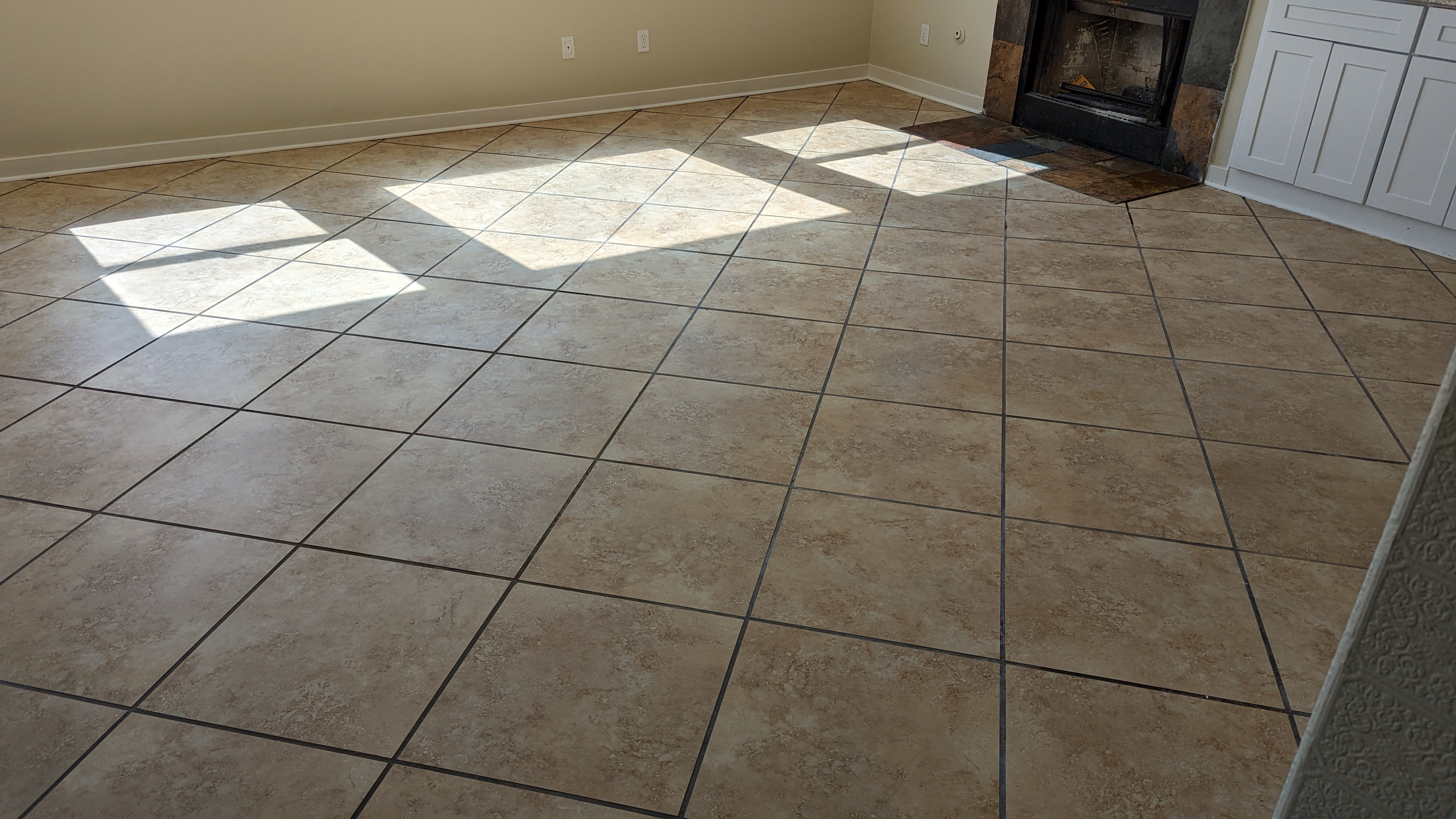

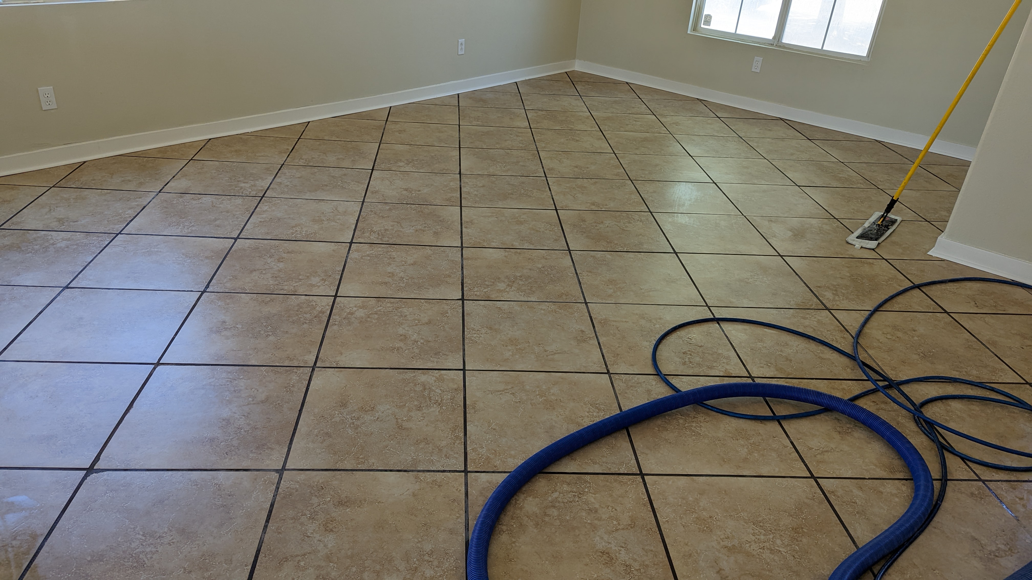

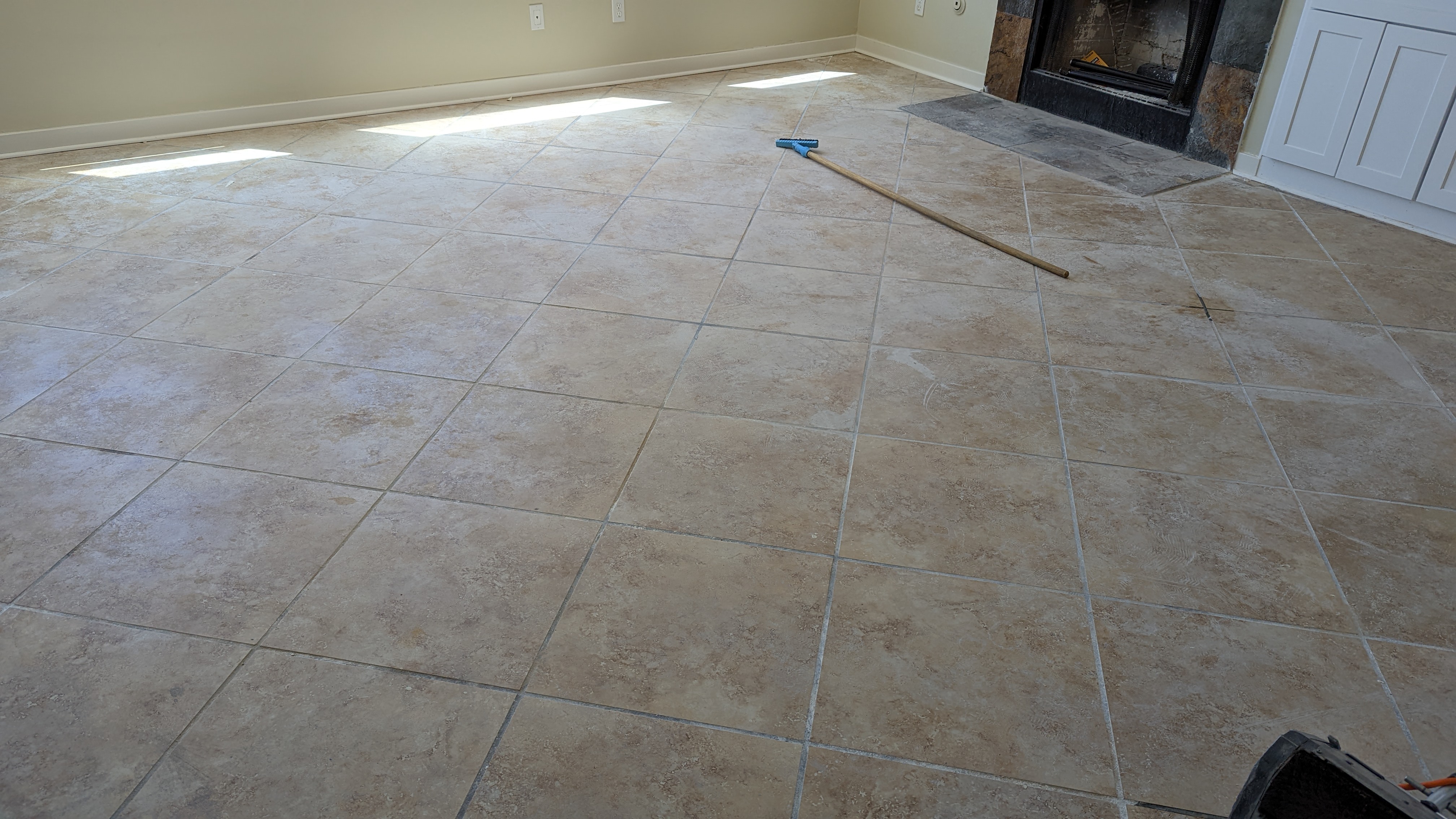

Go clean the tile he says,
PXL_20220511_205007715.jpg PXL_20220511_205012021.jpg PXL_20220511_191134081.jpg PXL_20220511_225426370.jpg
6,517
Bc
StrIpper, black pad, either an OP, or 175, dwell, scrub, suck up the slurry with a shop vac, and rinse W/TM?
Shitty job NTL..

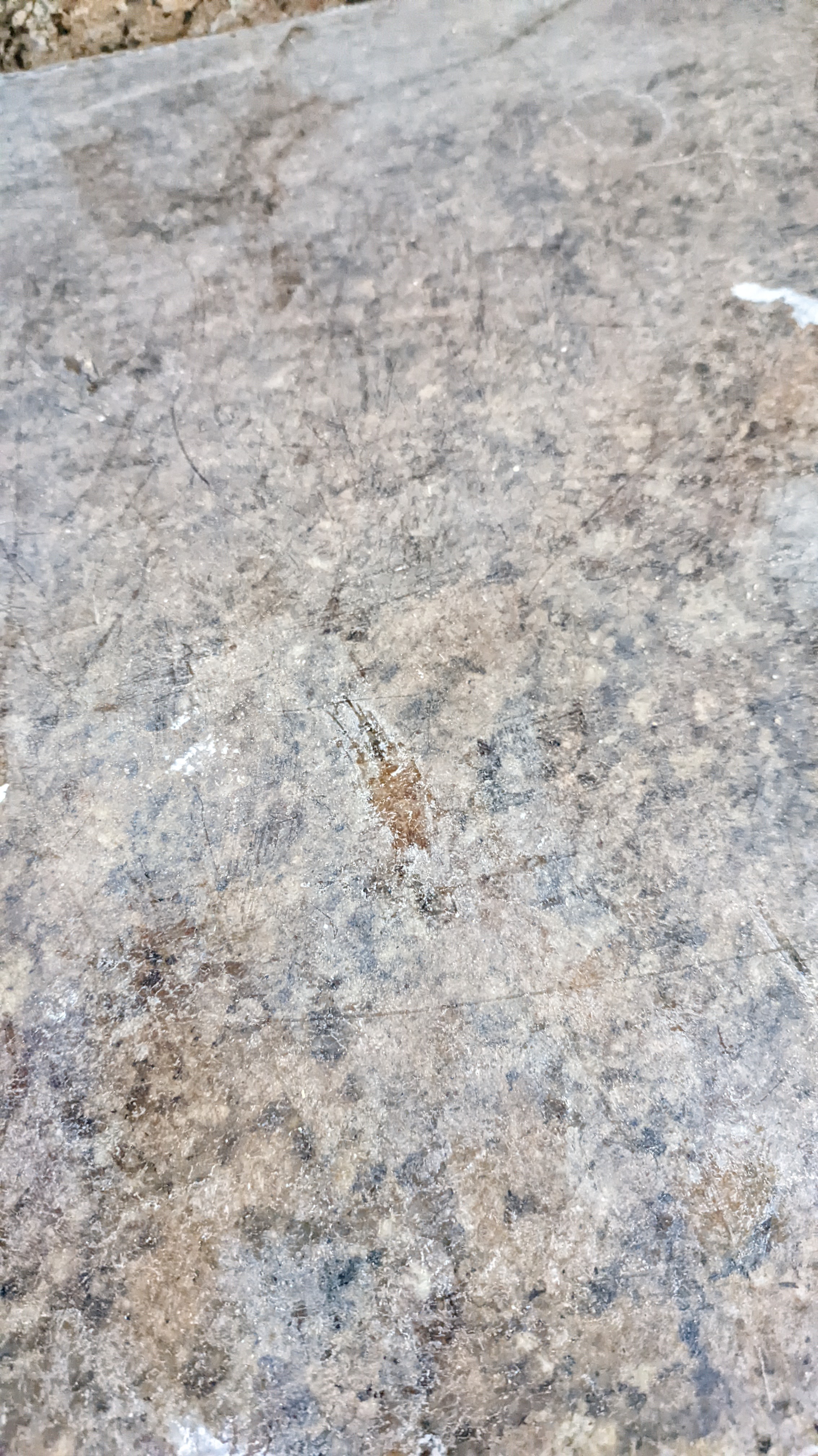

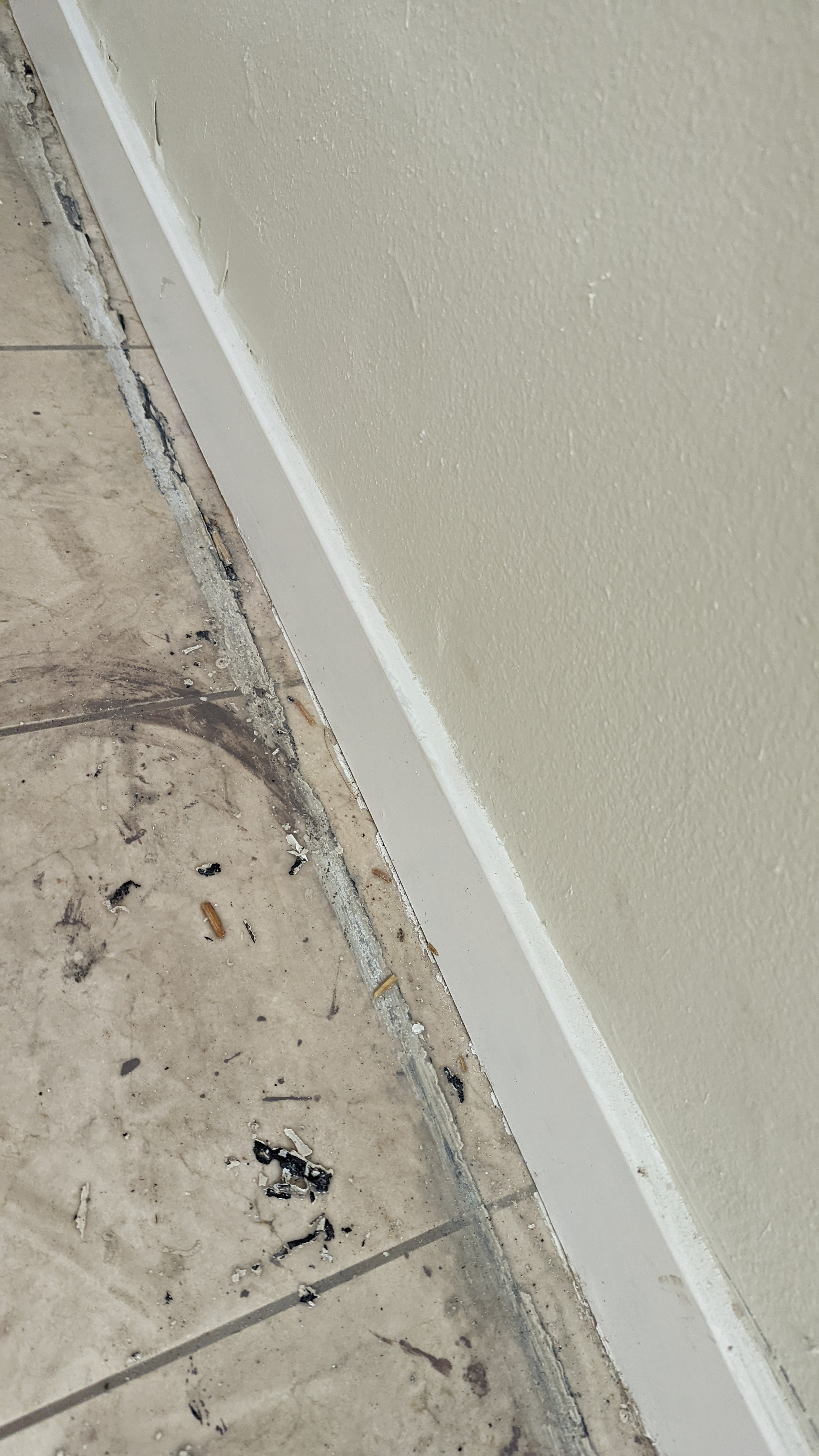

The old owner used a 2*4 as baseboards and caulked the hell out of it.
Yes it on top of a marble floor.
