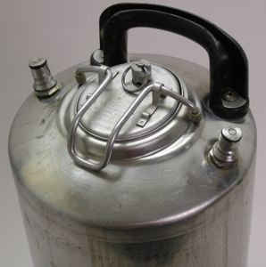

I don't want to use in-line sprayers anymore so am thinking of either going with a battery sprayer or a compressed air Pepsi type sprayer and would appreciate any positive and/or negative feedback on either of these type sprayers from anyone using one or the other for applying pre-spray.
9,605
Hawaii
The bad thing I heard about the pepsi sprayer is the hose breaking and making a huge mess by spraying everywhere. I use a omni battery sprayer. It works for me.
I never understood the appeal of pepsi spray cans.
(they were once a BB de juor item.. :roll: )
they're stupid heavy, you need a compressor on board to re-pressurize them and the valves have been known to pop off the top and spray juice all over Mrs Phiff's ceilings....
NO THANKS
buy a good corded or battery electric sprayer ....leave the pepsi cans in the soda fountains
