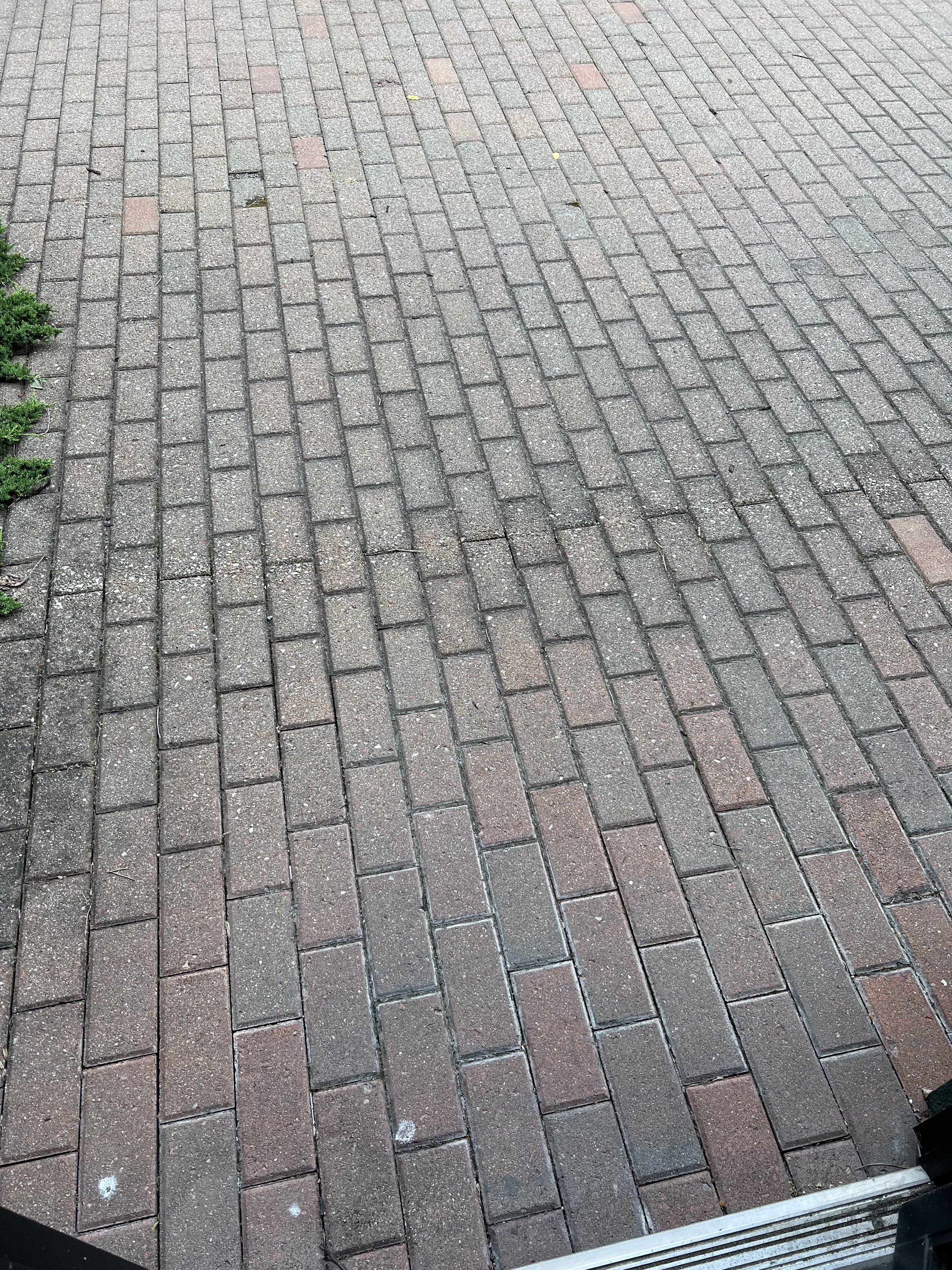

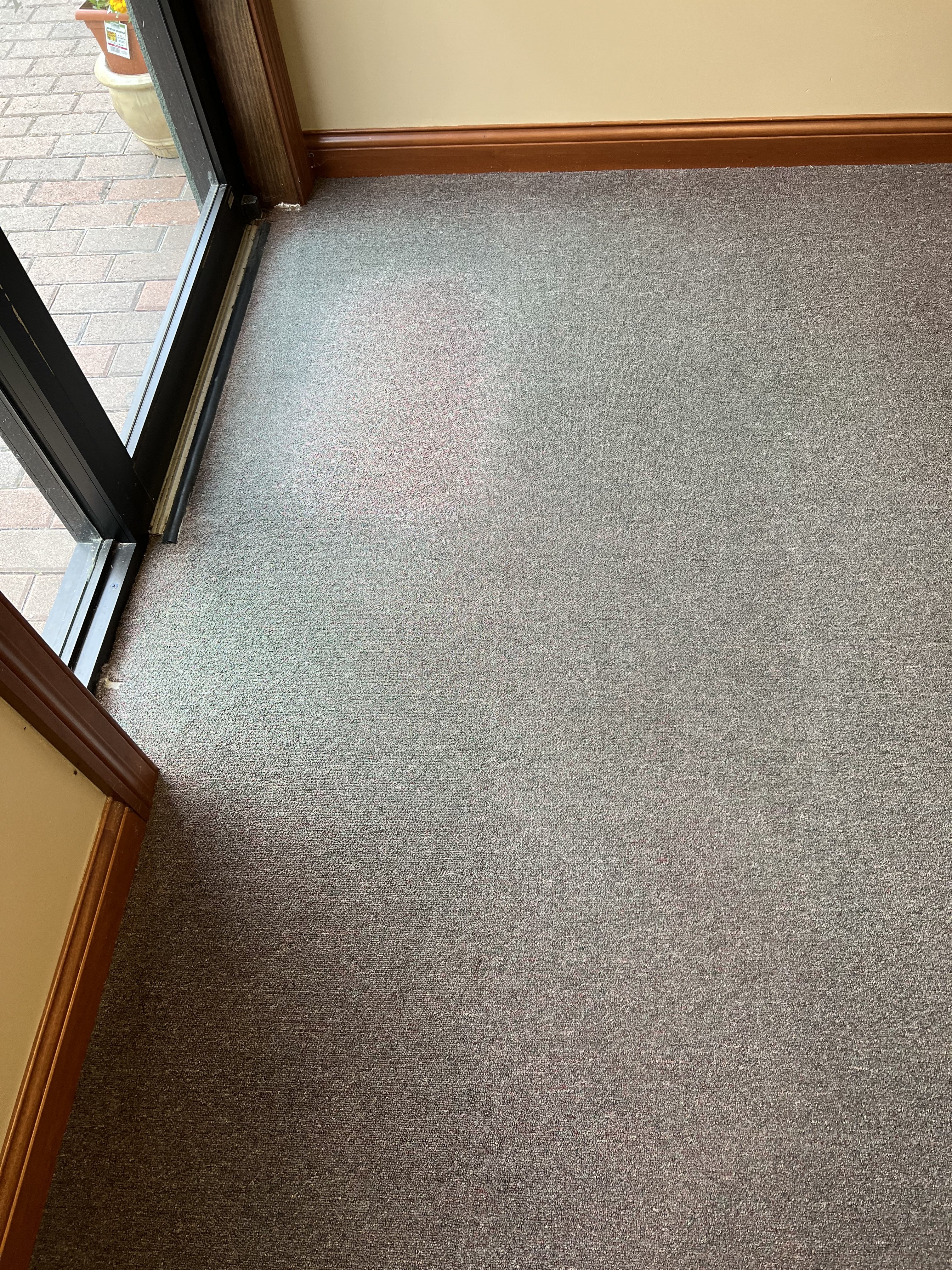

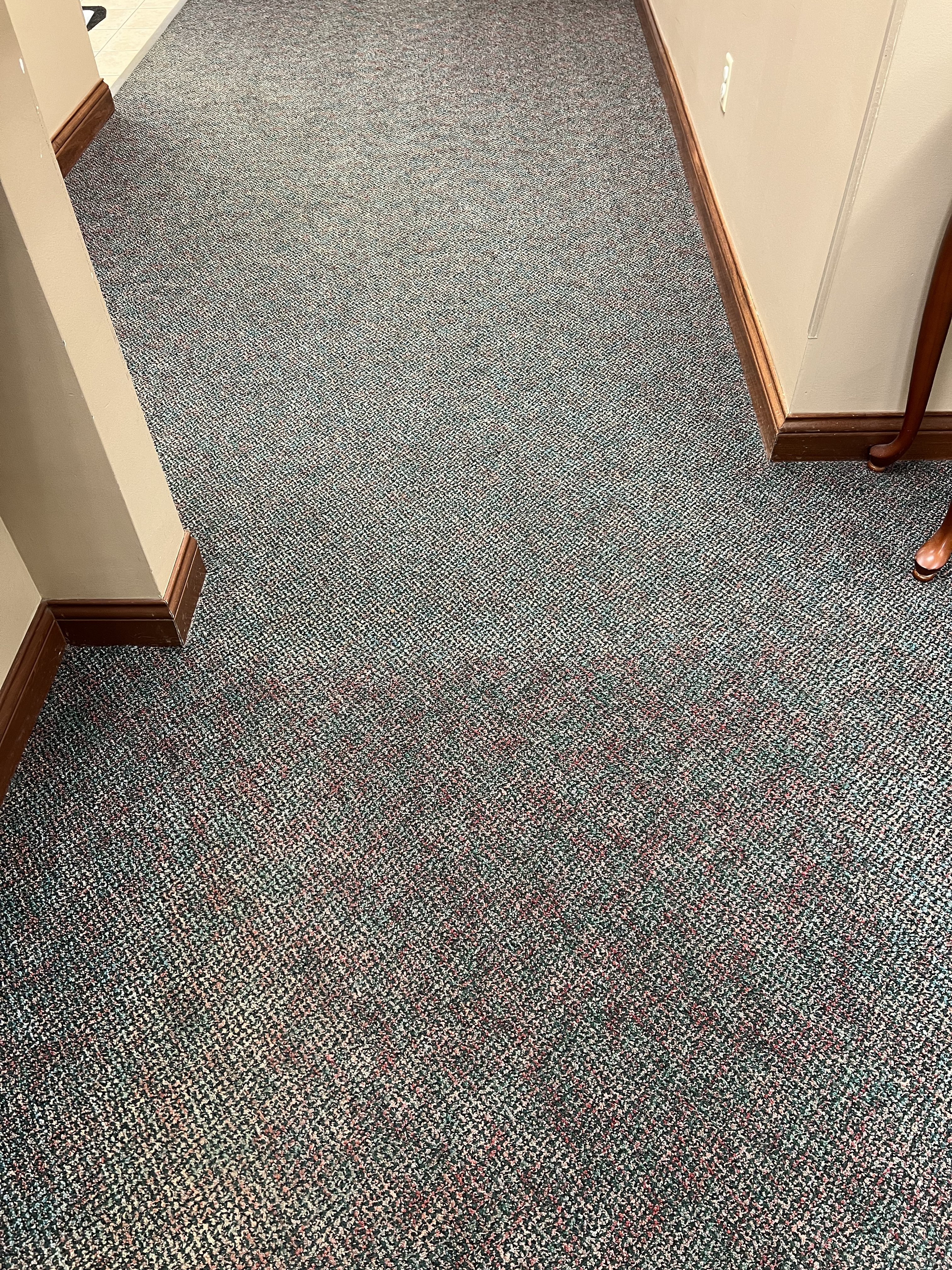

* pics of the outside entry surface, color contrast between traffic areas and under mat area, and some goofy discoloration happening on some carpet on the other side of the building.

Pic 2 says it's uv damage
If pic 1 is where a mat also normally sits then it's 100% uv damage.
Carpet uglies out before it wears out.. kinda like.. nvm
That second pic is a different type of carpet on the other side of the small building. I definitely think that could be UV damage. That specific carpet has actually only been cleaned a few times over the years. They rarely used that side of the building and when they did it was very low volume of traffic.
The carpet almost looks like it’s turning black from the bottom of the pile and migrating up over time, when you see it in person.
15,253
I agree it's just worn out.
I don't think any peroxide type cleaners will bleach it out.
