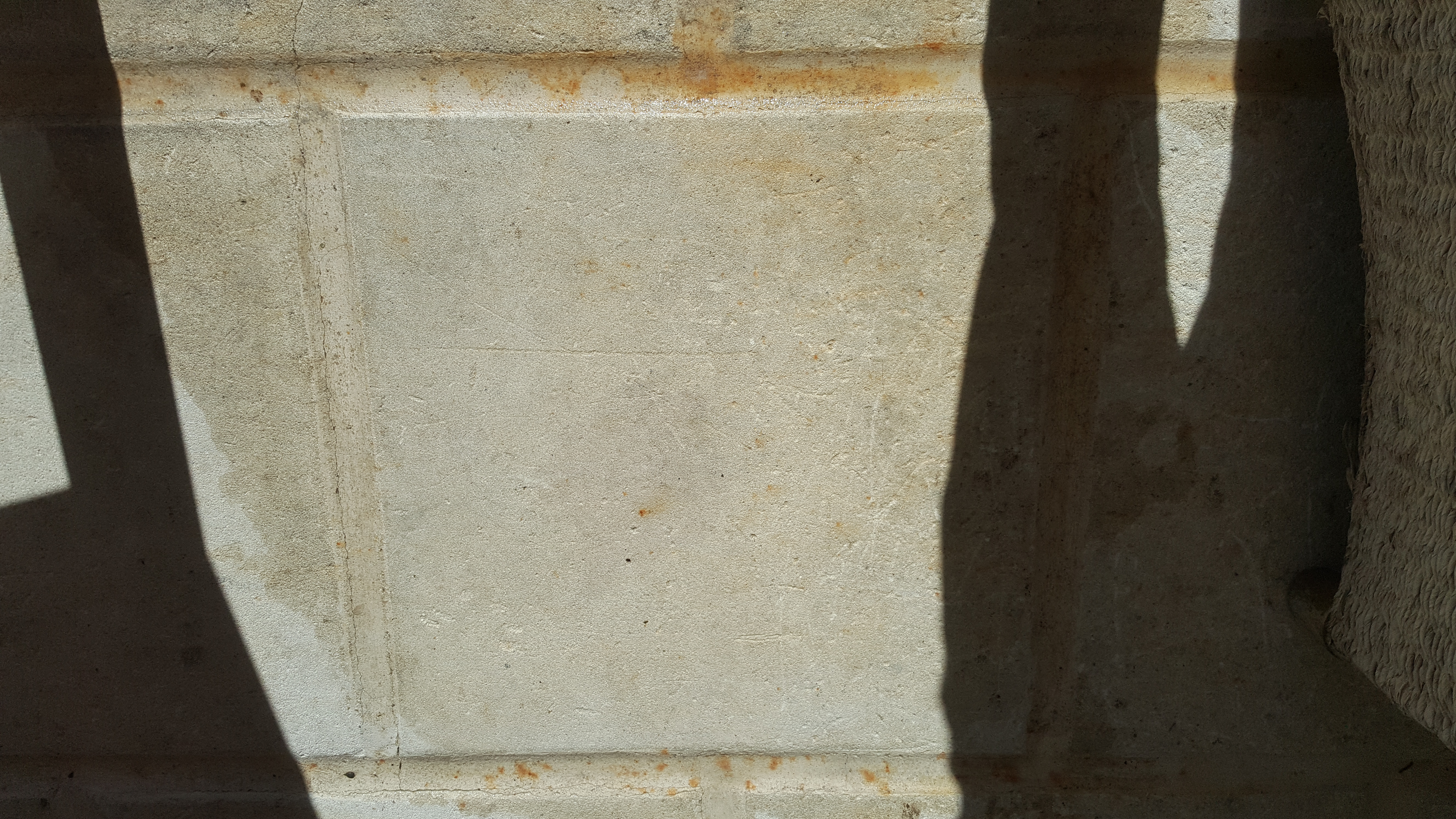

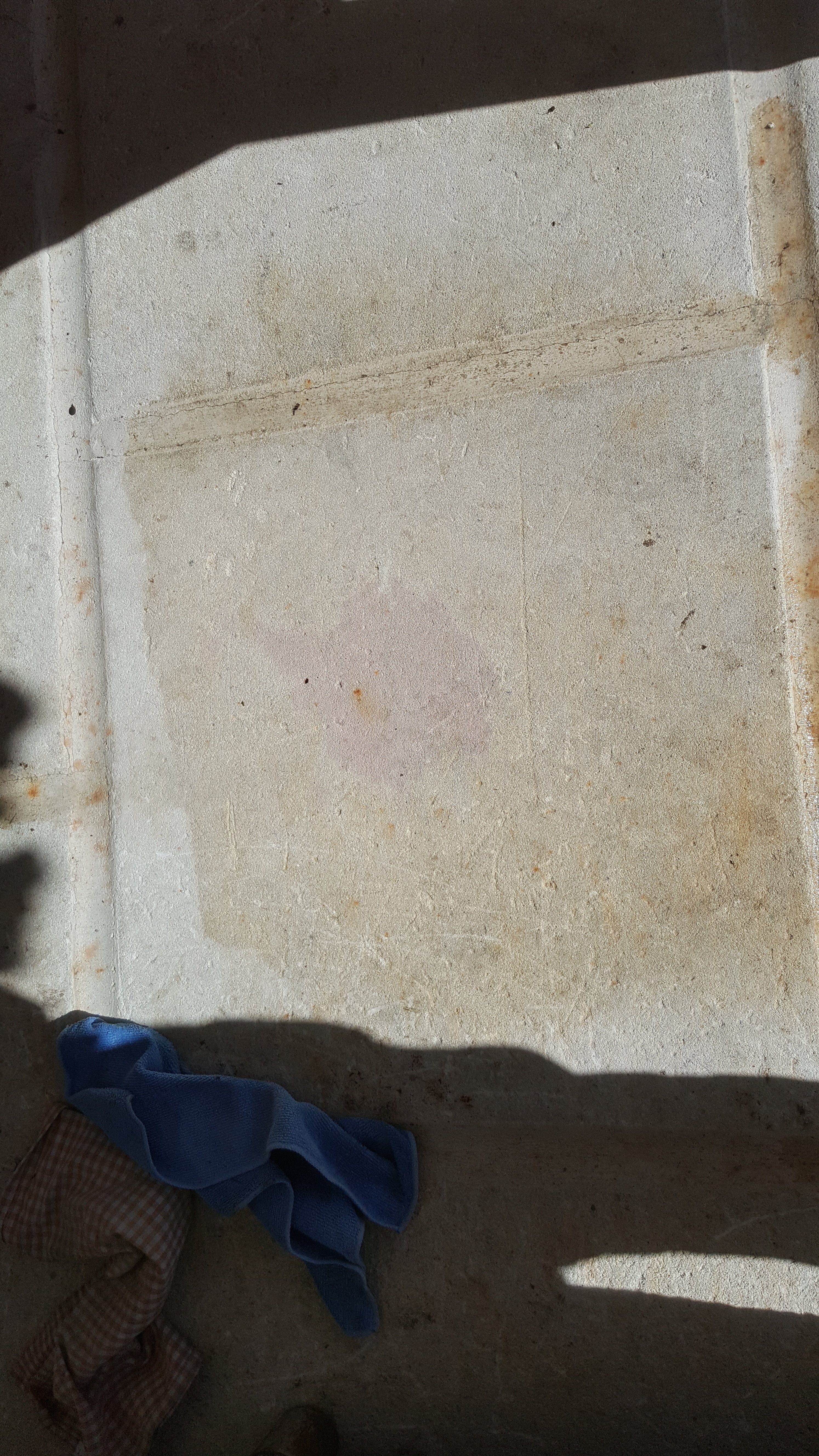

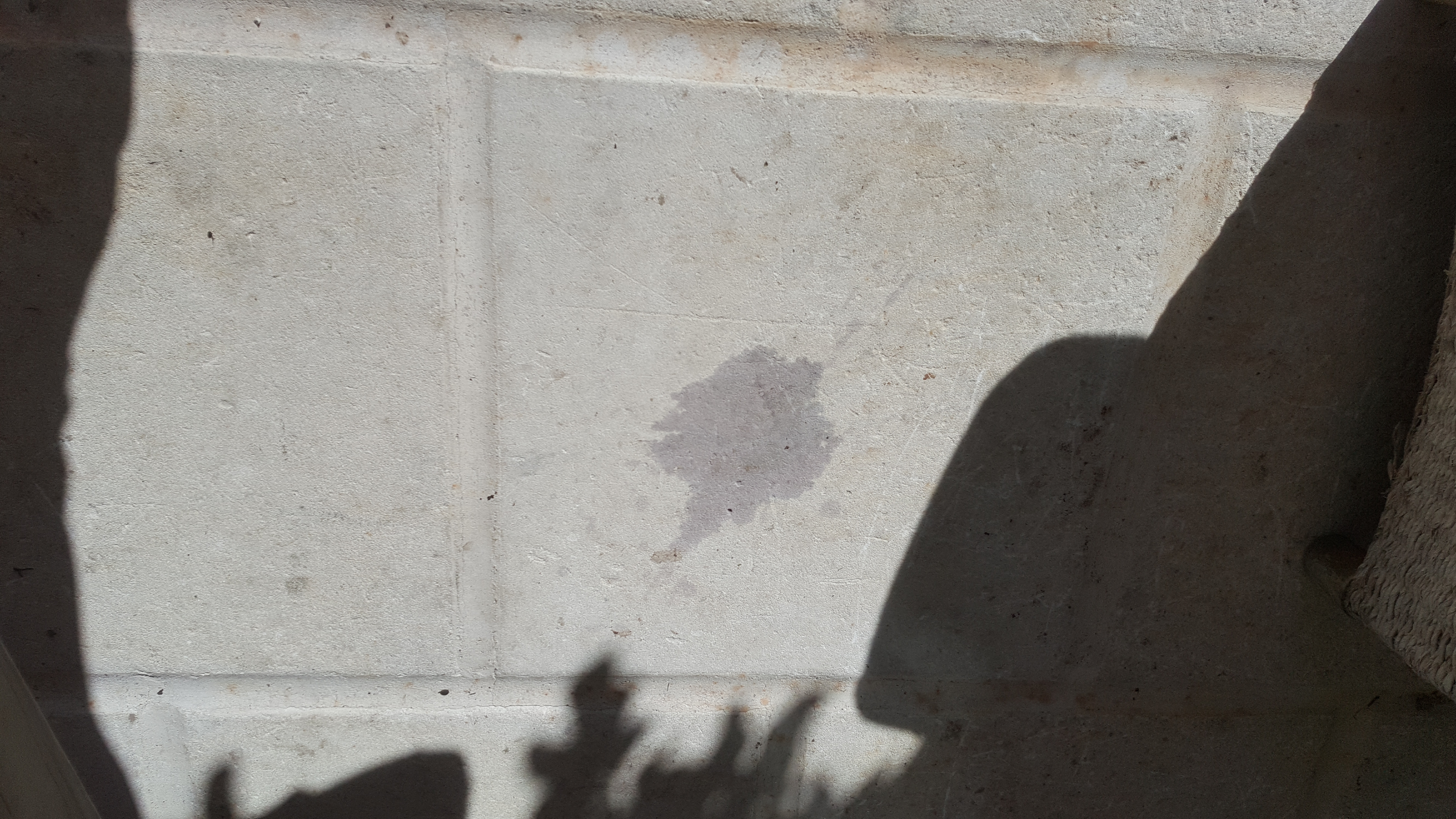

Limestone with red wine on an outside deck I did today
Before I started
