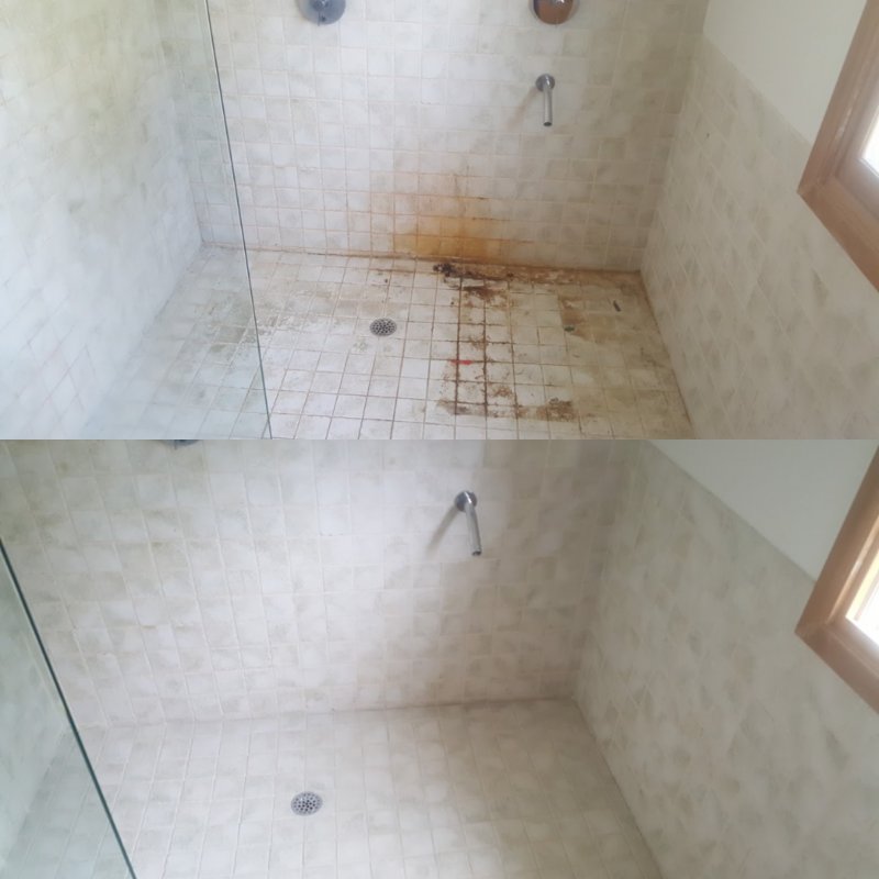

lol there was a soaking tub there for some reason, its why it was so nasty underneath
