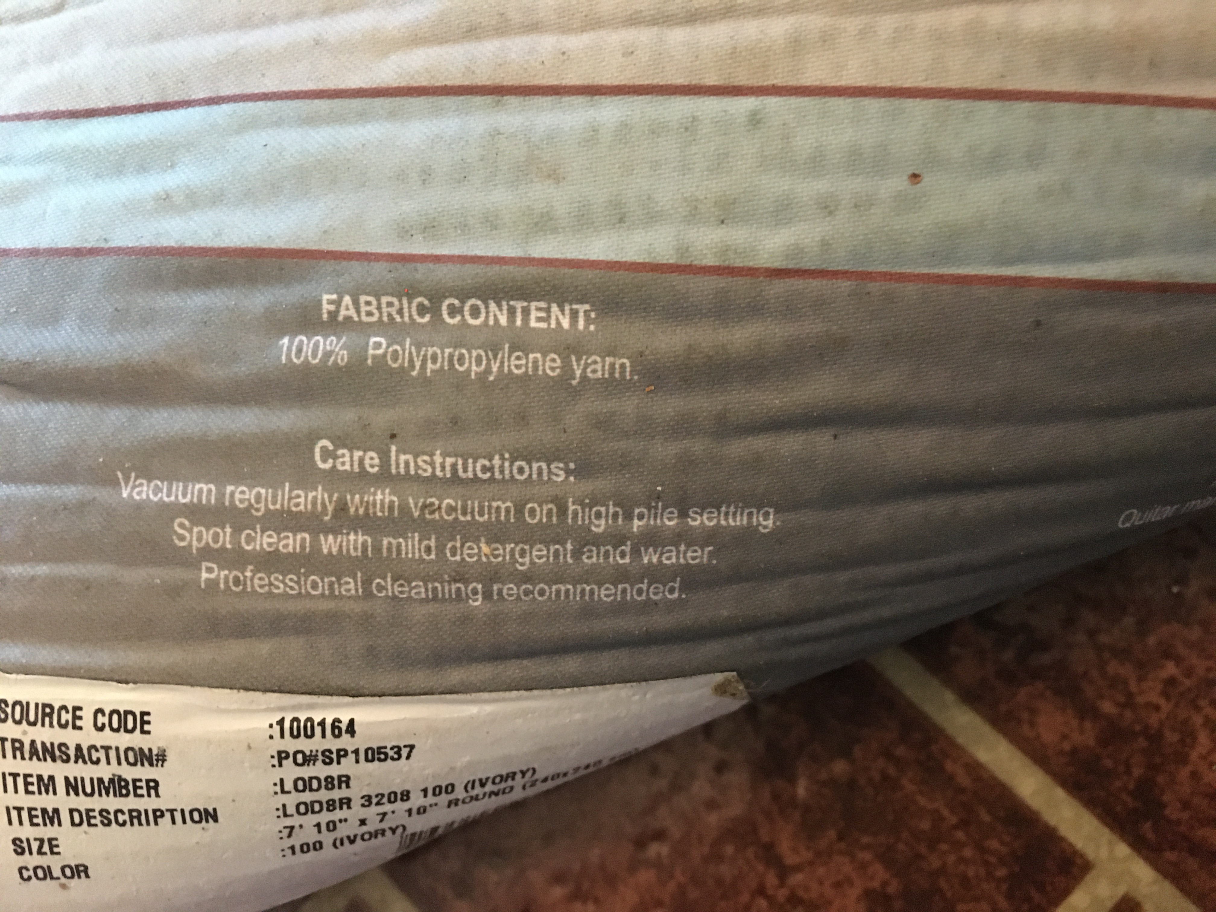

sorry I didn't include much info the rug is 100% polypropylene its inexpensive and was cleaned on site as it dried customer noticed the edges became wavy. We clean our share of rugs every year no issues but this was brought to my attention and I really had no answer. I like the idea of the clothes iron and may give it a try.

100% polypropylene rugs often have cotton, linen or jute in the backing. This is what causes the buckling. Usually it will go back down as it continues to dry. When we do these in the shop, it's common to have them curl bit as they hang on the drying rack, they straighten out.

Jay, polyester grows as it gets warm and melts at a very low temperature, so using an iron could be risky. It's possible that it will settle down when cool and dry and it's also possible that nothing short of blocking and adding a backing or sizing will help.
My recommendation would be to refund the cost of cleaning the rug if it doesn't settle down by itself. Just not worth the time involved in trying to solve an inherent problem with this type of rug.

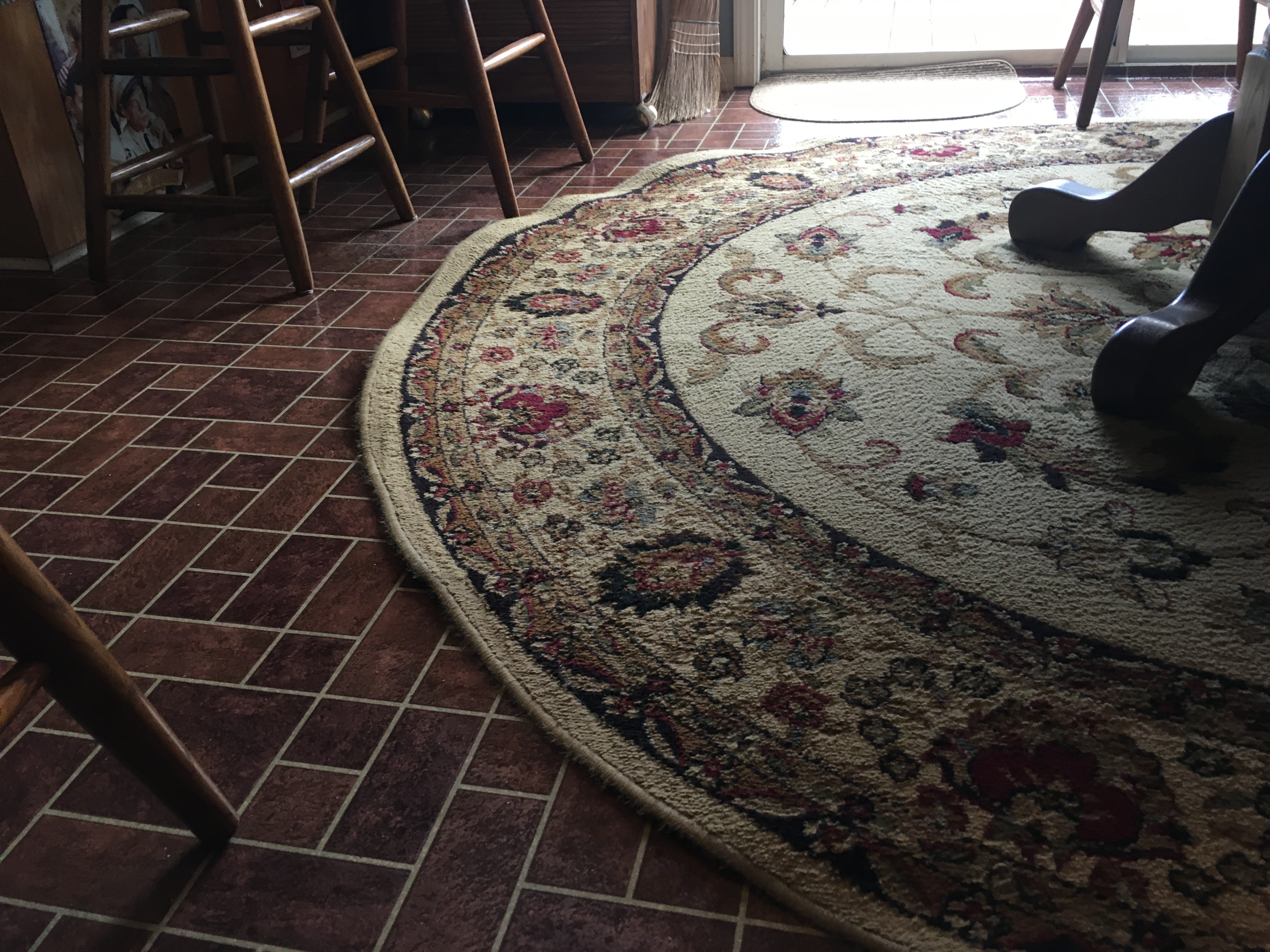

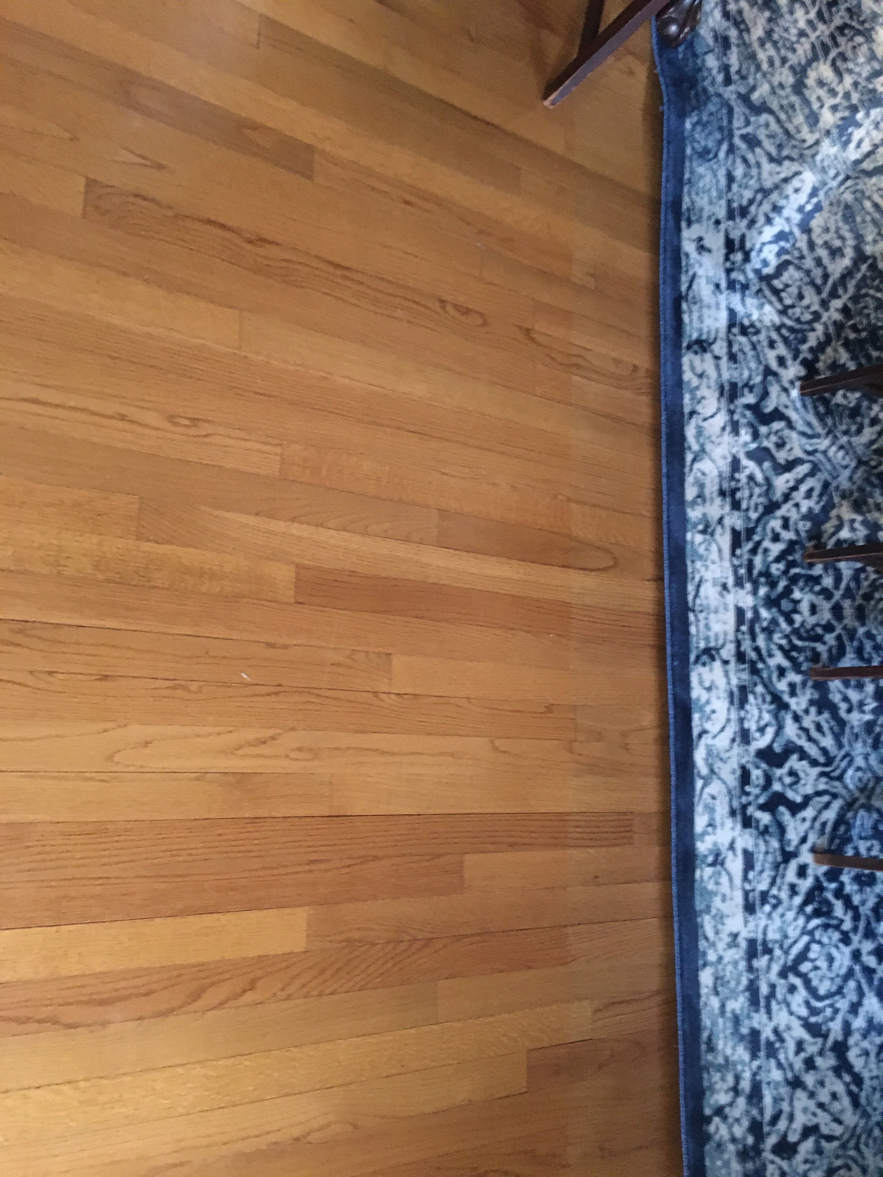

Two real scenarios. The blue rug during cleaning :
“ ma’am,can I show you this? As you know I had to use water to clean up the spots on the rug. This buckling is from the cotton that’s weaved in the backing. It does this when exposed to moisture. Give it a day or two and it’ll relax.”
“Ok, no problem”
Next one:
“From the flushing method I’m using...it’s causing this polypropeline to buckle. It’ll relax back down once it’s fully dried. Just please watch your step when you walk around it.”
She accepted that explanation.
And don’t give me any excuse for saying encapsulation would’ve prevented that. It started buckling almost right after I put a light spray on it.
