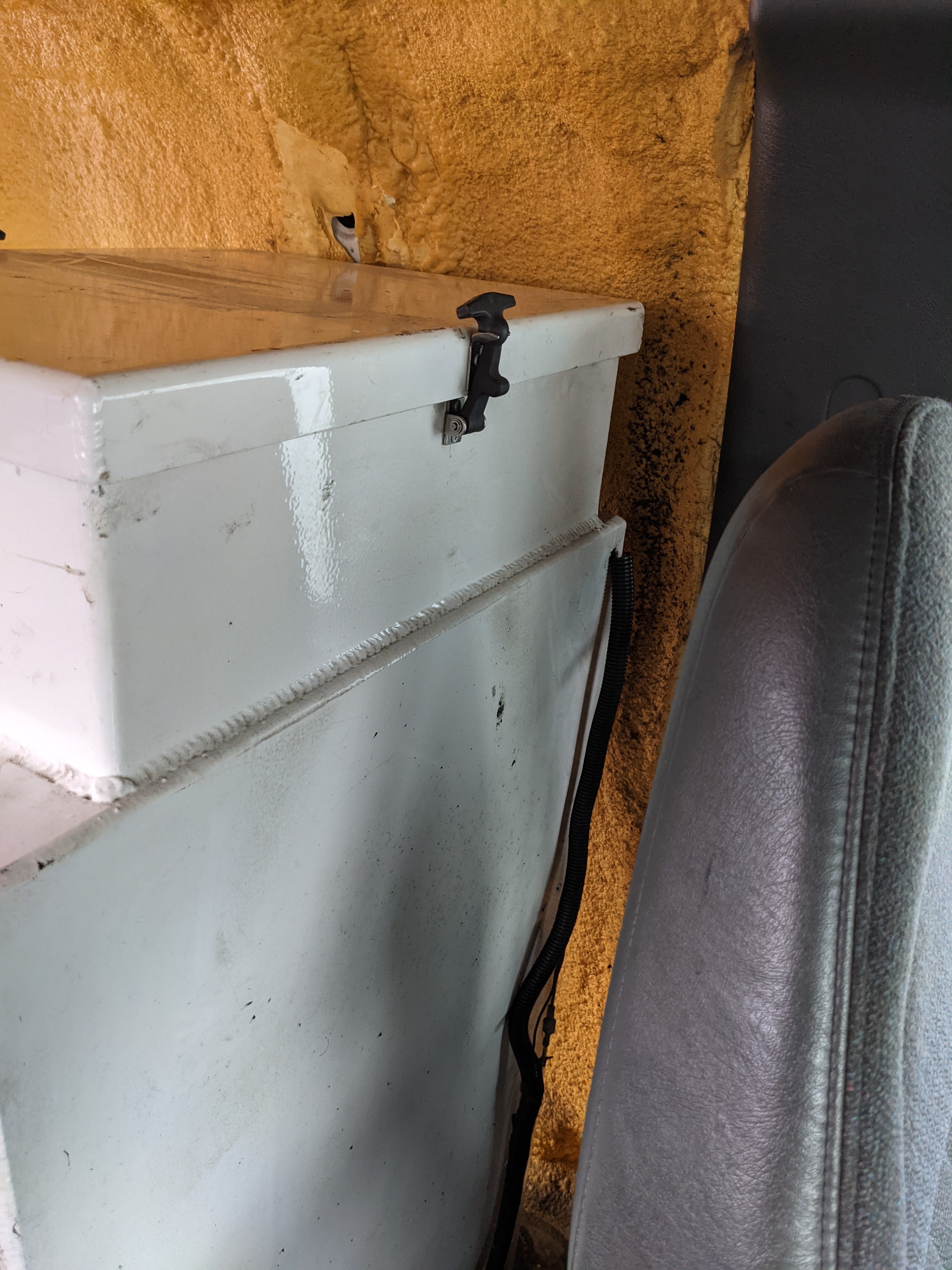

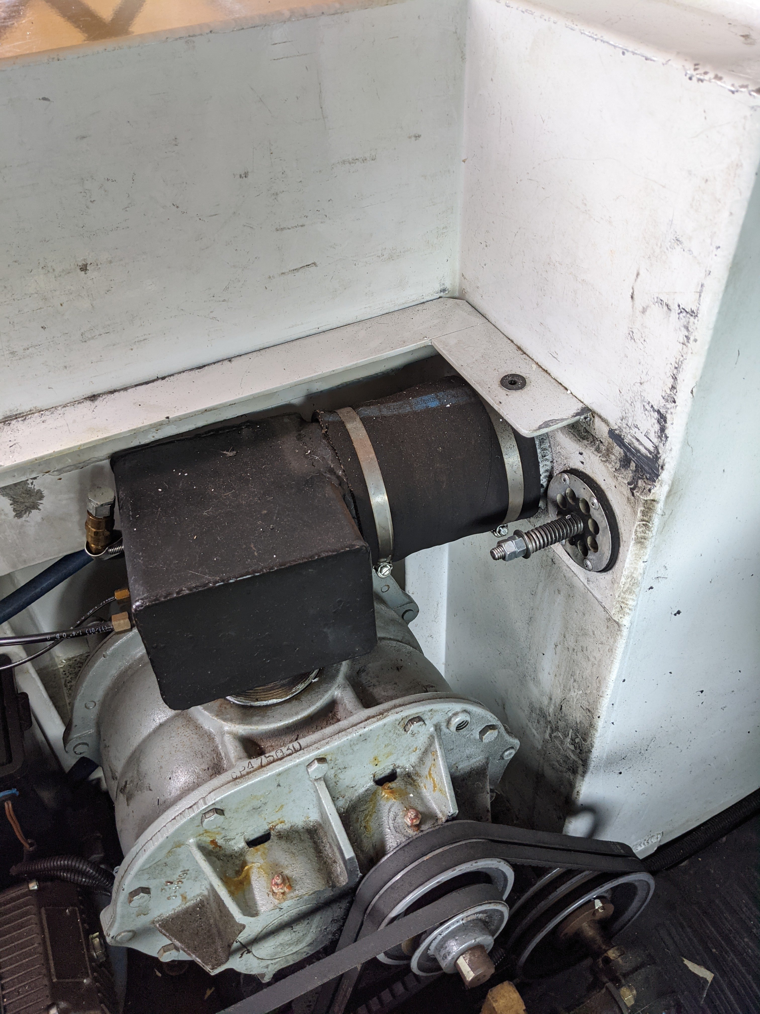

I have a 2002 cleanco 47 that seems to have developed a leak in the waste tank. Filling it up with a garden hose, it doesn't leak. Running it under load, it begins to leak as soon as I turn it off. Anyone ever pull the tank out? Biggest problem seems to be the connecting hose from the blower to the tank. Not a lot of room to move either.

My old prochem legend was a pain connecting the blower to the silencer just like that short hose you have pictured.

It appears to be coming from the bottom of the tank. That's the problem with the cleanco design. I have maybe an inch of wiggle room from the tank to the wall. Have to take of the instrument panel and disconnect the by pass hoses and sensors. Will have to pull the hose reel as well.

You're going to find that hose connecting to the tank will be petrified. Use a saw all to cut it off.
When installing new hose, clamp your vice grips on the reinforcing wire and pull a couple of loops out on either end and snip wire off. That makes it easy to slide back on to your tank/blower hose barbs. Pull your seats out and do a thorough inspection for hairline fractures and try to trace the path from where the H20 is coming from.
A full scale interior cleaning of the tank will probably be required prior to tank removal.
as Rob mentioned, it's stuck on there pretty good.
You may not have to cut it though
douche both ends with PB blaster or your favorite penetrate.
blast it again couple hours later, blast it again before you go to bed
grab your bigazz channellocks, get a bite near the end and give it short twists the length of the nipple
If you get it move at all, then bite the other end for a twist.
that's worked for me on many a stuck hoses.
Including blower to tank and blower to silencer
