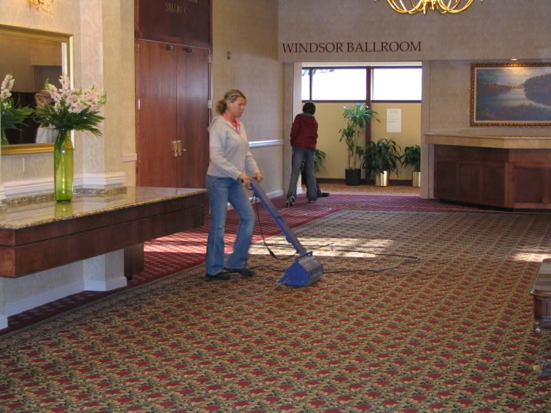

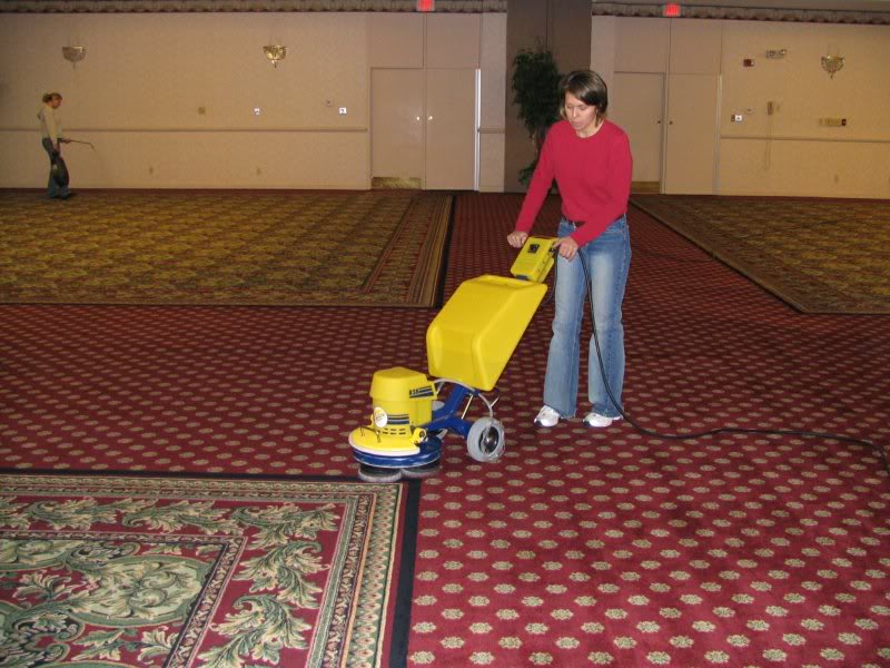

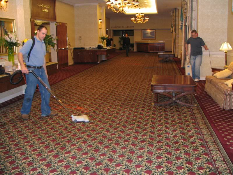

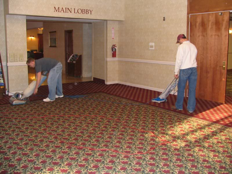

I always pile brush and vacuum first, this removes a lot of soil. As for drying times if you need to vacuum after, airmovers will allow it to be ready to vacuum within one to two hours. We almost always vac after but there is very little picked up especially when compared with the pile brush and vacuum first.
Here area a few pictures to show the pilebrushing followed by vacuum before encap; then encap; then post vac. So easy even girls can do this work! (just kidding, just a joke)
