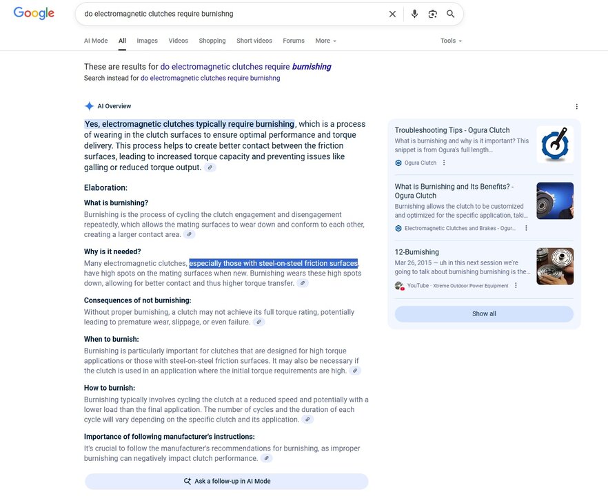

I'v heard you shoud turn the cds key on 5 seconds off 5 seconds a bunch of times.
Why??? Ya tryin to wear out the switch??? I told ya and i showed ya there's no such thing a bedding an electric clutch of this type and whoever told you that doesn't know or understand what there talking about.
Reactions: Newman
fredtestseven
22
Well Ogura, Pitts, etc say you don't know wtf you are talking about and they make the things.
I didn't want to post and I PMd him the other day but I don't want others following your bad advice. Most manufacturers call for the key on 5 sec on then off cycle 25-40 times to burnish a new em clutch. Not doing so potentially reduces its torque handling capabilities significantly.
be careful who you listen to folks...
in case Dwayne needs a google screenshot since I know he loves them
AI/google is not a substitute for critical thinking and proper research especially if you don't know what questions to ask
*the caveat to this is clutches that are specifically listed as pre-burnished
