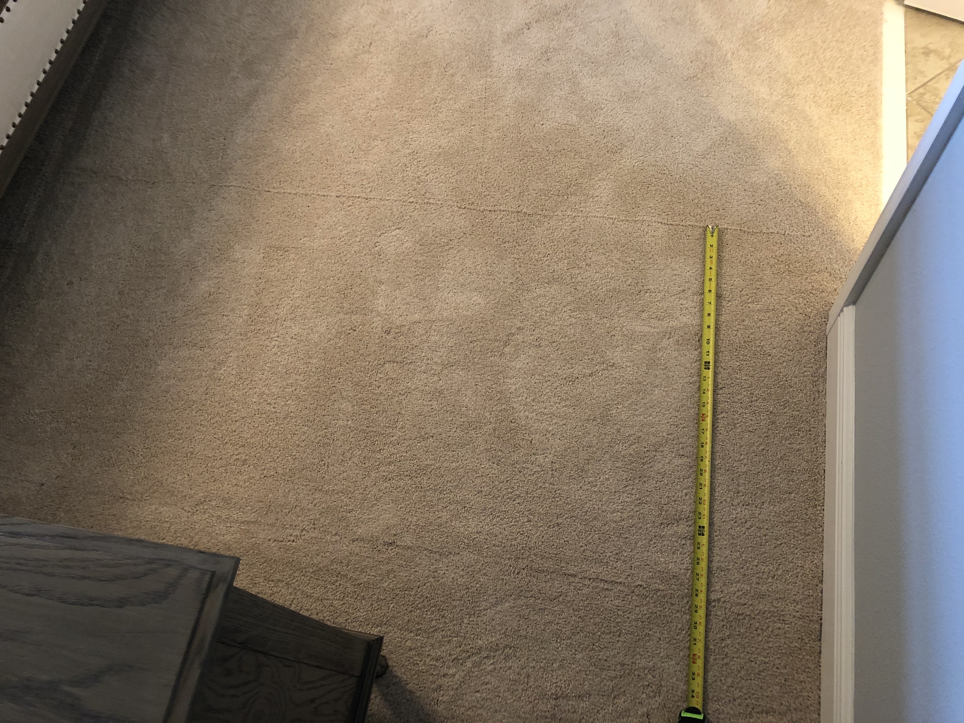

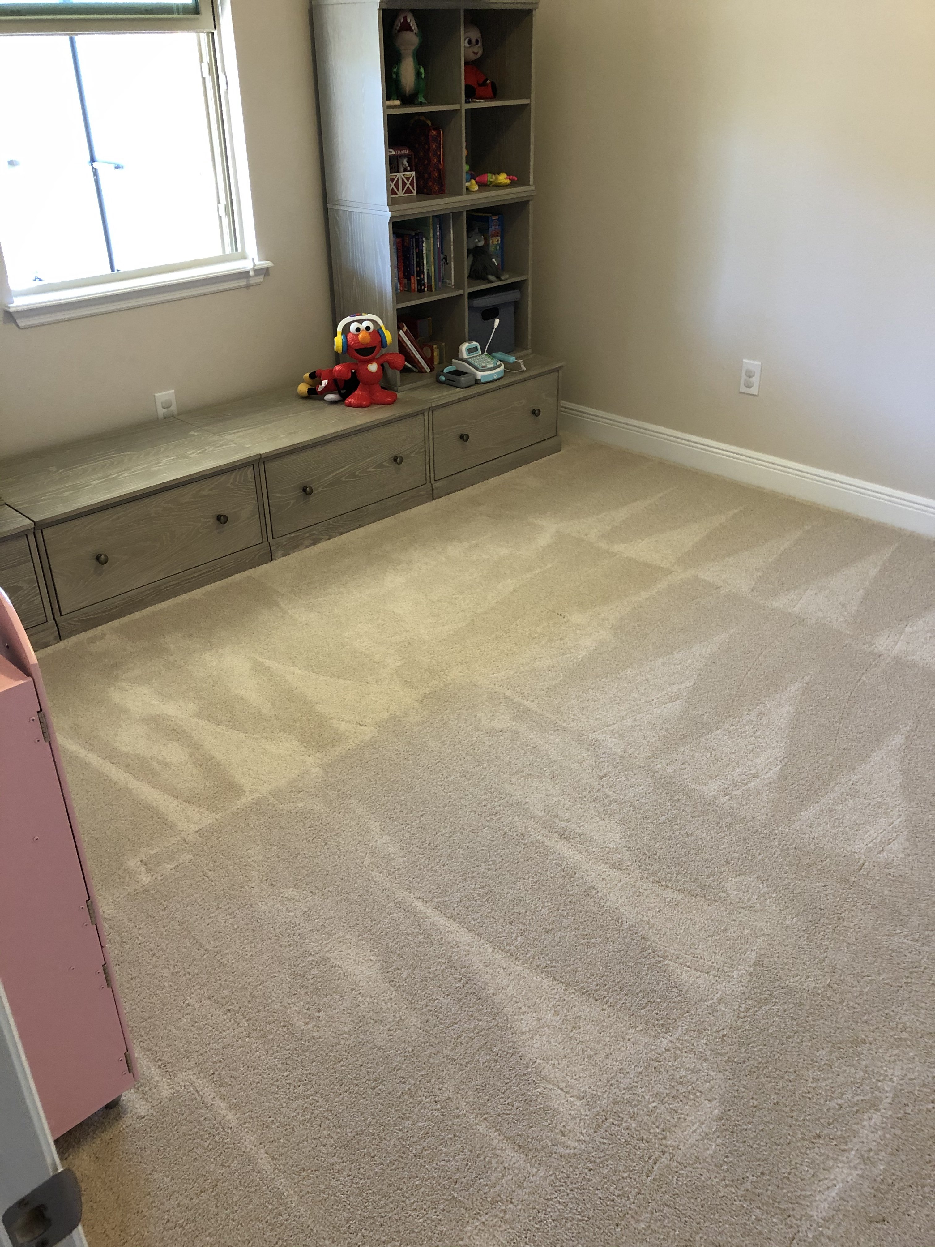

So I had some new carpet installed in my house today. Was looking around when I got home from work. The 1st room they did, the first 4’-5’ of the roll is yellow like something spilled on it during storage. Another room, which is 14’ x 16’ had 2 seams installed along the 12’ length. One at 9.5’ and another just over 2’ away at 10.5’. The first seam falling right in a highly trafficked doorway.

Have them pull it out and replace it. The yellowing could be a combination of preservative (bht?) As well as exposure to UV light. Last piece on the roll get more light exposure than the rest of the carpet. Usually not cleanable. You need to determine where the Seams are to go with the installer prior to installation or put up with where he chose to put them. Insist on power stretching, otherwise the carpet may buckle from humidity or cleaning.

Installer cheaper on the install. They just took the fastest route. It's not there home or they would of put that seam 2 ft off opposite wall.
I would have to complain about that.
Installer also should of stopped laying the stained room.

yep joins need to be discussed beforehand otherwise you'll get the "this works easiest for us" install
power stretcher needs to be discussed also, because if a lazy installer thinks he can kick it in faster he will..
that discoloured section would have me in a tourettes fit 🤬

I agree with others about talking to the installers about where the seams will fall prior to installation. Really though, it need to be talked about when the carpet is ordered. Depending on the layout of your rooms, you may have to order a bit extra to get the seams to fall in a discrete area.

Can you sketch a layout of the 2 rooms and hallway and post it? If nothing else throw a fit about the seams showing not just the location. The visible seams indicate a subpar job to begin with.
