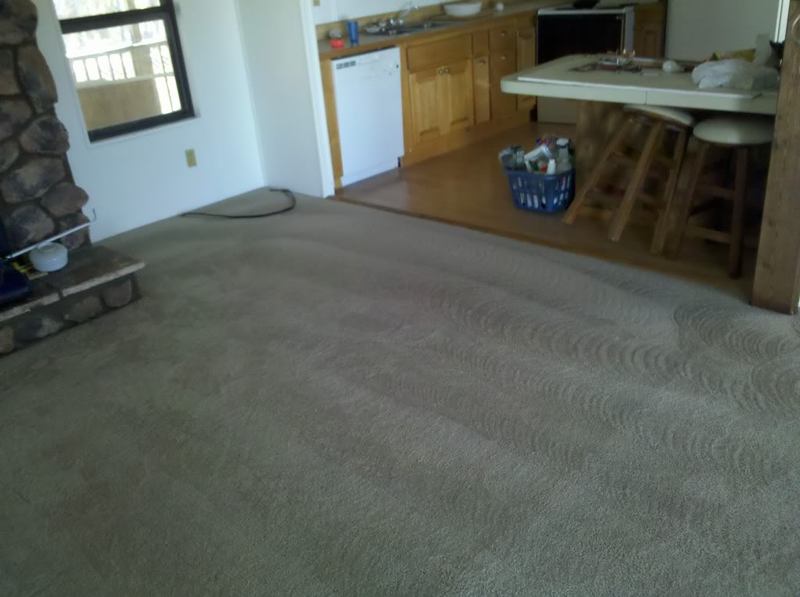

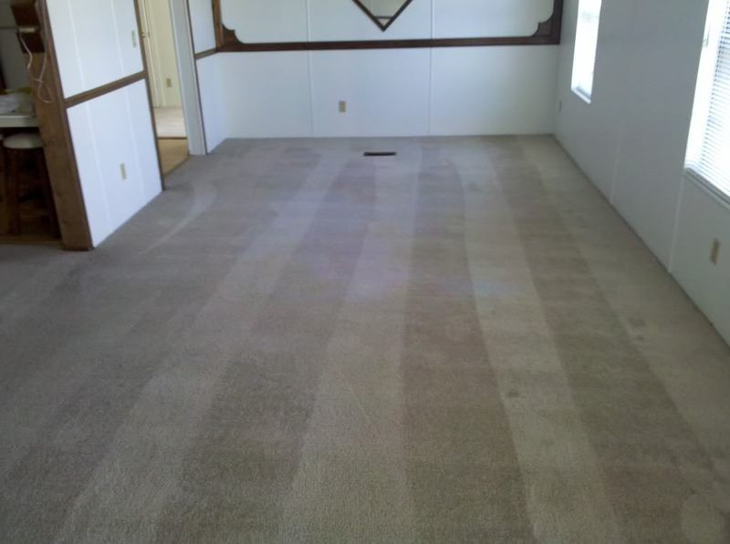

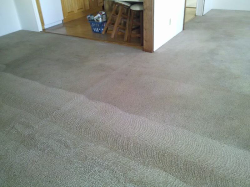

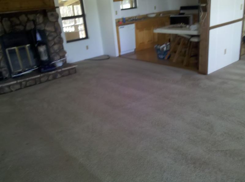

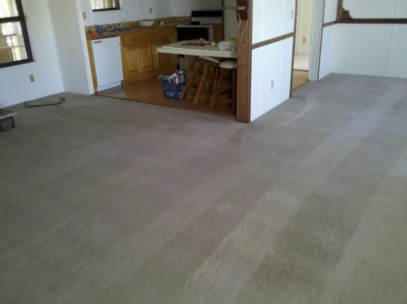

Here is a job I did today. 900 sq ft (the whole double wide trailer) 1 hr 40 min drive up to drive away, which included an estimate and getting the check. Skipped pre vac, I even edged and groomed. Just straight prespray (traffic slam) and rinse with prolon and rx-20. Pictures taken with my droid 1 phone. I think it looks pretty darn good (near about new) even though I didn't spend 2 hours vacuuming or hours doing other stuff...... Pictures were of the living and dining room which were the worst
bill was $165 and made 100 an hour doing the work.....could of charged more but it was for a church.

When did carpet cleaning become a "speed game"??
Sure, you rotaried that carpet and made it "look" clean, but what kind of soil load did you leave behind?
You don't half to vacuum for 2hrs, good grief, I show a couple vids and you guys think every carpet needs that kind of extreme work. Do the work thats needed and quit worrying about your hourly rate. CHarge enough so that you can make your hourly rate doing what you KNOW you need to do so then you don't have to brag on here how you skipped steps but still got it to look satisfactory. Hell, any decent cleaner can make it look cleaner, what separates you from them?

Exactly??? Hardly. It would have "looked" the same, but you would have left a LOT of dust. There was a LOT of dust on each side of the bed where it was matted down. You're kidding yourself if you think you can get that out wet, with whatever tool.
I feel right about charging that because I saved them a couple hundred dollars. And they know its clean.
