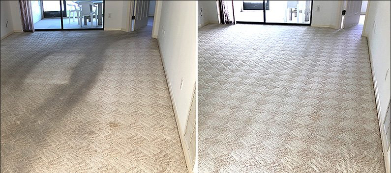

This condo was owned by an old guy with something wrong with his feet. Over the years the carpet was walked on with bare feet slathered in some kind of medicine. Later he walked with a cane for some time and then a wheel chair for some years. He finally moved out and I was called to clean it. This was the worst room but others were also bad.
Cleaned this room first...Saiger Red, CRB rinse...and then sprayed it again with Saiger Red. Cleaned the other 2 bedrooms and then cleaned this room again. Put down 2 blowers on this room only, put everything back in the van except the blowers. Went to lunch and came back for the blowers. This was way tougher than it should have been.
27,919
Cleaned this room first...Saiger Red, CRB rinse...and then sprayed it again with Saiger Red. Cleaned the other 2 bedrooms and then cleaned this room again. Put down 2 blowers on this room only, put everything back in the van except the blowers. Went to lunch and came back for the blowers. This was way tougher than it should have been. View attachment 104013
Nice job. Those are the tough ones where the CRB shines.
