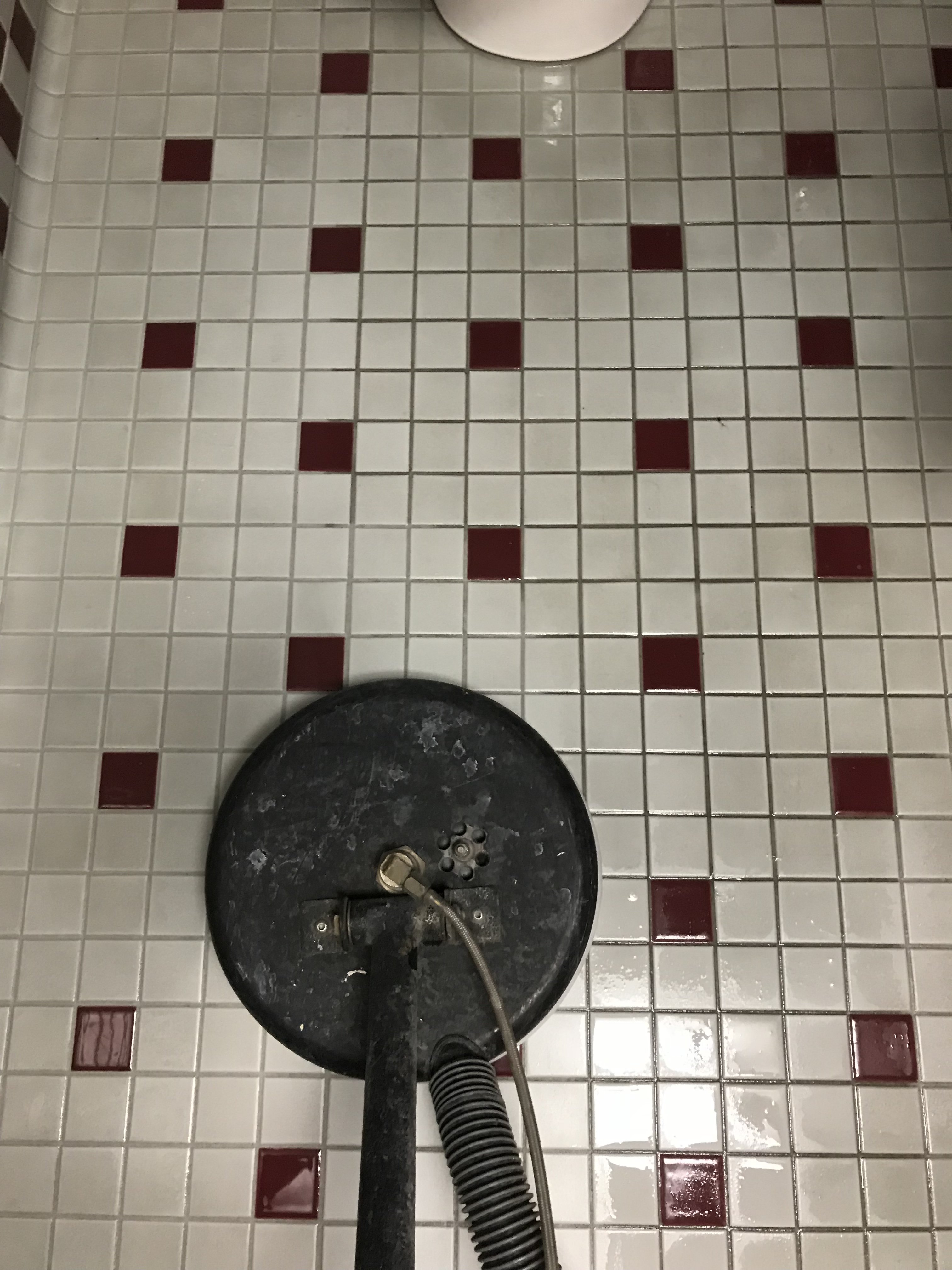

Hi Mikey. I took a picture of the tile last time we cleaned it. This particular bathroom cleaned up pretty good, but the other 15 don’t hardly make a difference. Do you have any suggestions?
