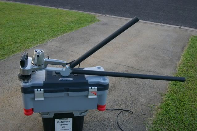

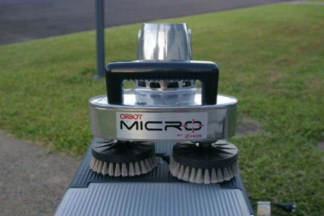

Okay, with crappy ones, I'll use this tool...........
Depending on the severity I can agitate the carpet similar to a pile lifter.
Using the short handle, I go up the stairs agitating the treads.
(Note: The photo only illustrates the positions the handles can be used in. I have only ever used the back, or bottom hole.)
On the top, I change to the long handle and do the risers on the way down.
Then I can use the floor tool as above, or I can use my upholstery tool with agitation.
