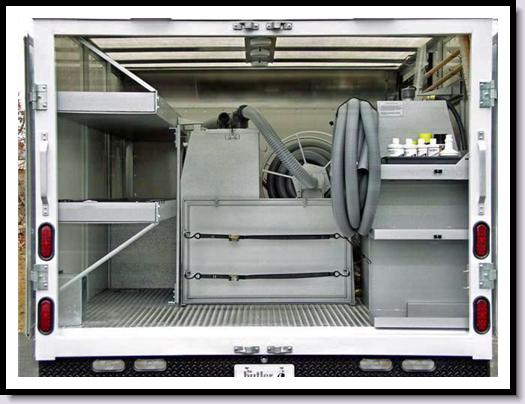

Butlers W4500
116,029
Still not enough room IMO
* Instrument Panel with Dual LED Color Coordinated and Illuminated Rocker Switches . Cold Water Convenience Inlet . Hot Water Convenience Outlet . Detergent Control Valve . Dual Wand Fittings . Gauges include: Tachometer . Water Pressure . Water Temperature . Vacuum . Hour Meter . Detergent Flow Meter
* Equipment Shroud Molded and Contoured Black ABS High Impact Plastic
* Clutch Activated Cat Pump Model #435 Customized to Butler Specifications
* Butler Maximum Vacuum/ Blower System MD 4007 Competitor Plus Customized to Butler Specifications
* Diesel Heat System
* Ultra- Quiet Silencer System
* Stainless Steel High Pressure Heat Exchanger Heats Water to 220°F Plus*
* Stainless Steel High Pressure Detergent Injection System
* Braided Stainless Steel Hoses with Quick Disconnects or JIC Swivel Fittings
* Steel Drive Shaft with Concealed Inner Shaft and Bearings
* Simulator Nozzle
* Stainless Steel 10" Double Bend 3- Jet Floor Wand with Ultra Smooth Glide and Spray Shield
* 110 Gallon Stainless Steel Recovery Tank with Automatic (Fill) Shut-Off Water Level Sight Indicator, Dual Filter Bag and Tray, Dual Wand Fittings
* 150’ of Heavy Duty Vacuum Hose with Swivel Cuff
* Vacuum Hose End Holder
* 150’ of Heavy Duty Pressure Hose with Fittings and Shut-Off
* 50’ of Heavy Duty Supply (Garden) Hose with Fittings and Shut-Off
* Hose Guide and Security Door
* Hose Storage Brackets (2)
* 10' of Storage Shelving
* Furniture Tab Holder
* Furniture Block Storage Container (2)
* Carpet Rake Holder sets (2)
* Butler Portfolio Pad and Calculator
* Stainless Steel Stair Tool
* Stair Tool Bracket
* Wand Holder and Stop
* Butler System Schematic
* Water temperature can exceed 230°F
Standard and Optional Equipment prices including specifications and descriptions are available for the Butler System, cube vans, trucks and bodies upon request.
49,346
That truck is just what I have been waiting for.
Seriously!
Now, that doesn't mean I'm going to purchase one anytime soon, but when the time comes for my next purchase, I think that will be it.
Assuming the owner reports are good at that time.
