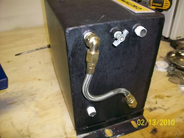

although this HX SEEMS to be in pristine condition...
i wanna pressure test it....
This thing has SIX fittings.....TWO larger ones that i presume to be coolant....and FOUR other smaller ones!
Steam Genies HX only have TWO smaller fittings(one in one out)..so you plug one and introduce air pressure on the other...if there is a leak you can hear it coming out the coolant side.....
WTF does the Butler have FOUR coolant fittings...
ANYONE?????

OK i figgered out this sucka:
it MUST be two chambered...as the right top is to the left bottom..
same with the othe side......Pressure tested this unit...i gotta say that BUTLER makes a hell of a HX......
This little Basturd child will work great on my new Genie 47................
and yes it was a real Butler
