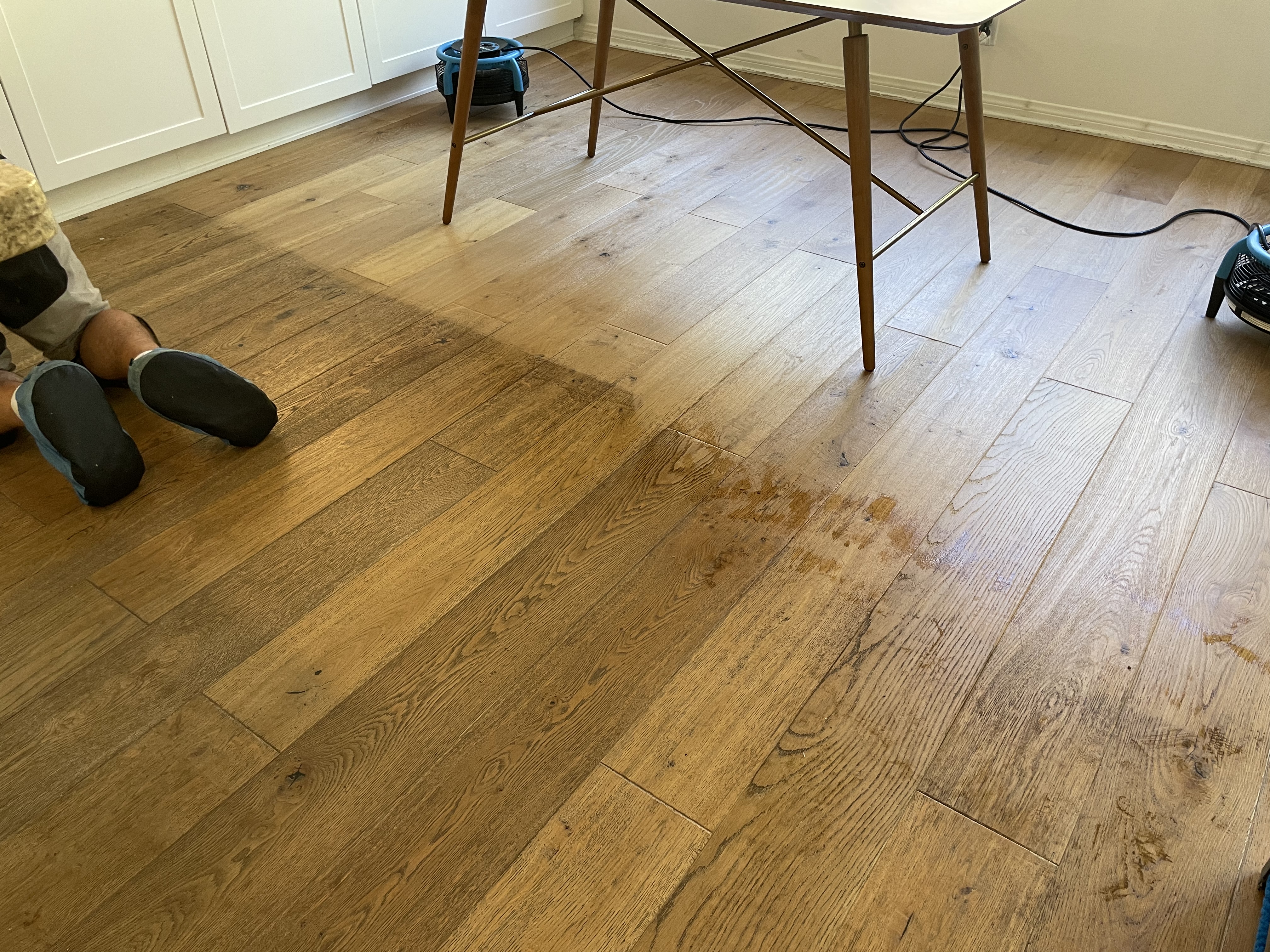

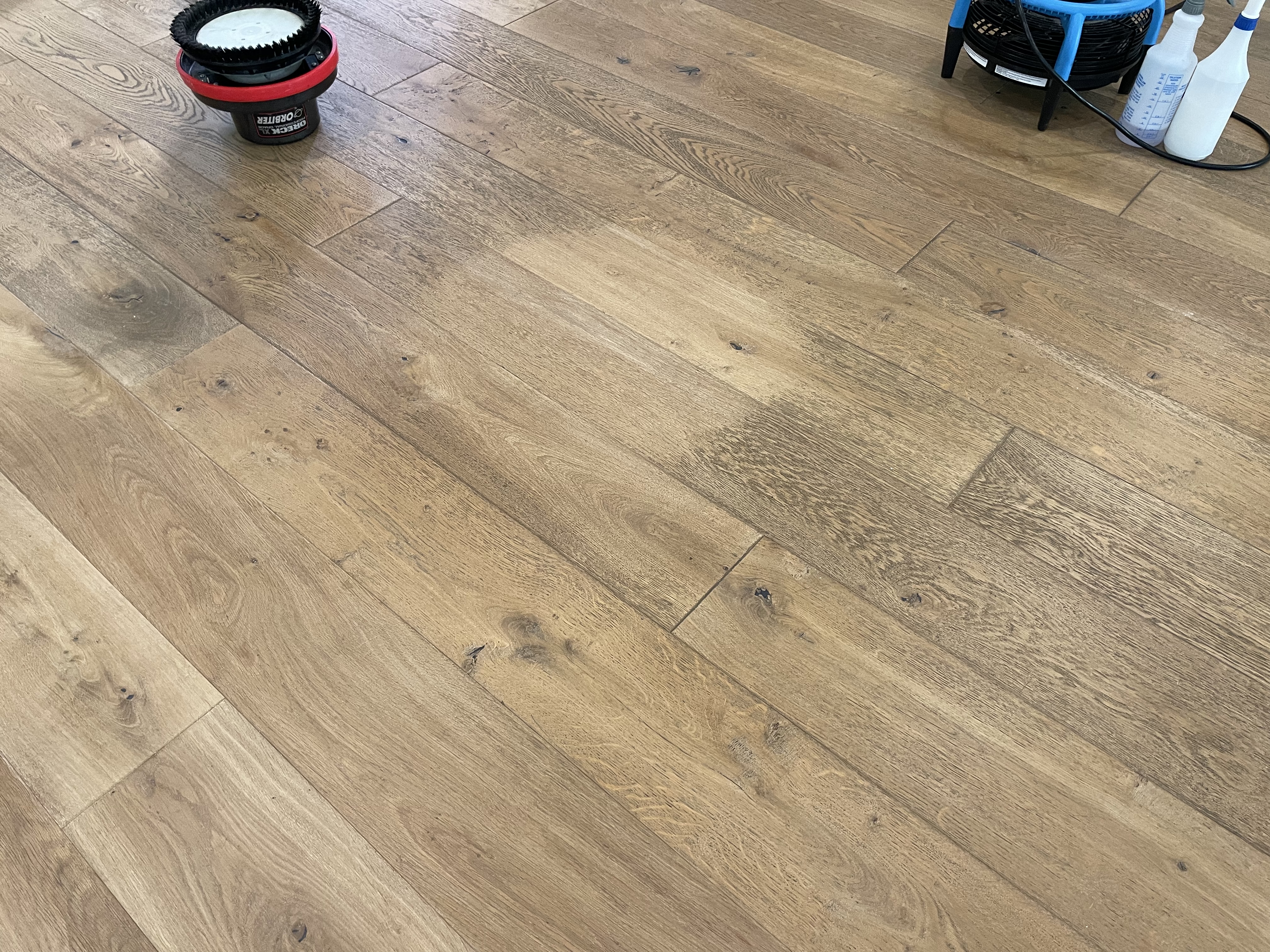

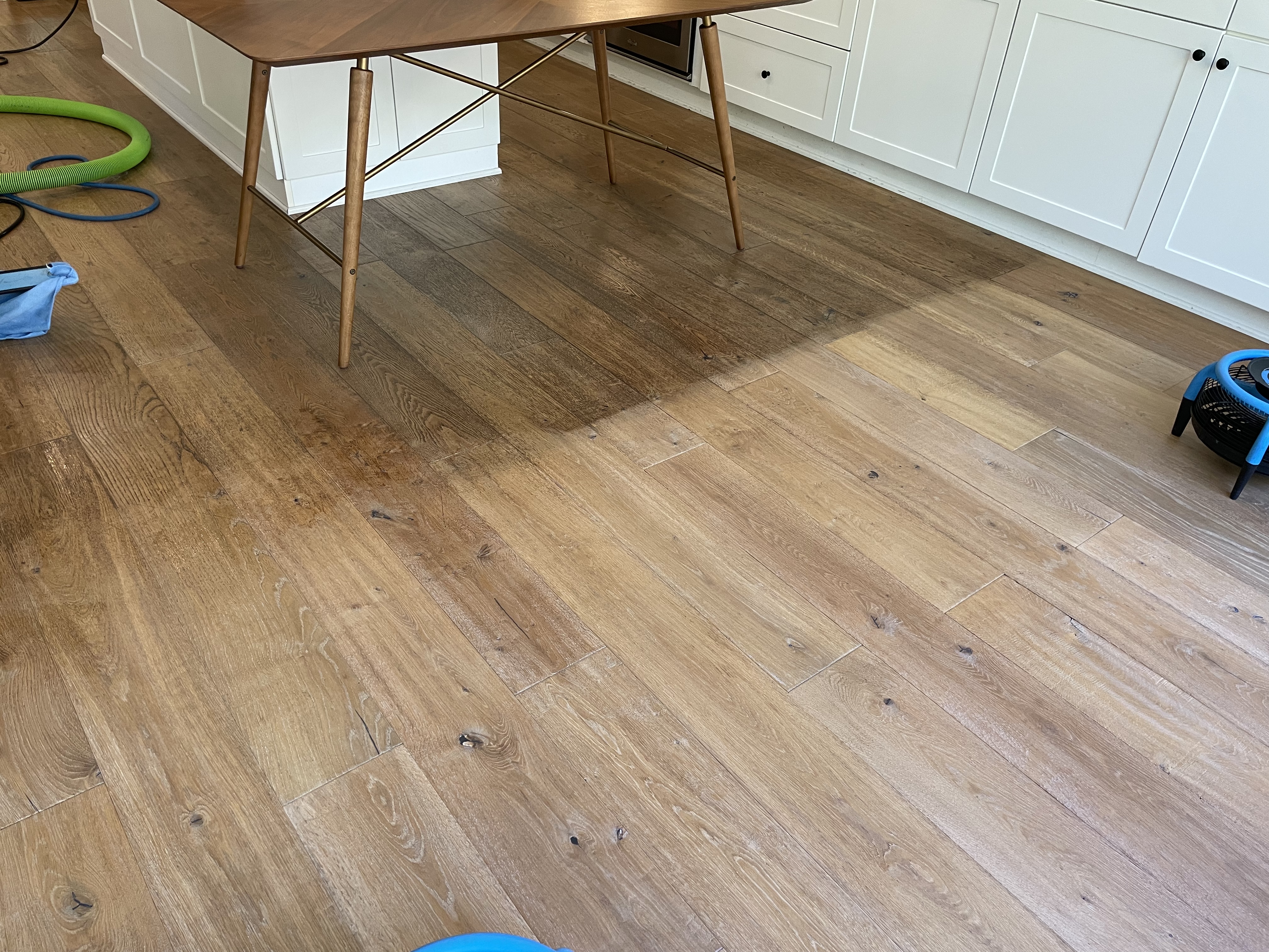

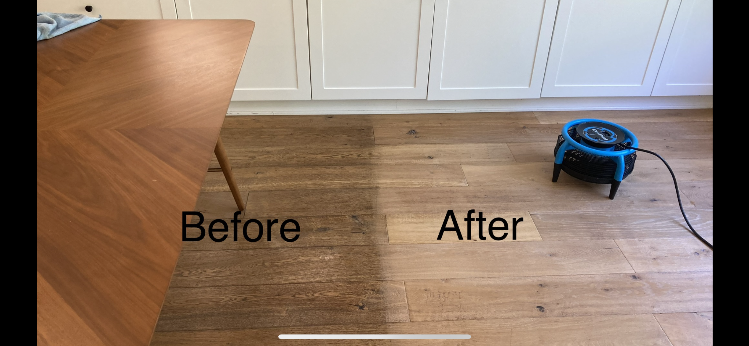

Brush Pro killed it!!
AB89C6D6-9D0F-412A-9CF1-06490710C298.jpeg F7C051AB-A9F2-4FA1-BF4F-A57D05C1E126.jpeg 44497535-E8BC-4CC1-A188-A64415B1CE58.png
encapman
2,405
Rick Gelinas
IFT is a perfect cleaner for filthy wood floors (as well as LVT / LVP). And then follow up with Squeaky. Keeping your moisture level under control is paramount for wood too, but it looks like you have that well in hand. Nice photos by the way! We started selling a few of the Basic Coatings items. Our customers love their wood care products! https://excellent-supply.com/collections/basic-coatings
