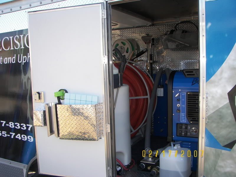

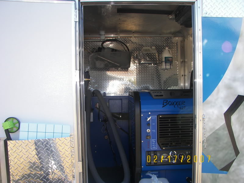

I have had the 421 and have a 427. The 427 is hotter. More suck and with the 2 ports coming off the waste tank you can use Greenies adapters to a 2.5" very easy. There is 2K difference and worth every penny.
