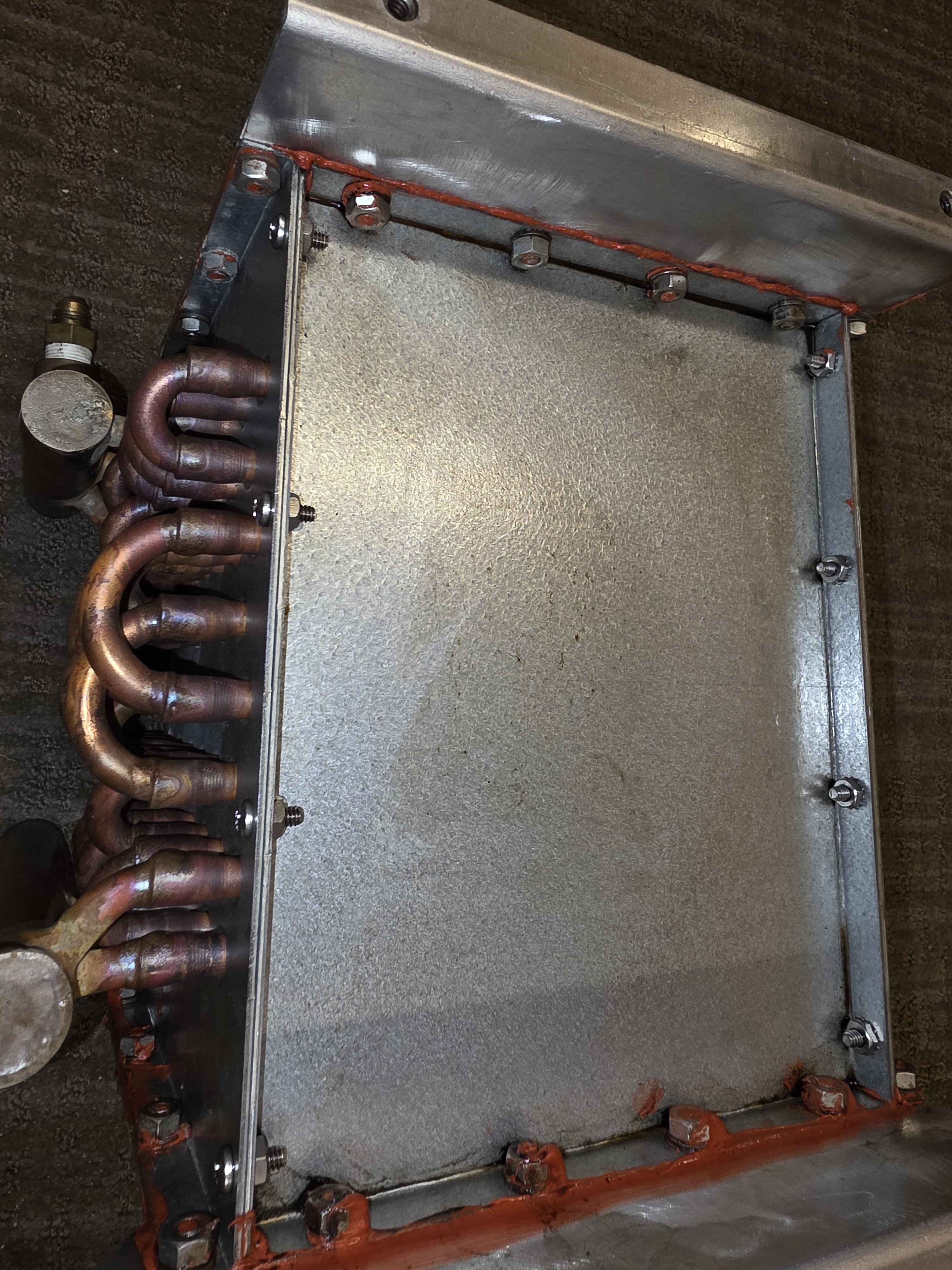

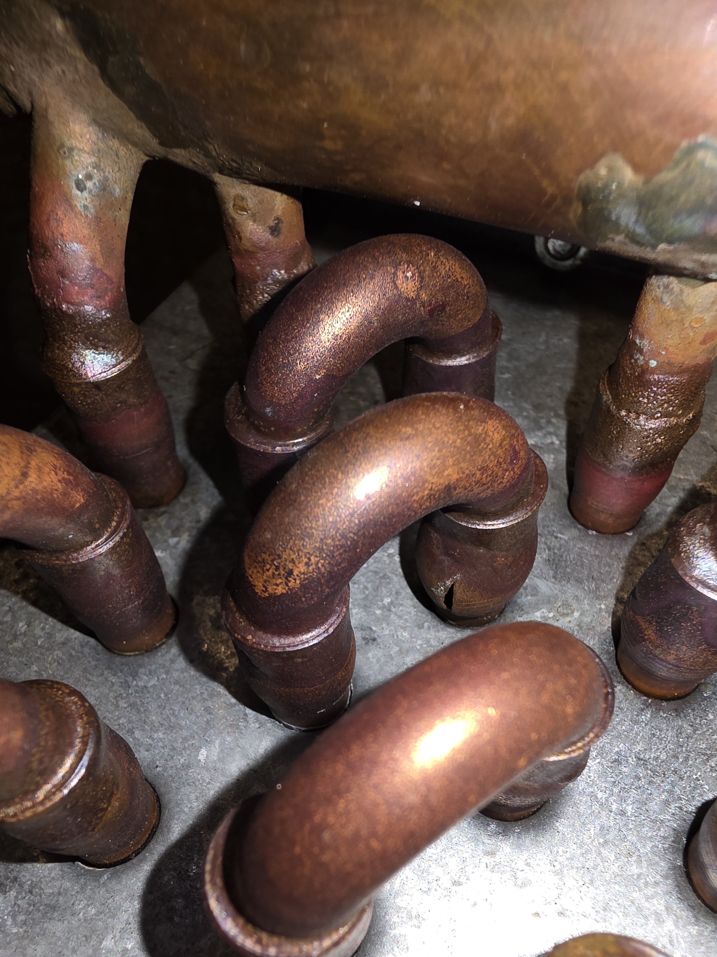

I removed the heat exchanger today. Right now I see one burst fitting on the flared socket that slips over the elbow. Fingers crossed that there's nothing internal.
For you guys that have pulled your heat exchanger, are you reapplying the RTV sealant? 20260401_202301.jpg20260401_201807.jpg20260401_201215.jpg

Take it to a radiator shop. They "should" be able to fix that. If not, they'll bypass those tubes. As new as that RTV looks, the previous owner has obviously taken it apart and hopefully cleaned everything. I'd do it anyway, soak it in degreaser or your favorite special sauce. Heck, the radiator guy may even do that. Definitely either order the gaskets or use RTV after scraping it clean.

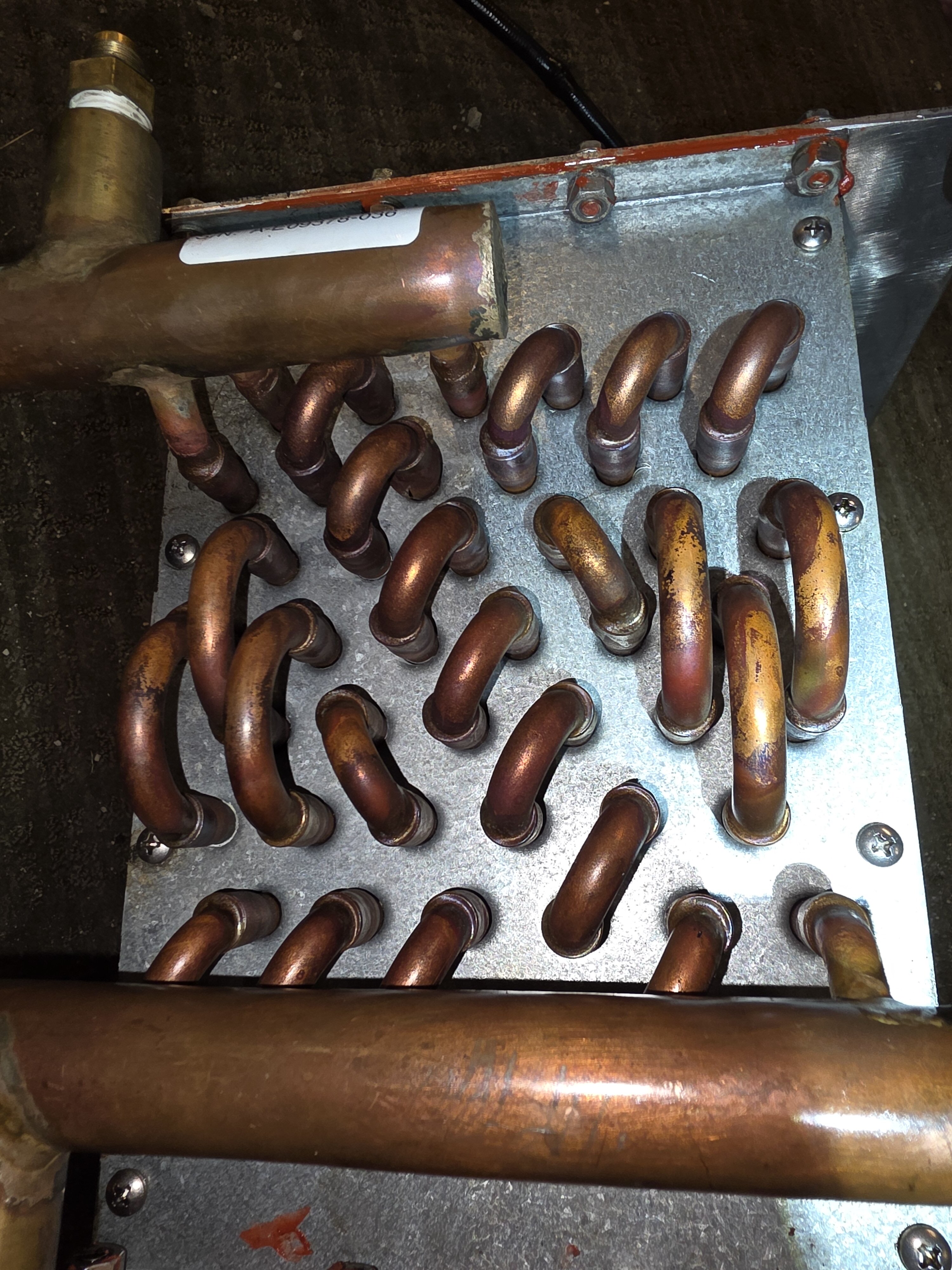

The outside can look super clean, but the inside... These are old pictures,sorry for the low quality.

I was tempted to repair it myself. I actually went to college for welding and was a welder for about 5 years, but I decided that this wasn't a good project to try and remember my old skills, and brazing with silver filler rod wasn't something I did on the regular.

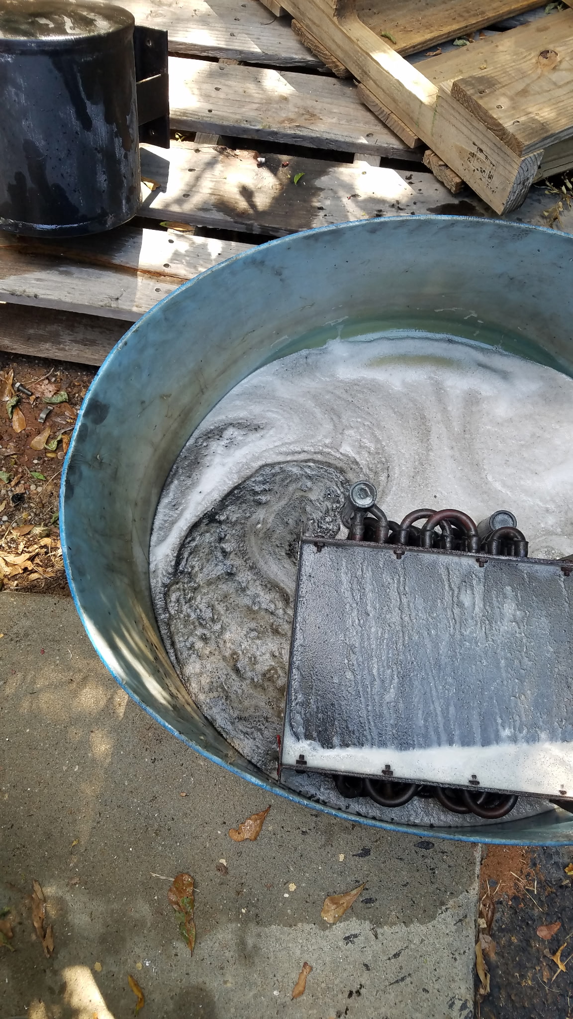

I took the heat exchanger apart last night and sprayed it down with Dawn Power Wash and gave it a good rinse and soak. I was surprised at what I got out of it for being such low hours.
Glorified lawn mowers in a van, they get nasty quick. Cleaner heat exchanger will give a lot more heat too. Can't wait to see the ol' girl out cleaning carpet again.
