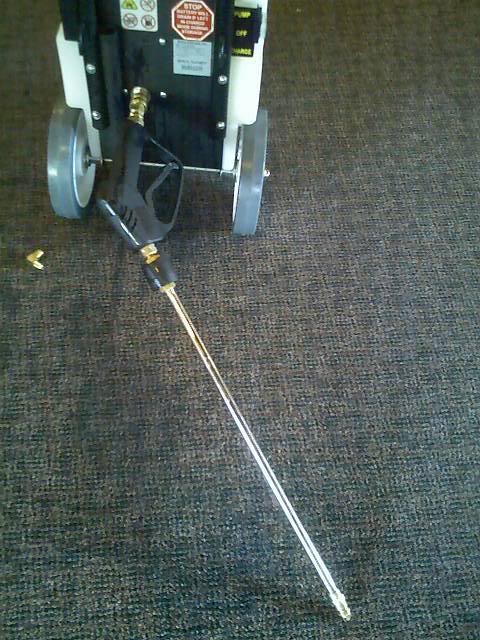

BOSS hose was mytee clogged..
116,048
No idea what was in there after only 3 jobs but I had to get resourceful to get the job done...
Actually I hooked the new 1/4 coil hose up to the Vortex and blew it the * out but that is one funny option..

same here mikey release the trigger and it would keep spraying got her fixed boy does that thing put out the juice
116,048
I think the problem maybe the new 1/th hose they swapped form the 3/8ths.
If you run the pump dry there is not enough airflow to suck new juice.

A Tee jet with filter in the tip would make that all an afterthought. Then you could have a filter/checkvalve and not have any drips either.
Wouldn't be able to use your sexy wand silo though, would need a bigger tube.
