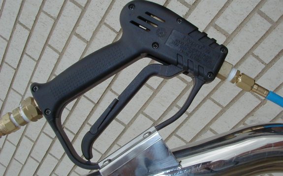

Wand Valve Photo
I would change a couple of things on this wand:
1. Attach the valve at a stronger section of plastic.
2. Increase the size of the line from the valve to the jet bar for less pressure loss.
(Compare the 1/4" QC to the crimp on the hose).

Scott Rogers
1,033
I actually left one with him to model, but he never made a proto type. It is actually the famous Stanley Steemer 14" 4 jet 2" wand.
Greenie
6,820
I call it the Paul Bunyon, cause you use it like a cross cut saw, it's no "finesse" tool that is for sure.
