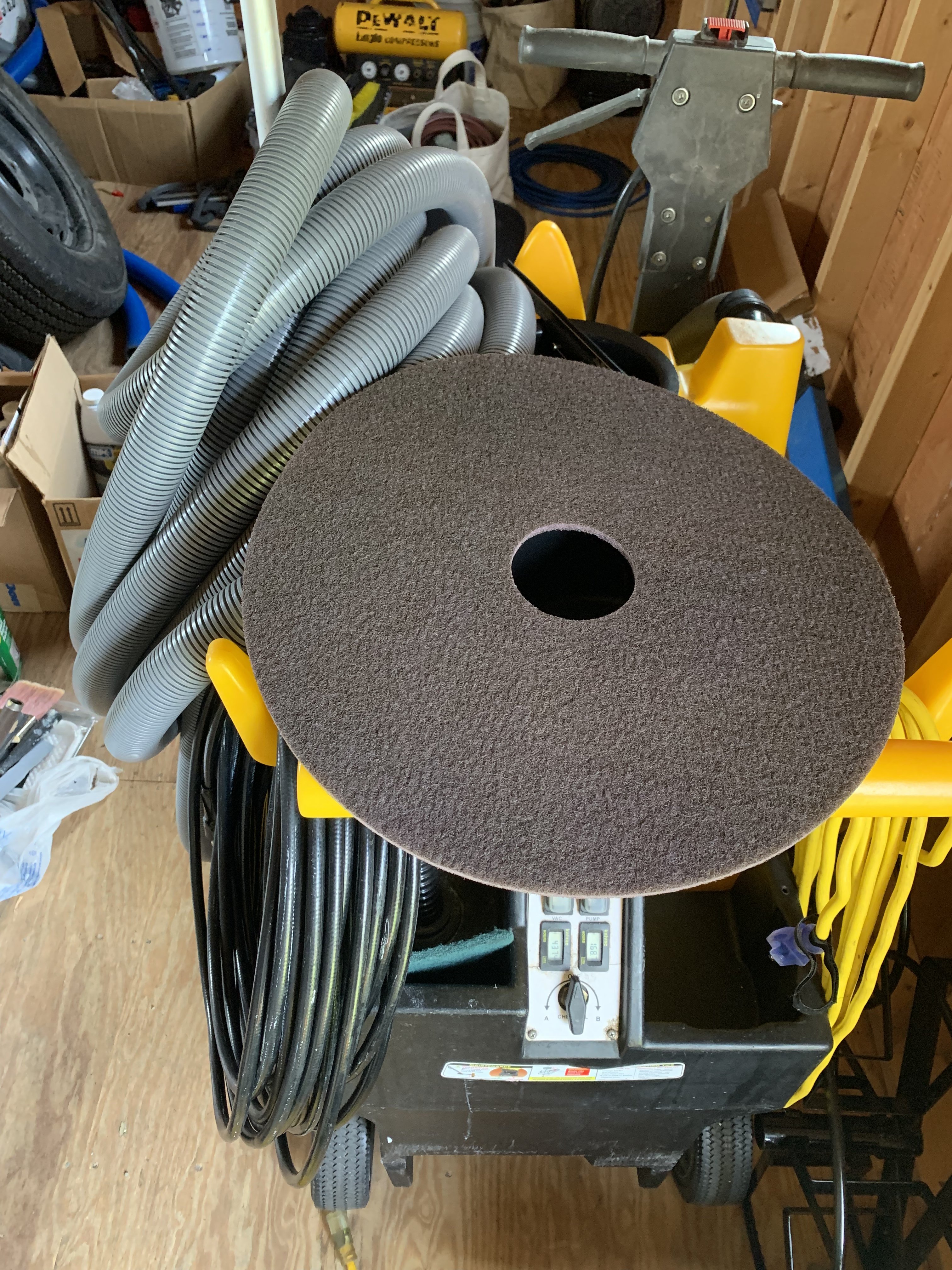

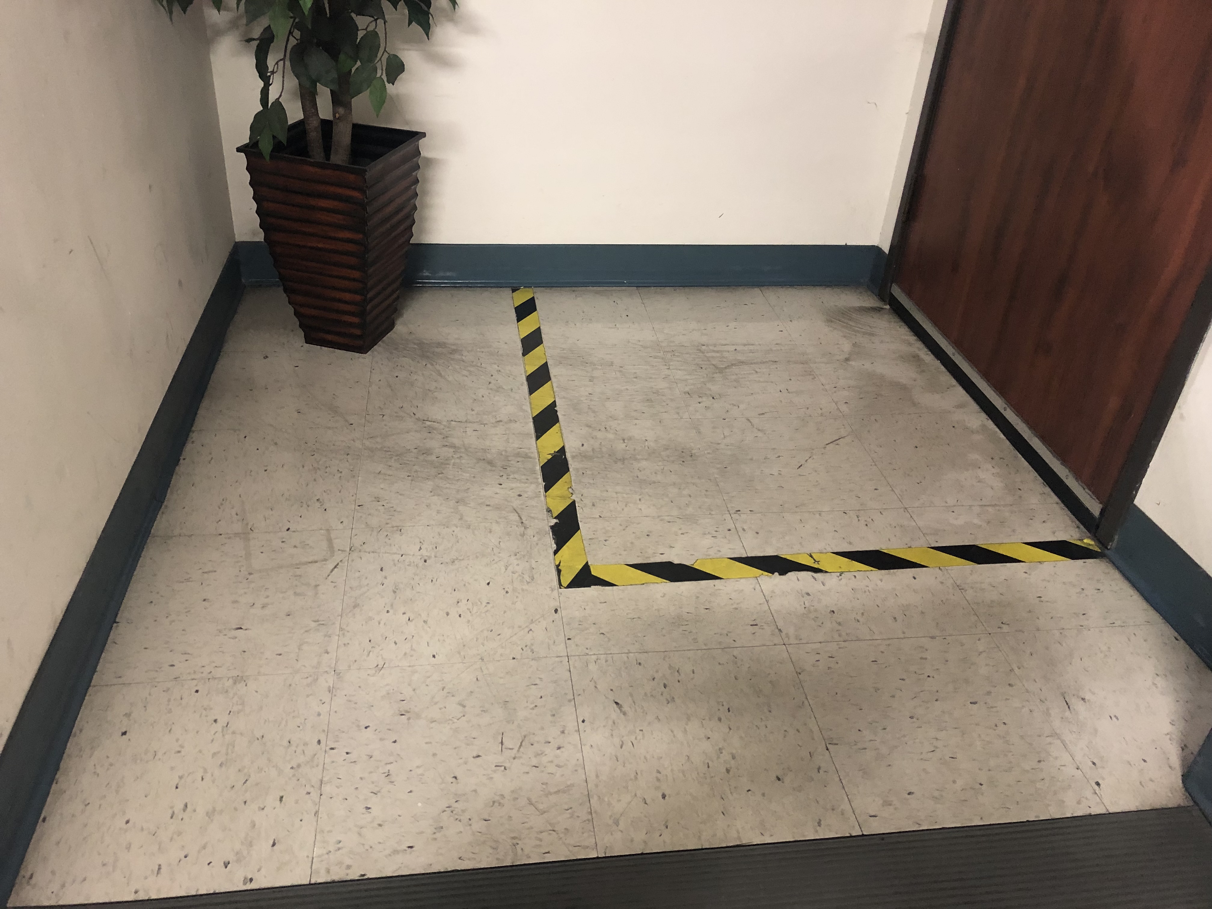

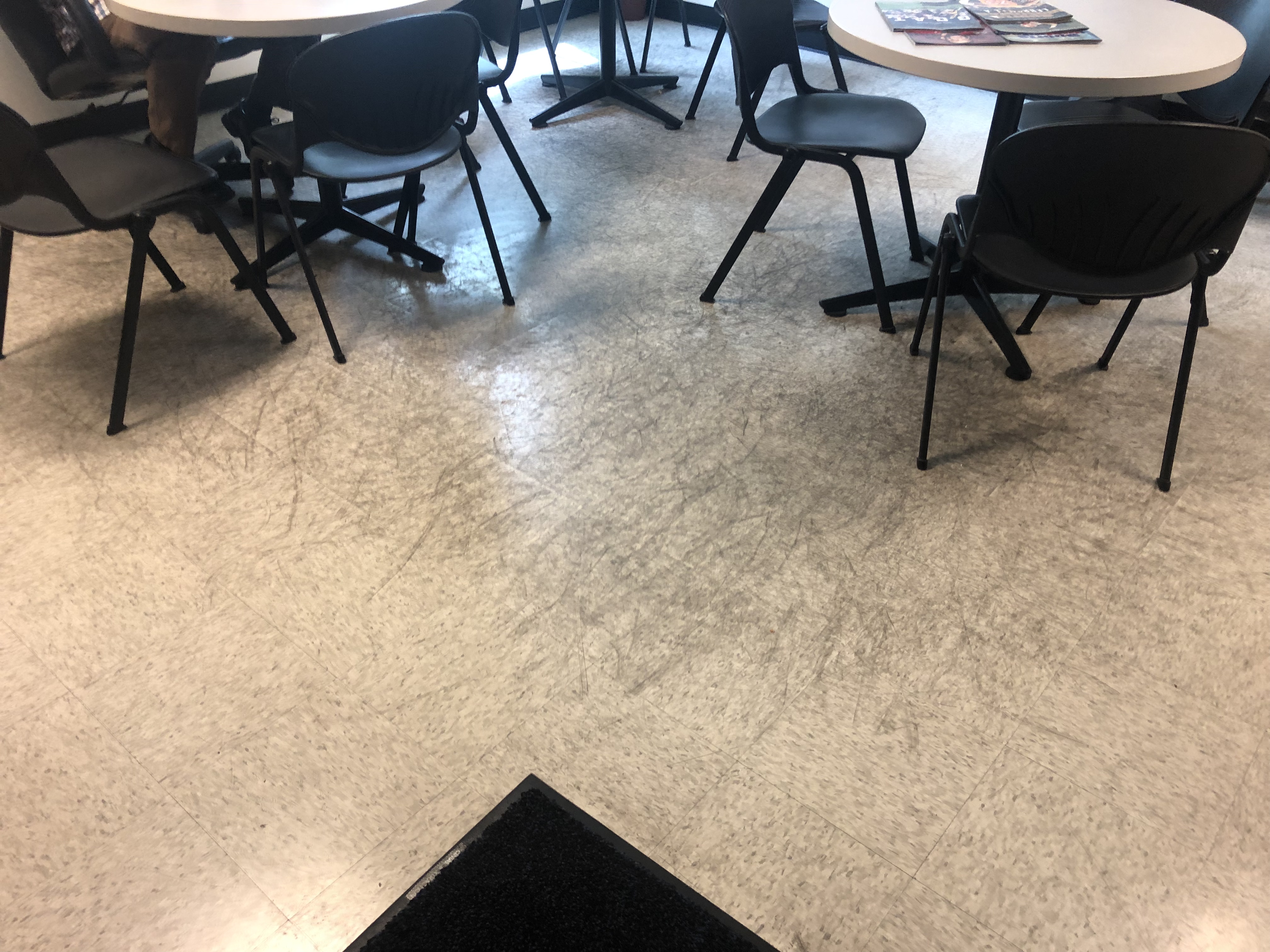

I have an account that I don’t want to loose so I said I could do the vct in the break room
I explained that it is damages and wouldn’t look great but it would look better they liked that and said we just want it to be cleaned whatever it is it’s fine
I’ve never done this before how would I do a simple and good job?

If you have 175 or OP get a 3m 5000 or equivalent pad
mop on a neutral emulsifier detergent
give it some dwell time then scrub with pad
extract and rinse slurry or mop it clean (clean water not detergent)
work in sections so it doesnt dry on ya
