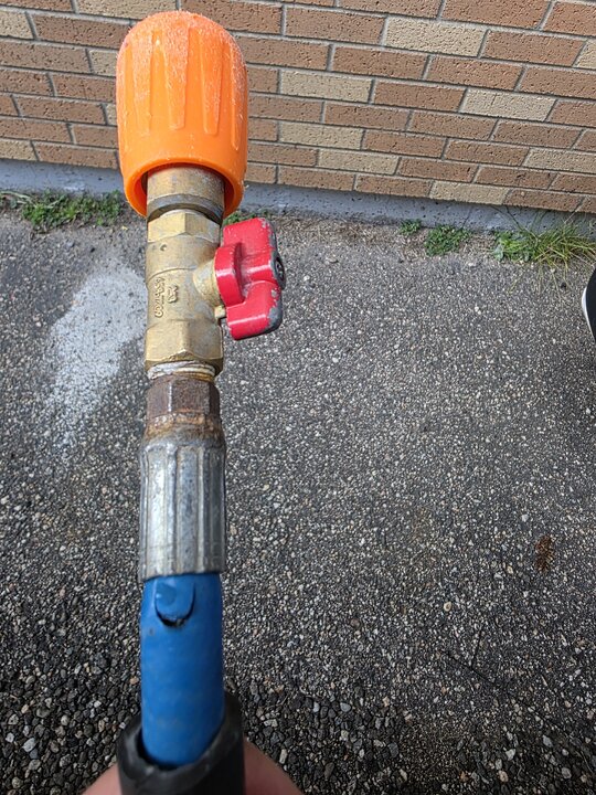

What is the best solution line these days? I'm not worried about cost. I just want something with the least amount of memory, doesn't bleed on the carpet, and can take high heat.
Friday I was doing a post construction clean at a historical building that was being remodeled and my line blew right at my QC on/off valve. I'm glad I wasn't using high heat because it sprayed me right in the face, which was still actually pretty dang hot.
