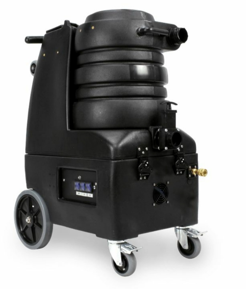

Rick Gelinas
500 psi adjustable, heat,
and 200 inches of waterlift...
Bang for the buck!

:headscratch: All Those features AND Heated with only 1 or 2 cords if heated, and 89 lbs!--
How is that possible!? I'm susceptible but interested.
do you have the 500 psi model/ dual 3 stage model?
