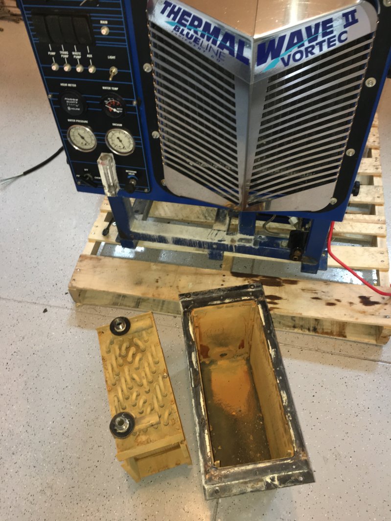

Lets talk about cutting corners. Here is a blue line thermalwave 2. Instead of building an aluminum Box to hold the coolant HX, they used steel. In mass production this aluminum box would have been cheap to make. Take a look at it. The HX is coverved in rust from the box deteriorating. All this rust has been pumping through the water pump day in and day out. IMO, they do this for 2 reasons, to make an extra buck of profit and because they dgas how your machine is holding up 5-6 years down the road. They want you to purchase another one. And of course the waste tank is aluminum.

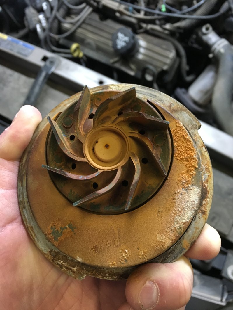

I put 18k hrs on that coolant hx with no problems. Engines have been made from cast iron for ever. The thing about antifreeze is the properties that stop it from freezing never go away. The anti rust properties however degrade with time. Most guys don't change it the way they should. By the way the rusty water is only going through the engine.

Lets talk about cutting corners. Here is a blue line thermalwave 2. Instead of building an aluminum Box to hold the coolant HX, they used steel. In mass production this aluminum box would have been cheap to make. Take a look at it. The HX is coverved in rust from the box deteriorating. All this rust has been pumping through the water pump day in and day out. IMO, they do this for 2 reasons, to make an extra buck of profit and because they dgas how your machine is holding up 5-6 years down the road. They want you to purchase another one. And of course the waste tank is aluminum.View attachment 9088

as far as heat exchangers go, its better its made of steel then aluminum. descaling will remove a fair bit of rust if done often and properly. if your in a hard water area your should decale often, like every 3-6 months depending upon hardness, if your in a softer water area at least once a year.
descaling will remove some rust, but not years of neglect. if done often and properly it will keep you heat exchanges working at peak temps and reduce the amount of scale you find.. heating the water to high temps actually promotes scale, so decale often and neutralize once your done.

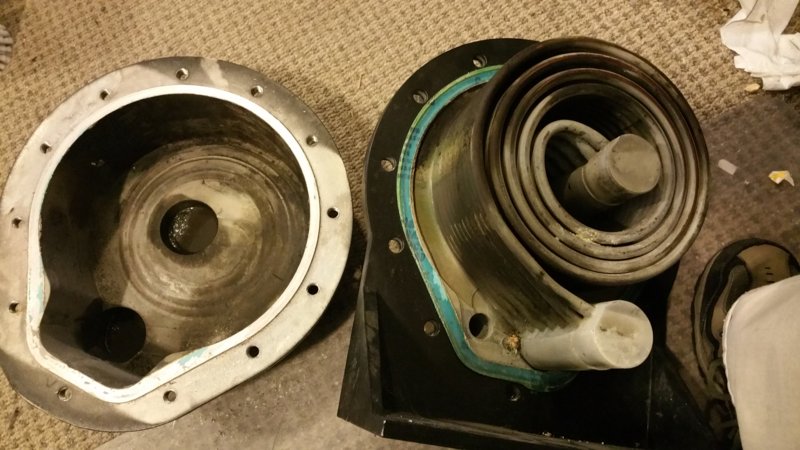

I had to replace mine when it sprung a leak, what an unbelievable PIA to get it out in the first place.

The copper chaffed inside against the coil plate that kept them in line
