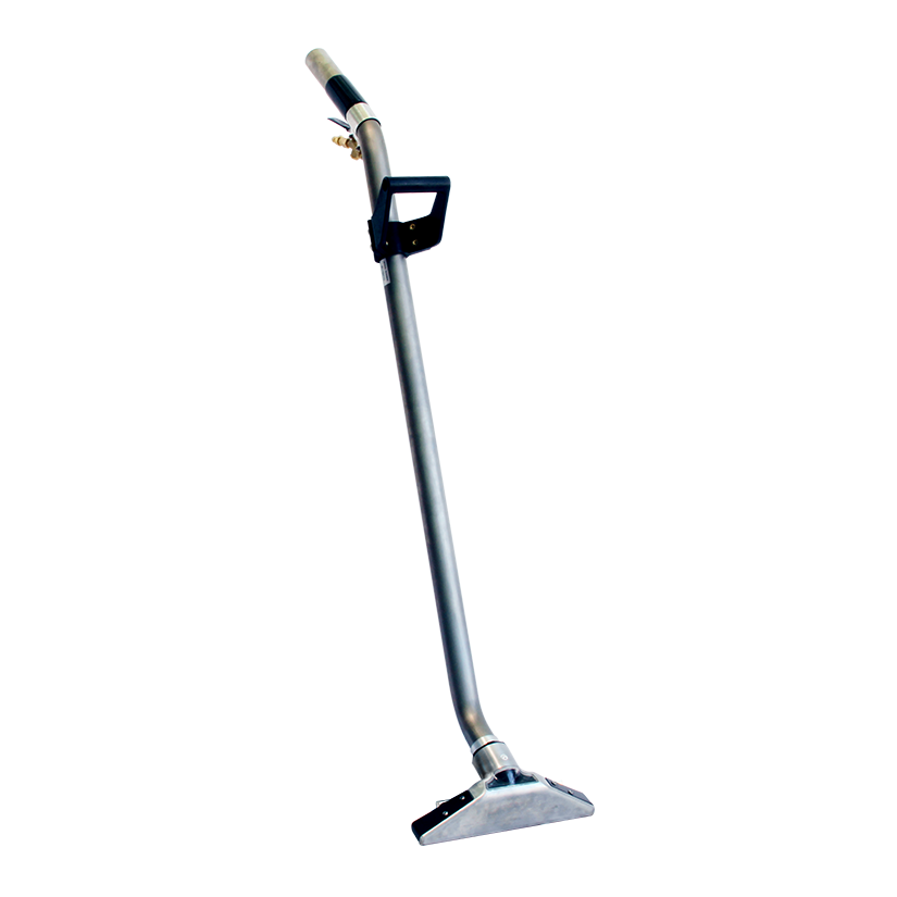

Hey i have a guy having a issue using the reducer coupler to shorten his Bentley Swivel Wand. They have tried what Mytee said with silicone and also 2 part epoxy but neither one was strong enough to hold together. Any ideas what might work best? Does anyone have experience cutting down their Bentley they could share? We are gonna keep work on figuring out a solution but any help would be great. Thanks

I assume carbon fiber
after sanding any good epoxy/fiberglass resin should work
nope..
Find someone who can weld Titanium in your area
Reactions: Sethd and FB19087
oh..then yeah welding
but the epoxy and a sleeve could still work. Would likely need to roughen/etch the titanium and use a good epoxy like Hysol 9359.3

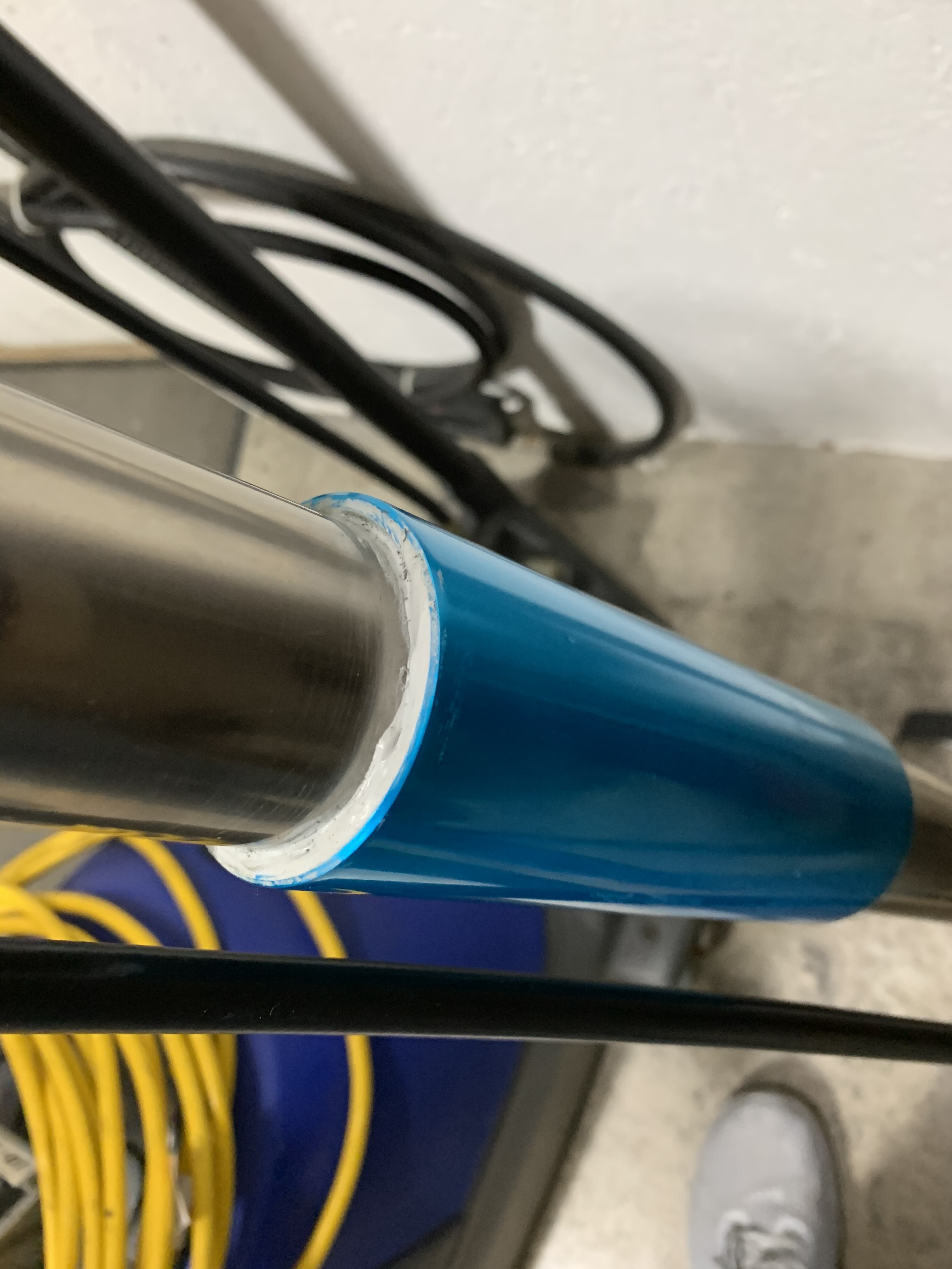

(update) Got the wand back last week. Rasped the metal down and cleaned with alcohol. Used Bostic 1100FS Poly. Customer picked up the wand and has done a few jobs and said it seems to be much better. I dont think it will ever feel like it did with the reducer cuff supplied being slightly to large of a diameter to make it feel secure but this is the best we could do outside of having it welded. Made sure not to put the poly in the cuff when installing it back on the wand. Instead applied it to the wand metal itself as we pressed it into the cuff so no poly will be poking out inside the vac tube where debris could catch onto it.

Yeah it was hard to get everything to sit where it needed to for the bostic to hold with the cuff being to big. I used a vice and painters tape for a few hours to hold everything in the right position. I would never for 1 have bought this wand or cut it for that matter.
