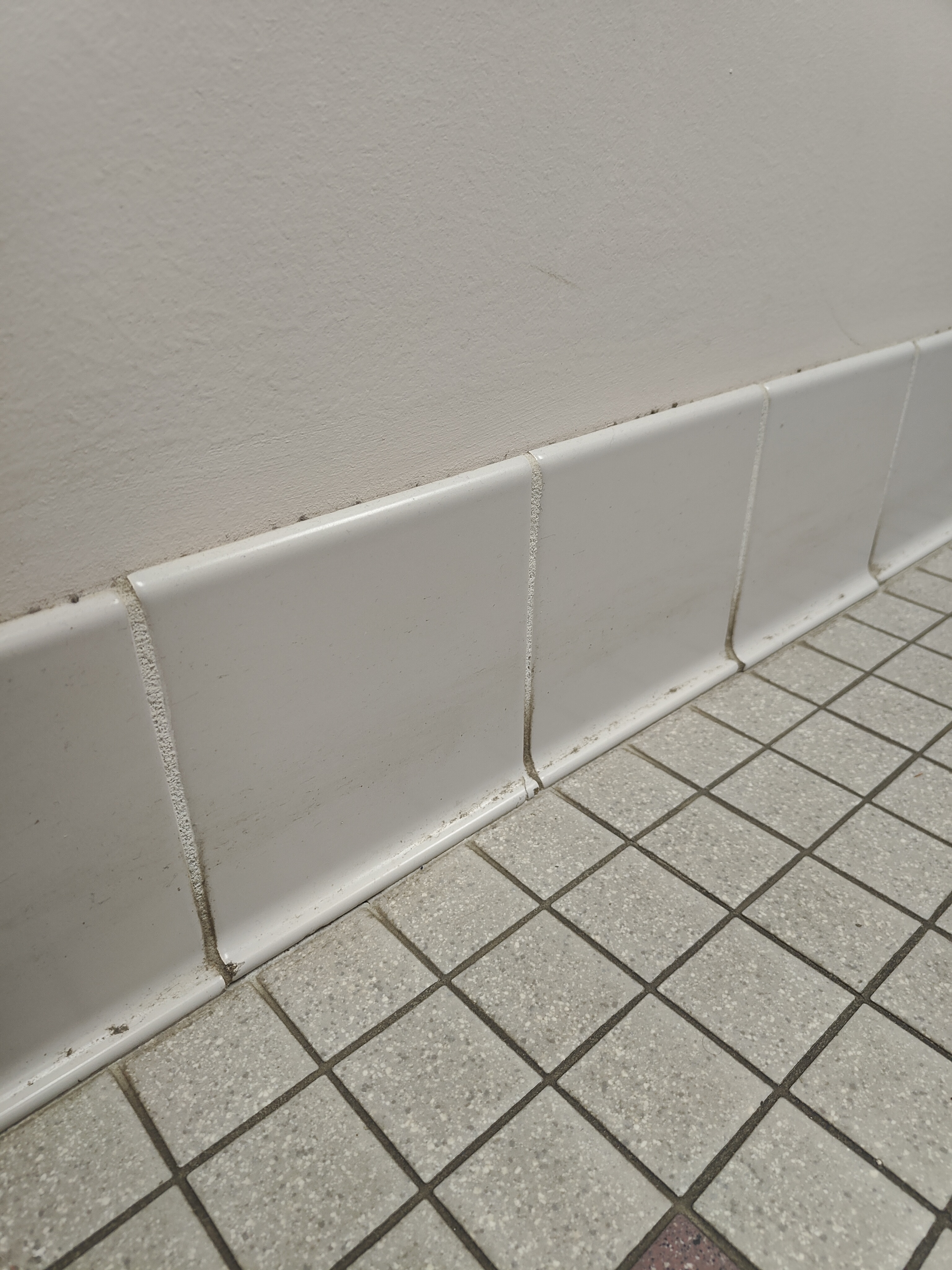

I have this restroom in an office that it is difficult to get the truck back to because of its location, this tile was installed 23 years ago and is simply maintained by wet mopping and using a little bleach in the water from time to time.
A couple picky girls, women in this lady's room want the floor cleaned but multi-surface cleaners other cleaners that we tried require a hell of a lot of scrubbing only for it to get dirty again fast. It's the nature of this business.
So from years of having this janitorial account I know what works and what doesn't and a toilet bowl cleaner containing 23% heavy-duty hydrochloric acid kicked ass, strong smell requires a lot of neutralizing.
Anyone have a recommendation on something that could be sprayed down lightly scrub to make it work and look better?

Are they mopping in-between cleaning that build up yikes.

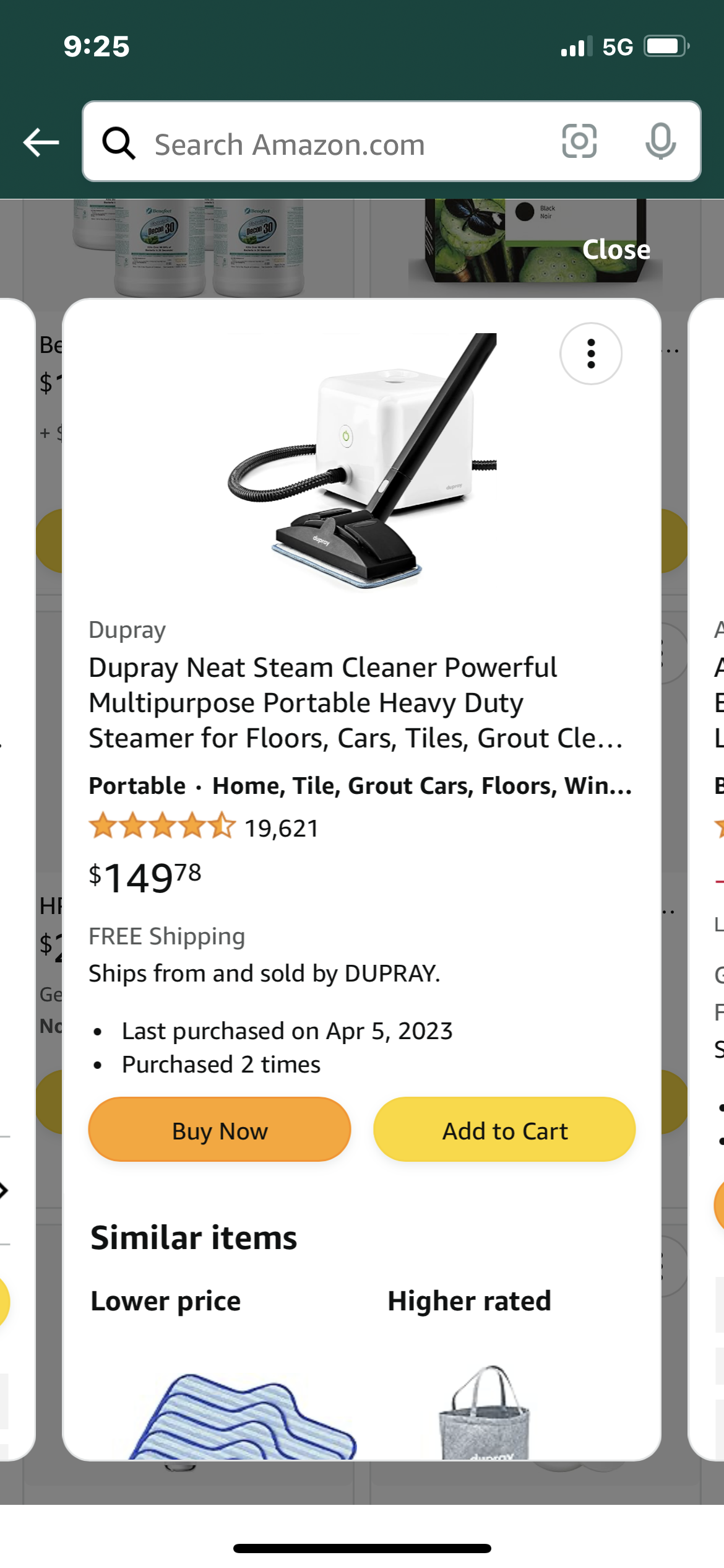

Don’t let the head shown in the picture cause you to have a case of carpet cleaner stupidity. It comes with different attachments.
