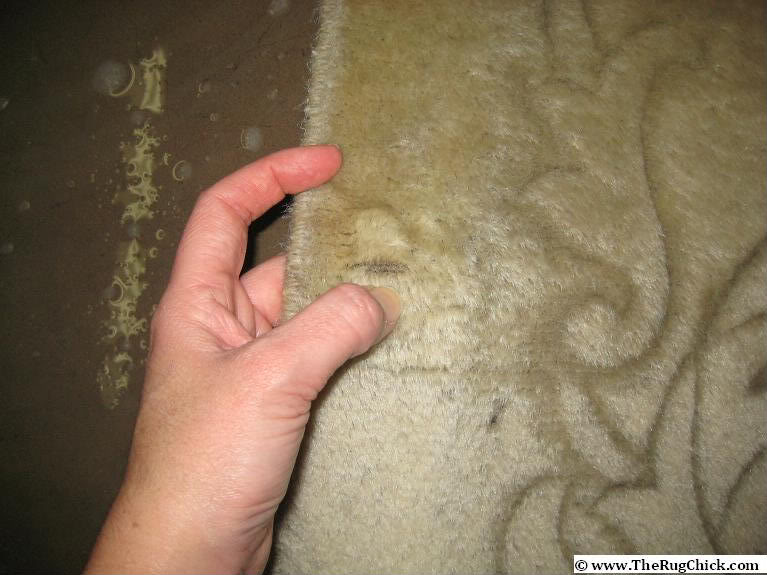

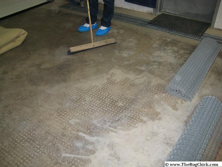

Here was one of the rugs we washed - a Chinese rug that had strong GRAY areas in the field. We dusted it with the Badger and got pounds of soil out of this puppy. Tested it side by side with an upright vacuum, and the Badger out beat it hands down.
We washed the rug thoroughly - using rug shampoo, a Cimex scrubbing, and rinsed to see the results. But those gray areas as you can see, had heavily impacted soil in those base fibers.
A couple points regarding this:
1) ANY dusting method, even as aggressive as the Badger, canNOT remove soil that has been attached to the fibers with past cleaning residue. All dusting methods remove DRY soil, not greasy, ground-in soil.
2) This is the biggest danger with rugs being cleaning in the home, or in a plant, using surface cleaning methods and no thorough dusting step. That soil becomes mud, and creates hard impacted soil all along the foundation fibers that gives that gray cast to these rugs. Long term this contributes to dry rot, and in some cases strong odor problems. It also is VERY difficult to remove with standard "wool safe" chemicals and soft brushes as are on the Cimex.
I wanted to see what a standard wash process, using recommended rug approved chemicals, following a thorough dusting, would do for this rug once over.
A regular wash was not enough. Not because it was not thorough, but because this rug had not been thoroughly cleaned in the past (when we first got it wet suds came up from past residue).
Because this rug did not have dyes to potentially bleed, a few things could be done here which worked (but took time) - using an enzyme to help break up the soil, and using a stiffer broom floor brush (stiffer than the Cimex) to brush at the base of these fibers throughout the rug. Much more manual labor was required, and more aggressive chemicals, due to those past surface cleaning efforts. So the second wash created a much cleaner rug. If this rug had dyes not colorfast, we would not have been able to spend as much time as we did on this one.
