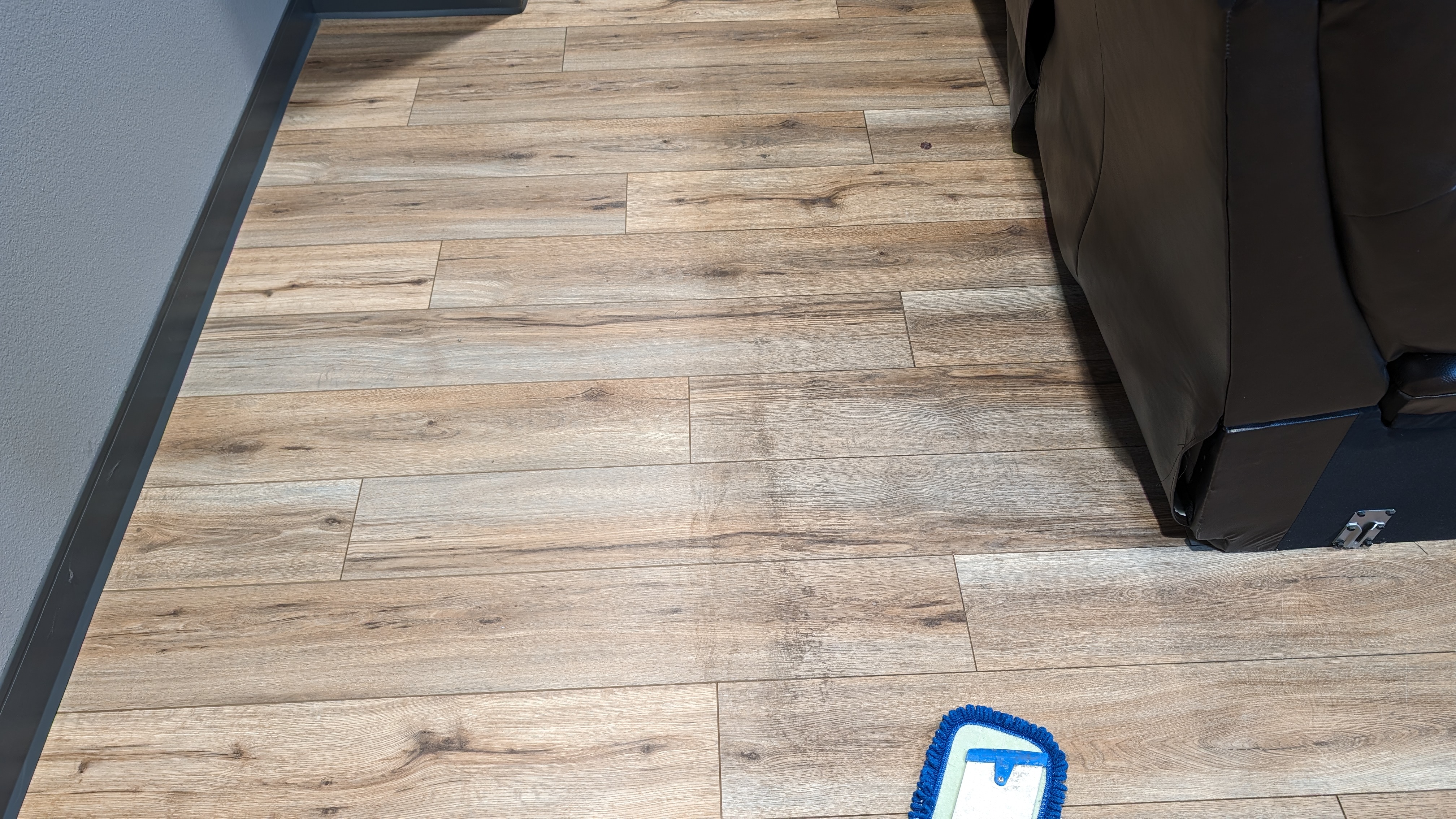

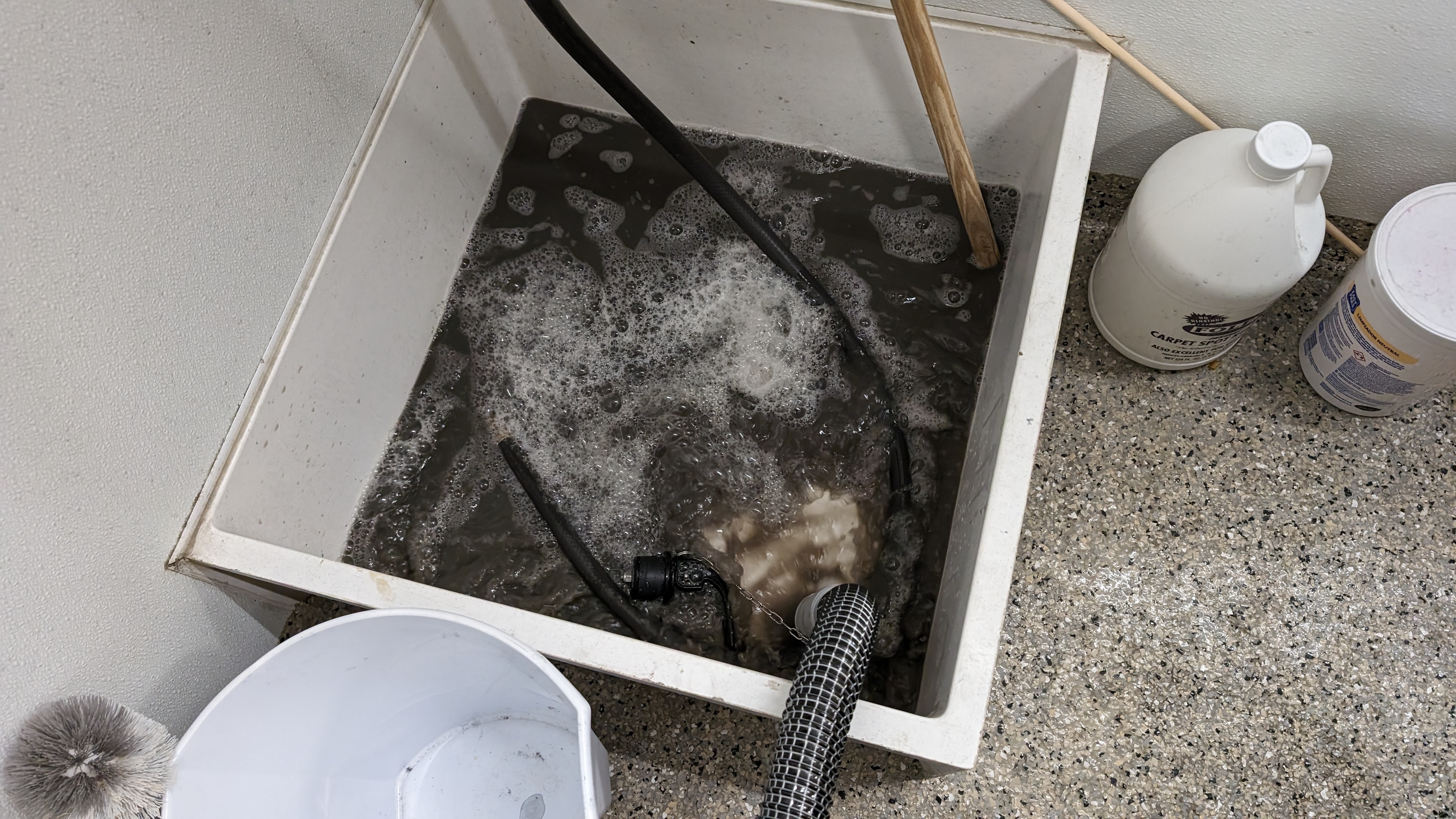

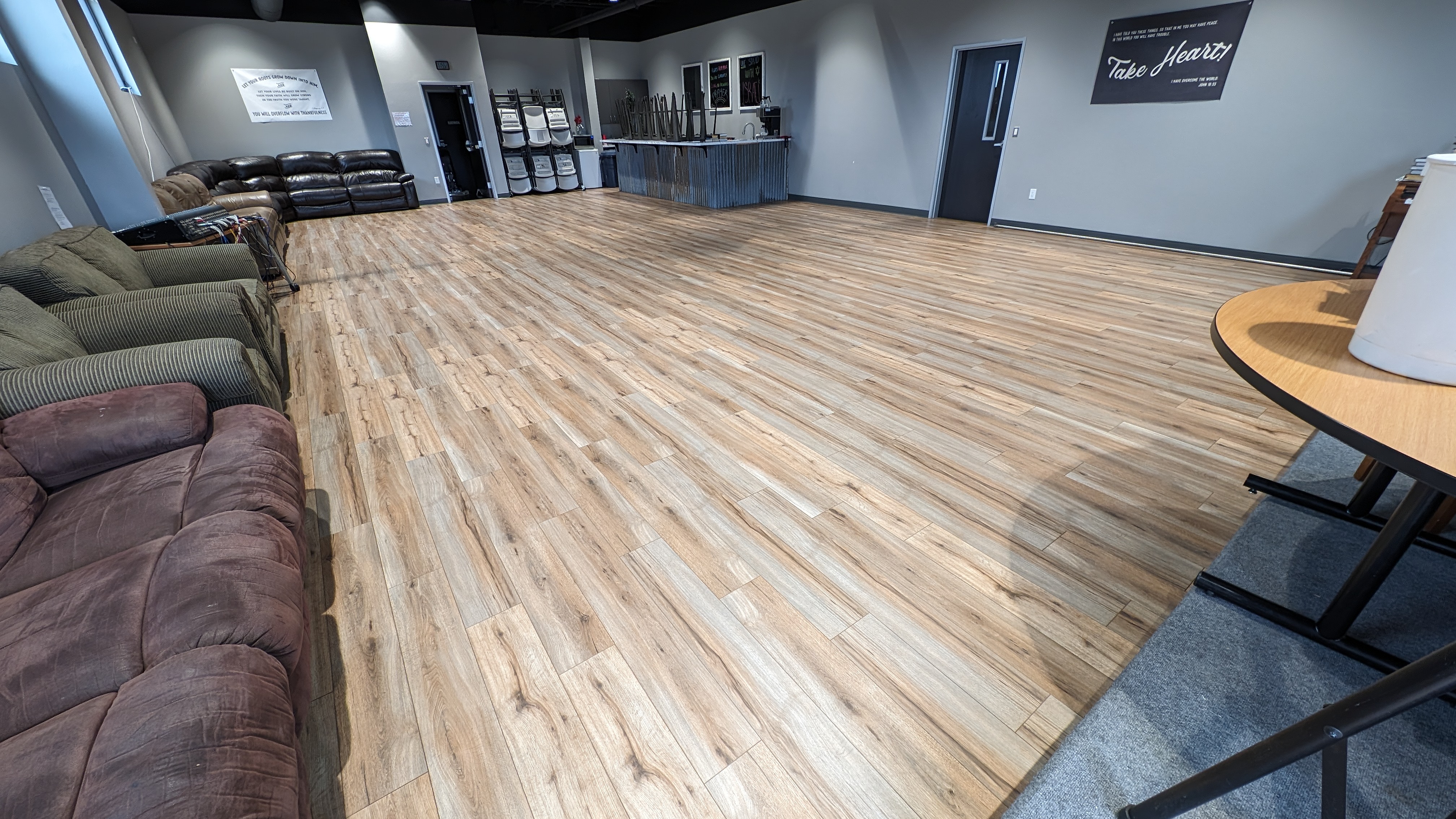

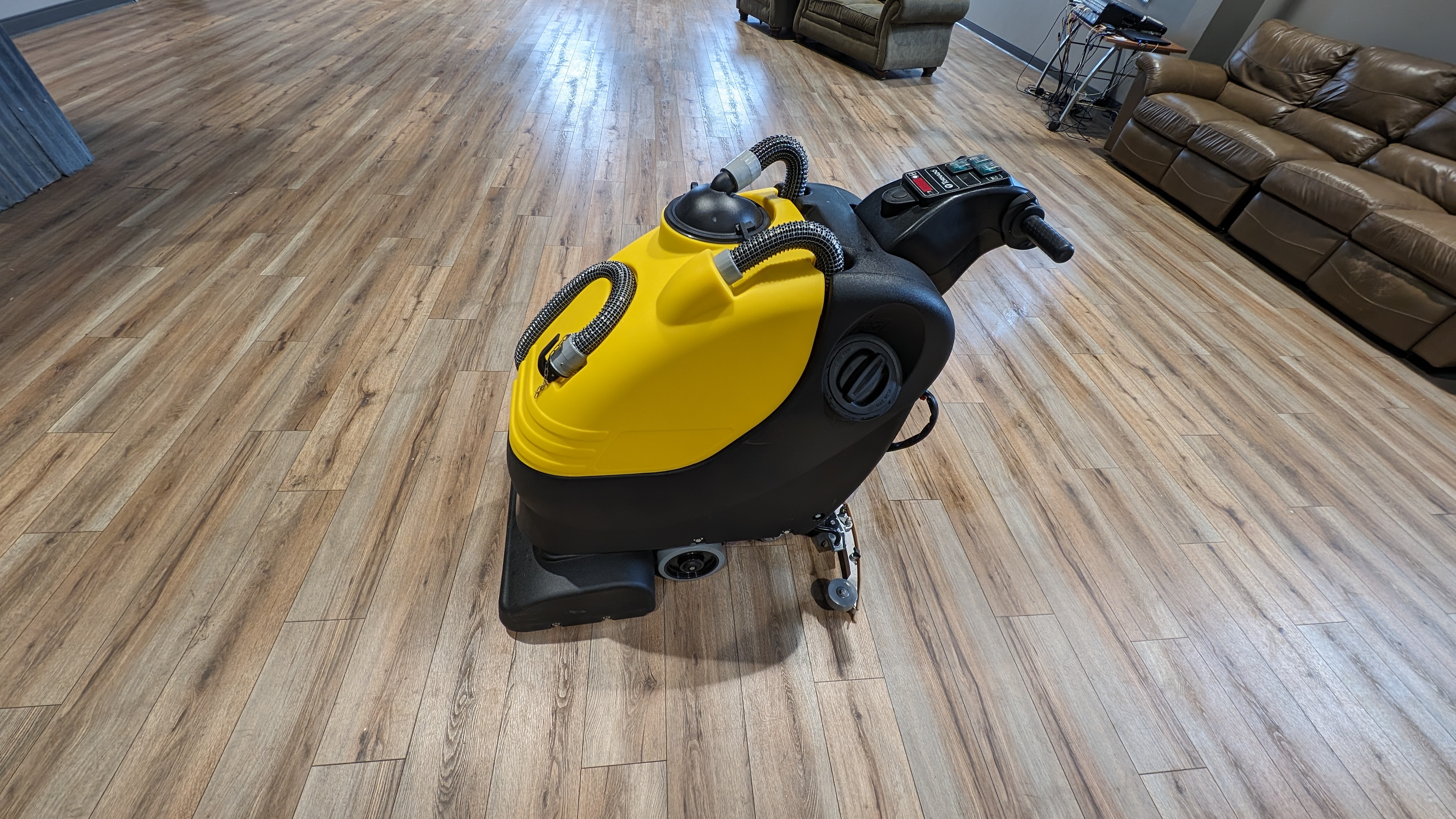

This LVP floor at my church could have been "wanded" but I chose to try their walk behind for the sake of evaluating the process.
Edges, nooks, around furniture, corners all needed cleaning by hand and the whole project took PXL_20240122_175642256.jpgPXL_20240122_182712987.jpgPXL_20240122_195553106.jpgtwice as long as I if had used my truck out and HS wand..
But as you can see, it worked well when I pre-moped an area with a heavy alkaline.. PXL_20240122_200547804.jpg

You need more practice! A foot on your mop will get the corners just fine. Along the edges as well if needed. Your scrubber looks to be a cylindrical brush model as well. They usually don’t have the head pressure to do as well as regular auto scrubber.
Edges, nooks, around furniture, corners all needed cleaning by hand and the whole project took View attachment 125913View attachment 125914View attachment 125915twice as long as I if had used my truck out and HS wand..
But as you can see, it worked well when I pre-moped an area with a heavy alkaline.. View attachment 125916

No, it’s true for a deeper scrub. It would be like stripping a floor. The only prob with that machine is the cylindrical brushes don’t do as well on an auto scrubber. Not enough head pressure. But, that person is correct.
