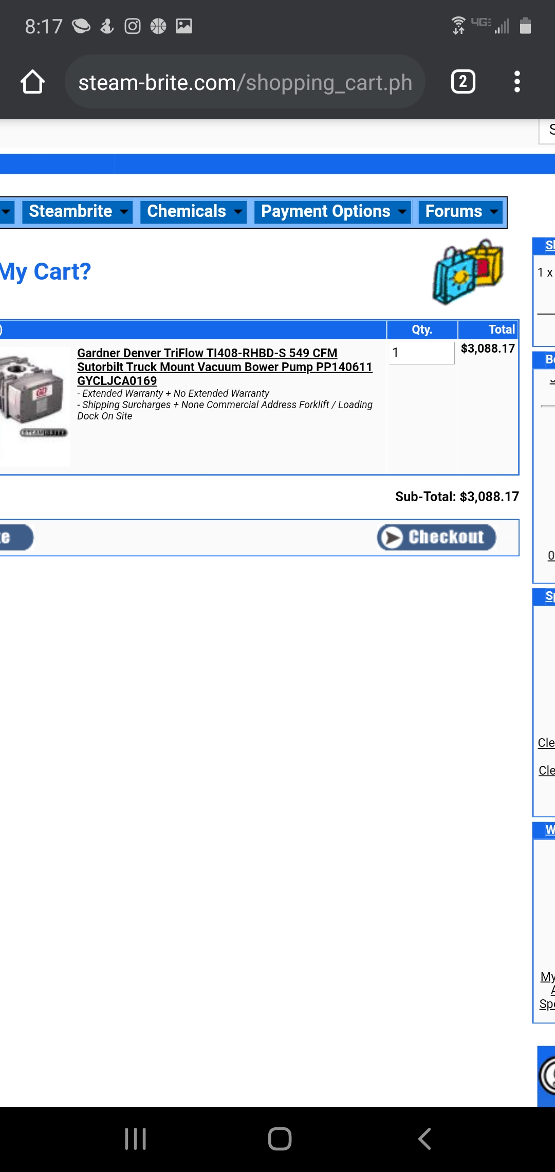

It's a 4.8 blower trilobe or tri flow
11,336
California
https://www.***************/gardner...-bower-pump-pp140611-gycljca0169-p-12461.html
