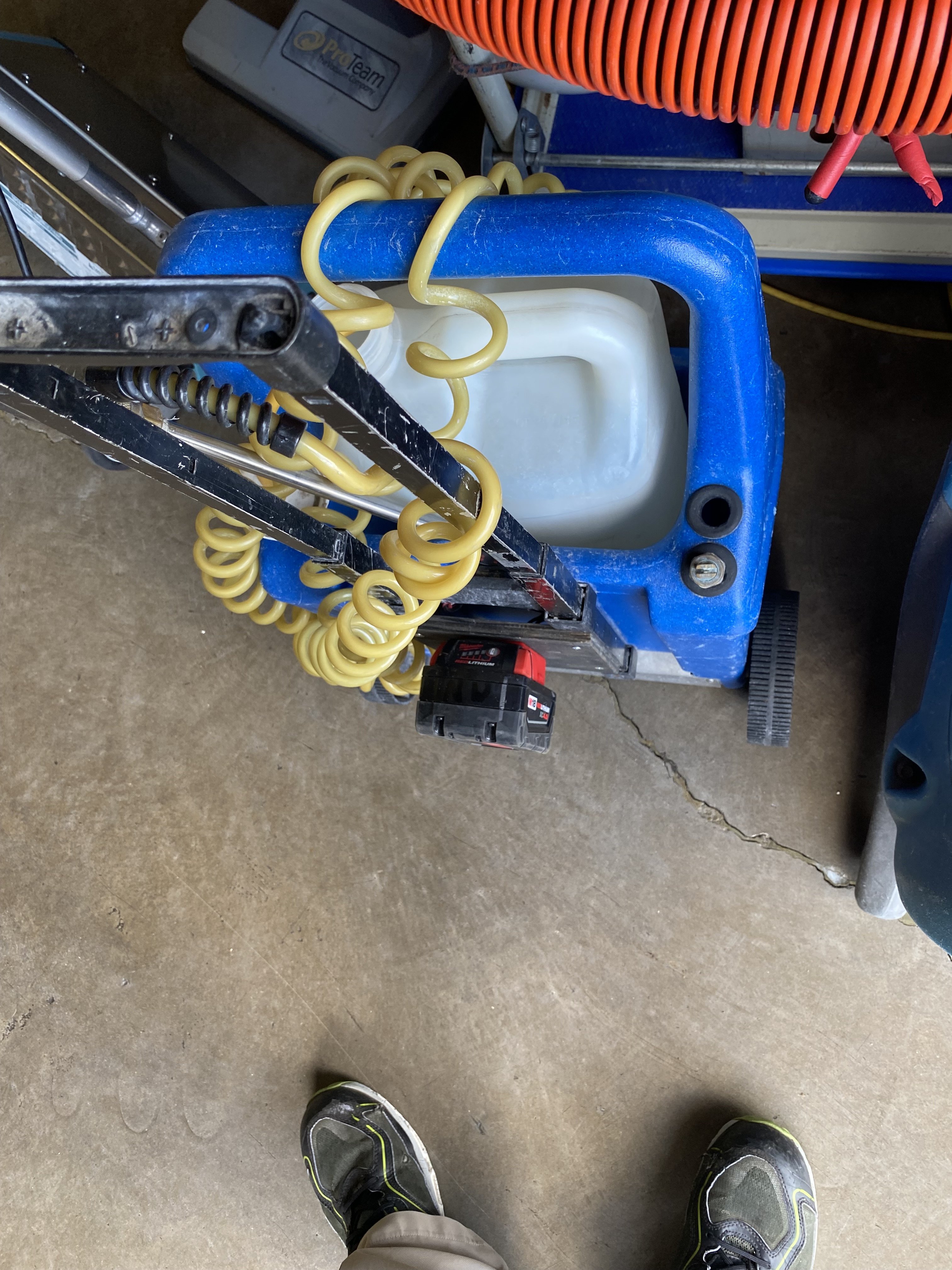

I retrofitted my Omni-Pro 2.5gal battery sprayer to receive a Milwaukee m12 battery.. Then I got smart and used a M18 battery.. It bumps up the voltage to the pump making it spin faster..
I like the M18 as you can see your battery level and when your low, not having to "guess" on if you have enough juice to make it through the job..
My sprayer is 10 years old, I've changed out the stock battery 3 times.. Changed the charger to the Black & Decker battery charger/tender.. Same pump, same gun, changed hose for a longer one..
If you own power tools, you should be able to find your battery adaptor that you can wire in.. It's just 2 wires even a Marty could do it......:headscratch:
