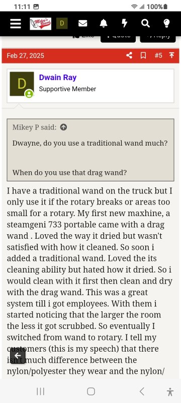

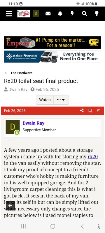

I explained it in great detail in another post where you aske similar question below is a screen shot of it and where to find it. Its more than i care to type again and i don't think anyone else would care to see it again. But if your intrested this is where it is. It tells what i do ,how i do it but more importantly how i explain it to my customers and make it simple, relatable without making them feal stupid. In short i believe it is the right way to clean all carpets. And over the almost 5 decades ive been doing it i have had more than a few carpet cleaner ask why do so much, but interestingly none has ever said it was the wrog way to clean. In short its what sets me apart from all other competitors

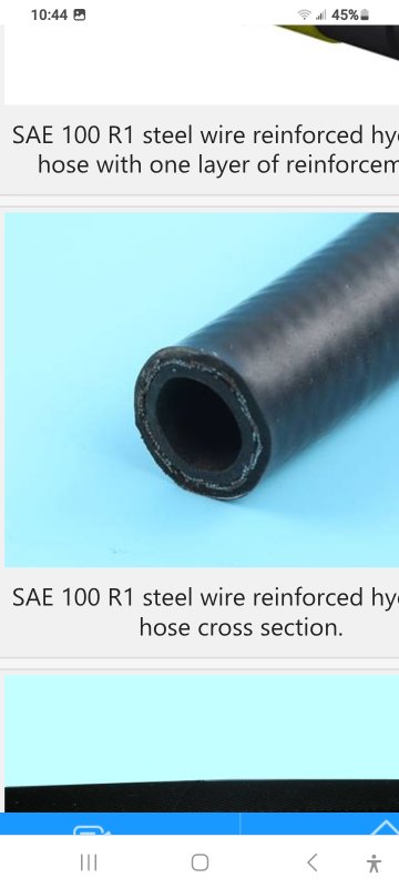

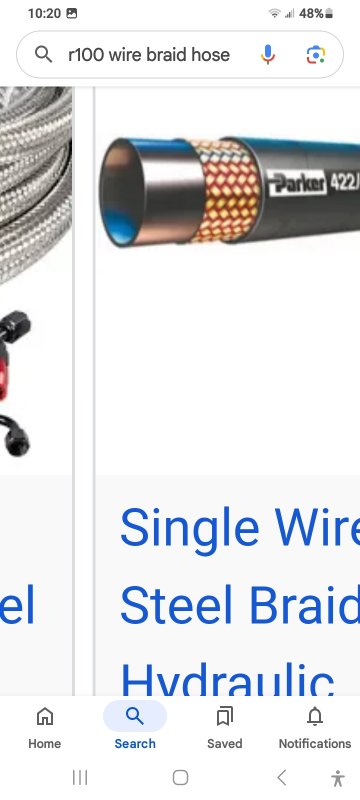

NO NO NO!!! You clearly do not know how these hoses are built . Black death is the rubber inner hose degrading generally from chemicals the wire braid has nothing to do with it . Here is a picture on how a 100r (single steel braid hose) is built
View attachment 130345 View attachment 130346
The thermal plastic hose is constructed the same but with differant materials for instance regular hose outside blue cover rubber other hose plastic. Regular hose inner refocusing braid steel, other hose fiber. Regular inner hose(soulition carring) black rubber other hose possibly teflon (i really don't know) but both hoses are constructed the same they just use differant materials in the construction.

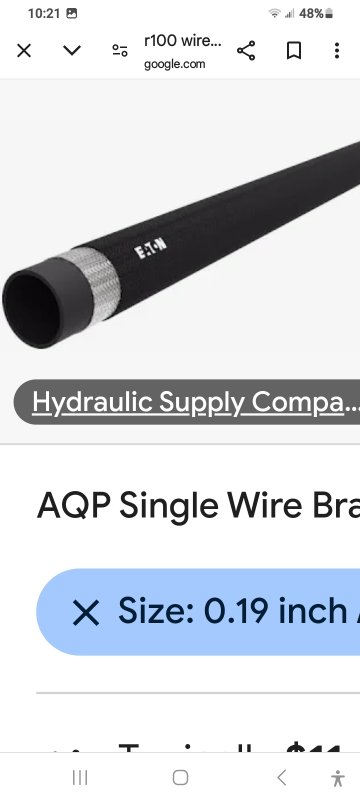

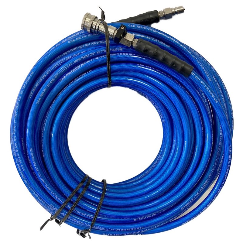

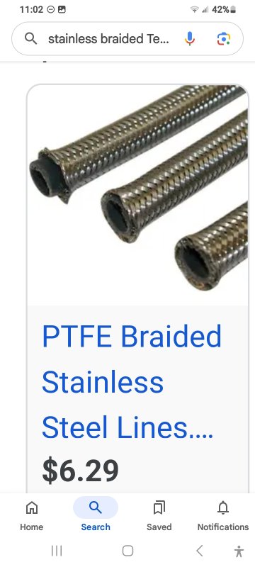

Think of these hoses like an inner tube. If the tube is outside the tire you'll never be able to put much air pressure in it. Itll just swell bigger and bigger till it pops. But put it in a tire and you can greatly increase the psi while matianing the tubs diameter Solution hoses are the same without the steel braid i wouldn't take much pressure to expand the hoses diameter till it pops n but incase it in a steel braided jacket and you can greatly increase the pressure in the hose . The outer (blue)jacket is there to protect the steel braid. Many industrial steel braided hoses dont have an outer cover because abrasive resistance is unnecessary

" Clearly " I don't, but when I cut the hoses to make whips for my five Hydro-Force sprayer blocks, I see what you see, just don't describe it in a great details 😉.
