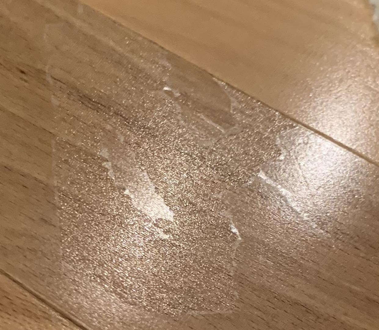

I have cleaned carpet for over 30 years. Ive been using 2 inch Scotch Blue painters tape on hardwood floors that abut the carpet Im cleaning. Usually I then lay carpet samples over the painters tape for good measure to protect the wood floor.
Cleaned for a new customer that had a 20 foot area that had to be taped. Didnt have enough carpet samples to fill that length so I double taped it (two widths) and laid what carpet samples I had.
Customer calls me back to say that there is damage to the wood floor. I go to inspect it and there are 4 - 5 areas that are about 3 inches long where there seems that the finish was removed. They are located in the areas where I had taped the floor and seem to be the width of the tape. House is 16 years old
I have NEVER had this happen before and tape wood floors on a daily basis.
Can anyone tell me what possibly happened?

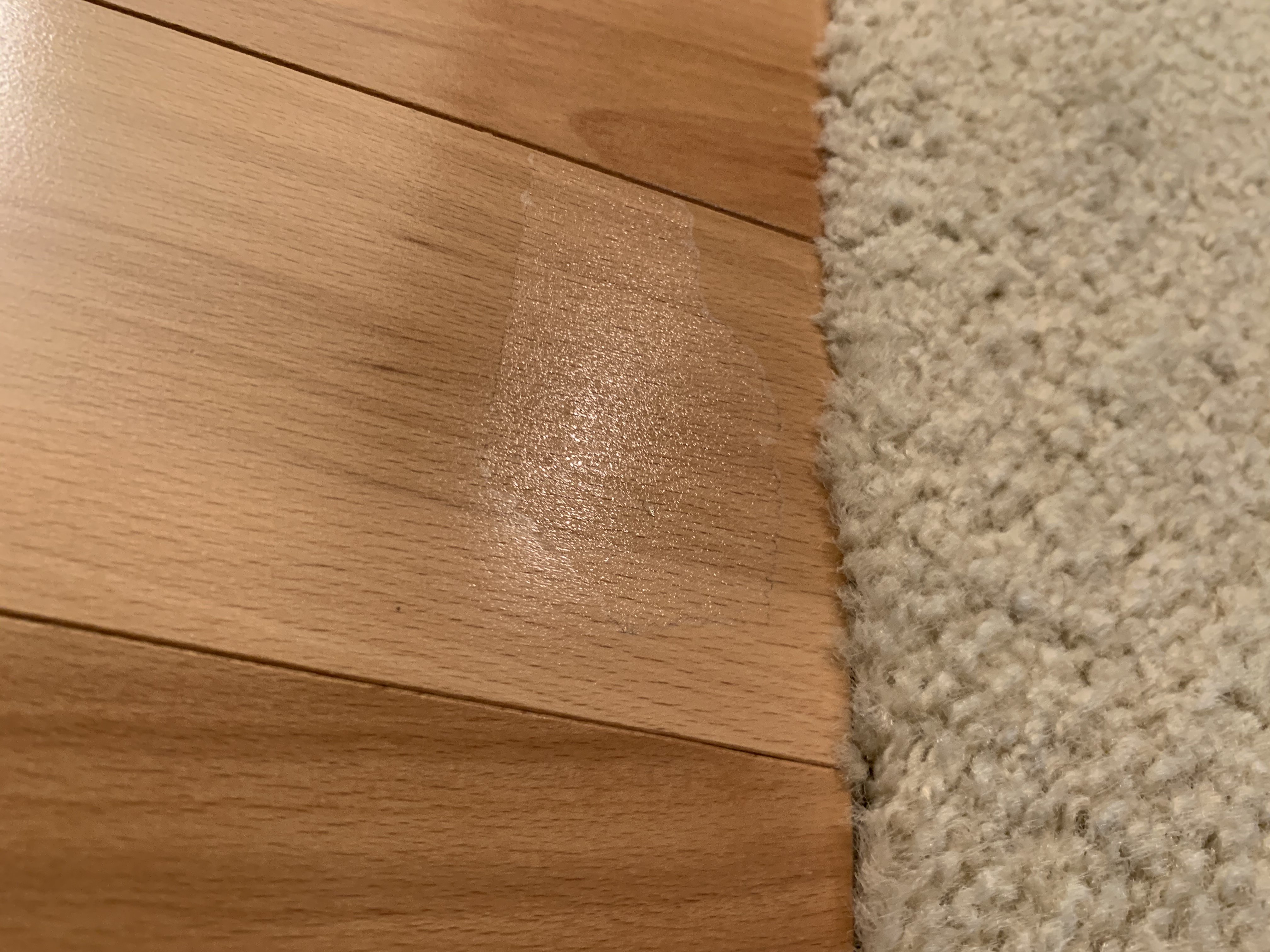

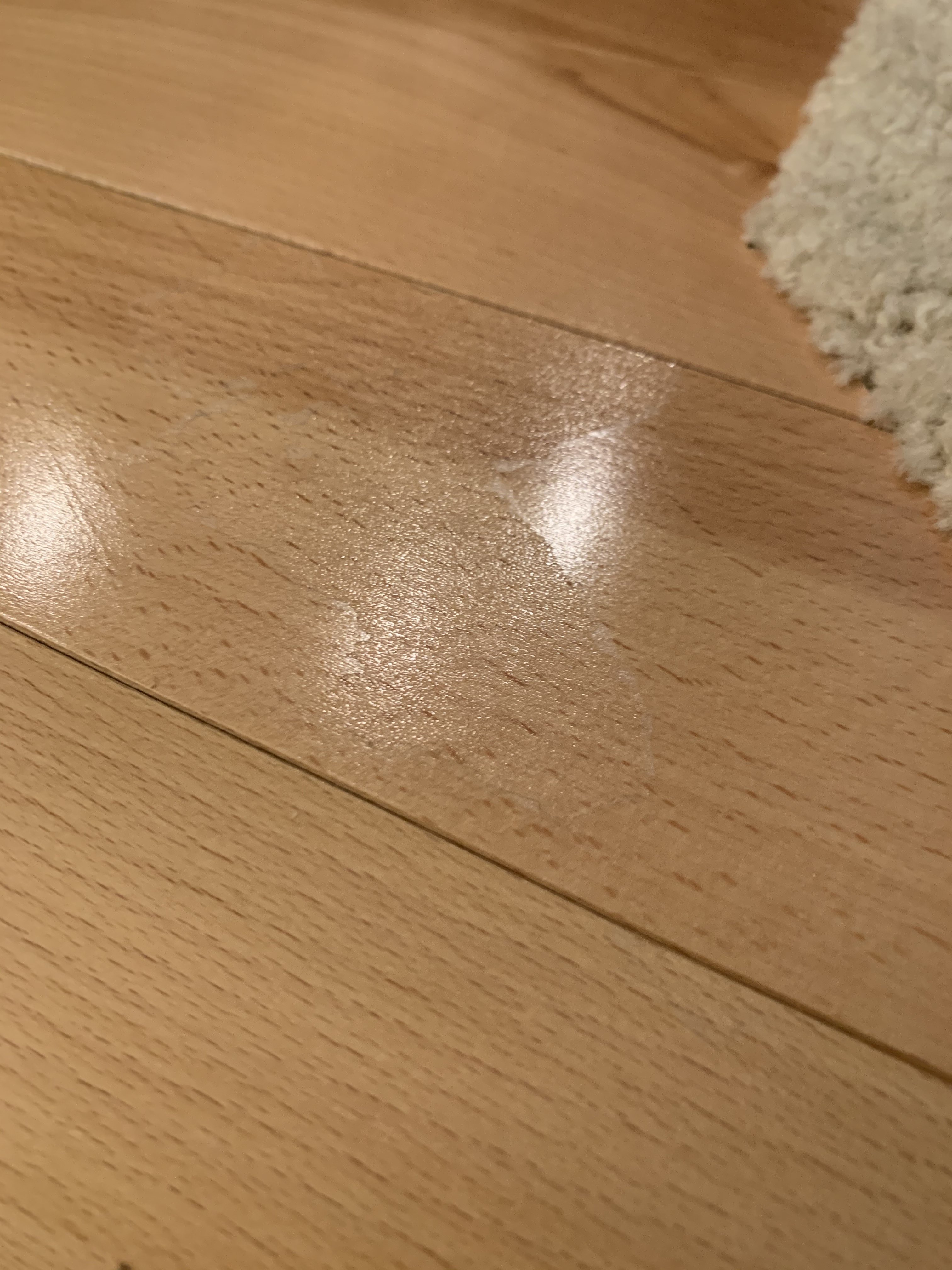

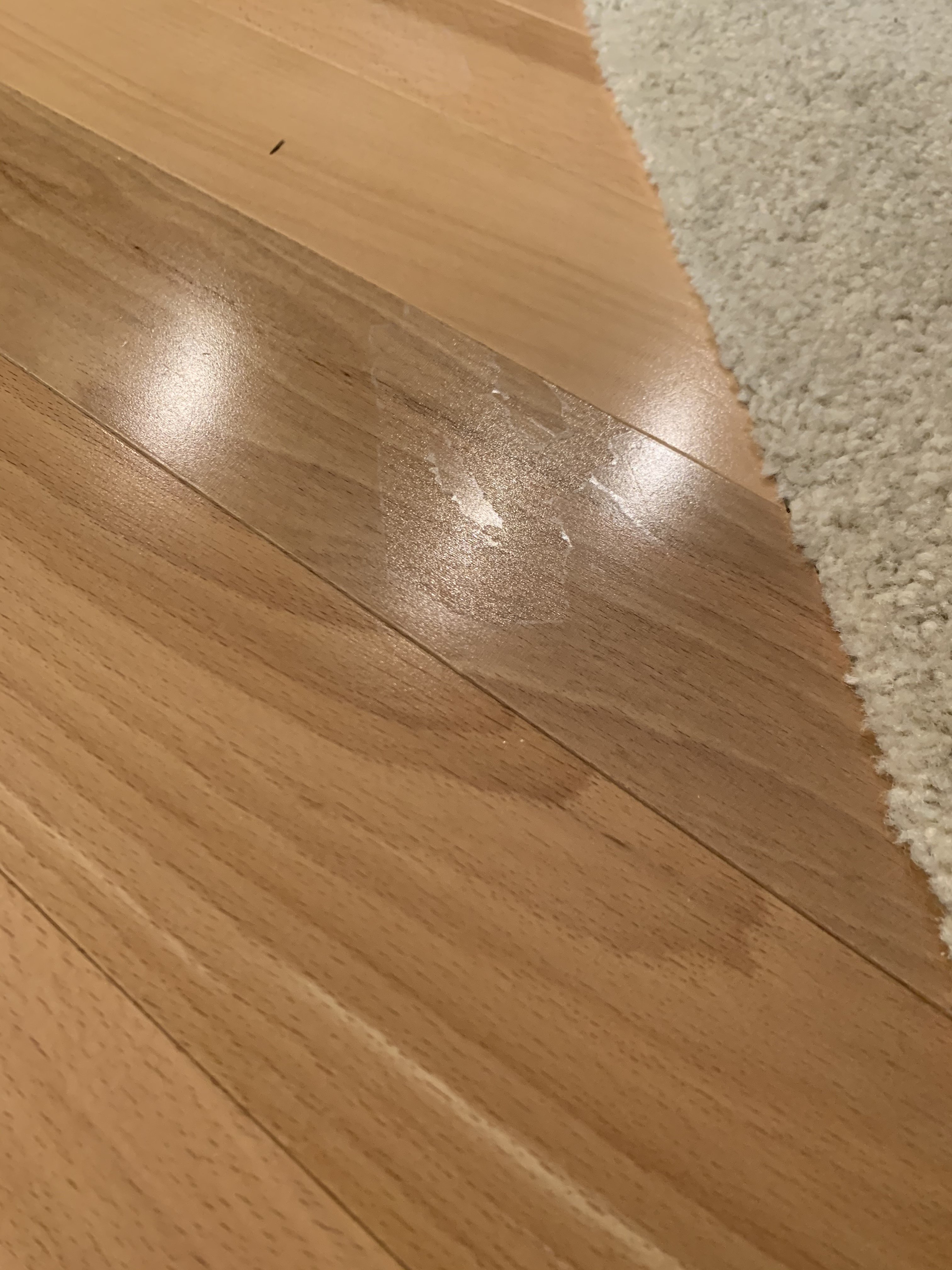

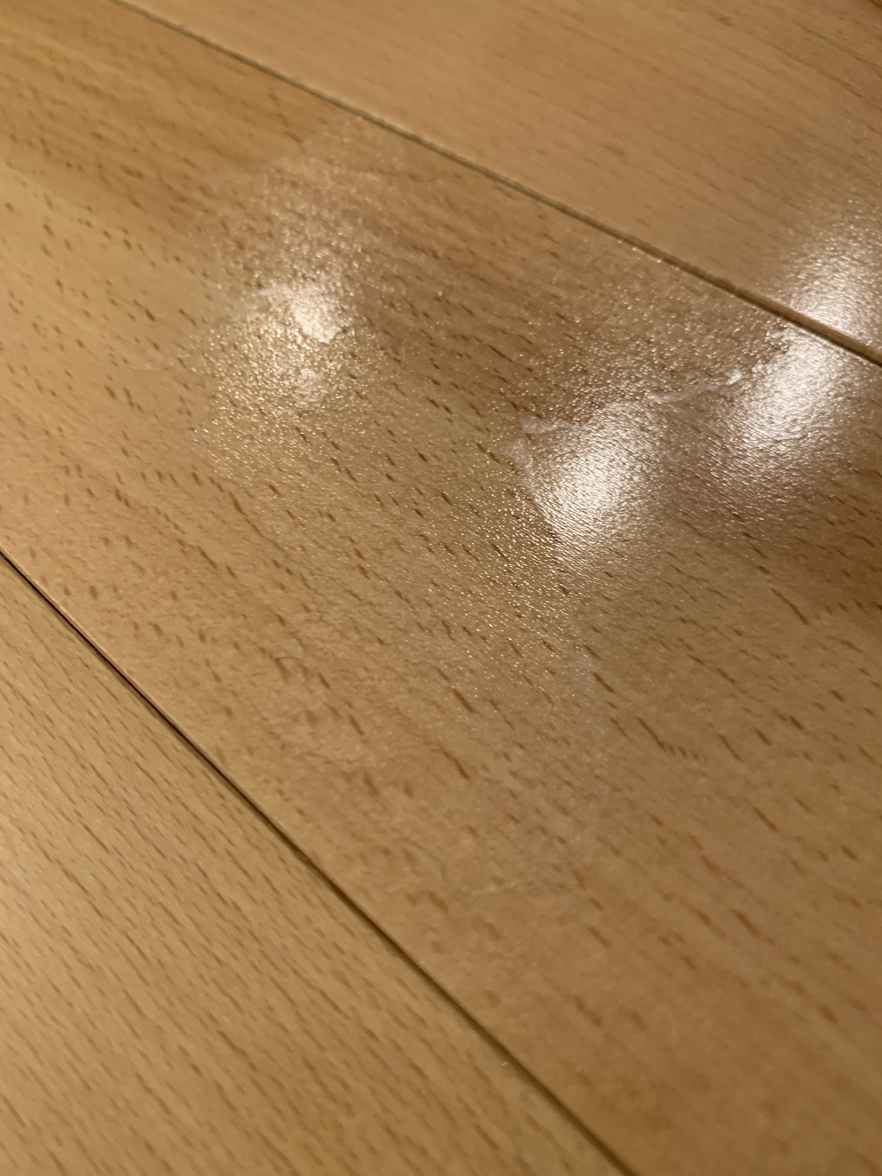

heres pictures. Talked to lady and she knows the seller so she called him and he has not done anything to the floors since the house was new.

after further research, I should be using Scotch DELICATE SURFACE tape not the regular Blue.
The area affected has a rough feel to it. Not sure a microfiber would fix it.
27,966
In the first pic, it looks like the floor was wet. I see the tape outline but the wood is darker near the carpet. Although your theory sounds good, you may be getting too aggressive because you think you protected the floor. I don't think the tape is waterproof. Leaving wet tape on the floor until you finish the job might not be a good idea. Using a glided wand, I just vacuum up any overspray as it happens. I haven't had any issues yet.
last pic looks like the finish was actually pulled off
