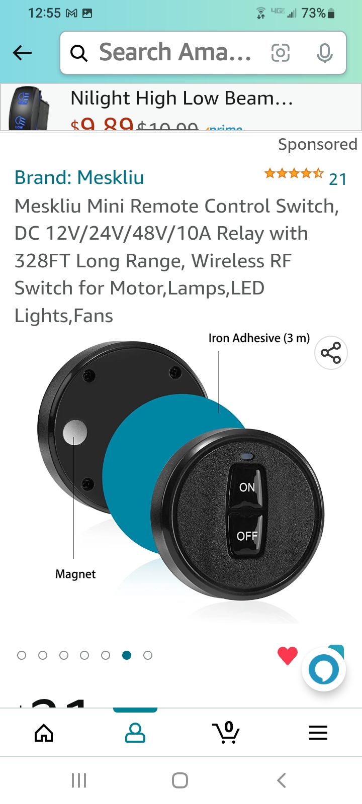

When wiring one of these to frankinstien i took this consern into consideration , so with my wiring the machine will work manually if i leave the remote at home, but while thinking about your machine, it's a simple fix. What you can do is wire a toggle switch between the 2 positive wires on your remote controller so when the switch is in the off position the remote controller works as it does right now however if the toggle switch is turned on it will bypass the remote controller and your machine will work as it did before the remote controller was installed regardless of what buttons you push on the remote, (you can do the same thing with a jumper wire but you'd have to open the panel and install and remove it each time) anyway it's a thought i had about this consern of yours thanks again for this idea. Dwaino

Mr Mikej i have another solution for your conserni ordered this remote also so i can have a button handy on the machine, as it turns out i tend to leave the remote in the home on a windowsill next to my coffee cup. As it turns out this unit comes with 2 magnetic remotes i only need 1 so if you pm me a shipping address im more than happy to give you the extra one,it comes with a metal pad if you don't have any steel handy where you want to install it. This way you too will always have a button handy. Dwaino
Screenshot_20230302-125522_Amazon Shopping.jpg Screenshot_20230302-125541_Amazon Shopping.jpg

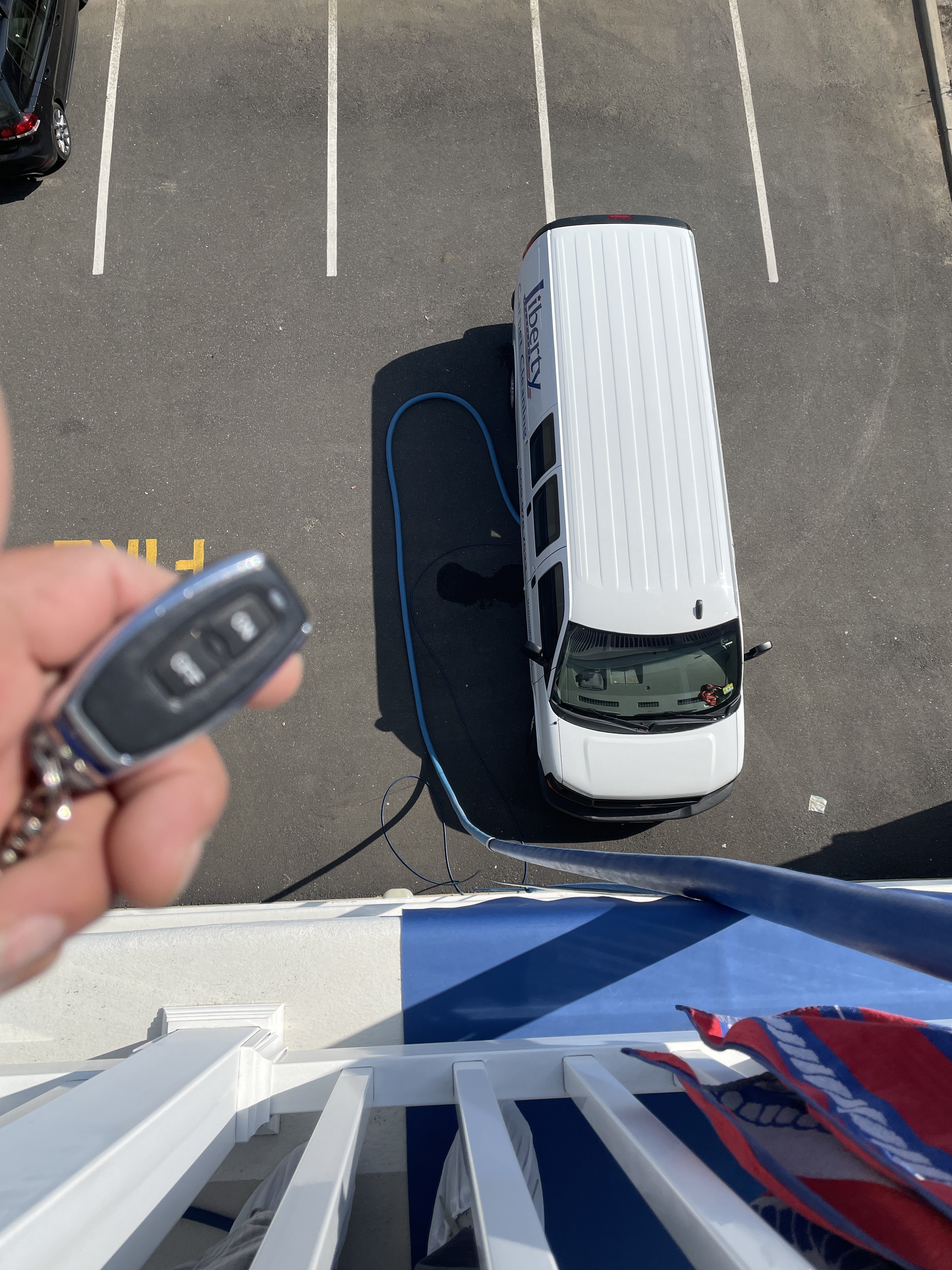

Got my Thermalwave up and running from being winterized. That remote start/stop is noticeably missing on it. Got so used to it on my Hydramaster CDS 4.8. What a effecient option especially when solo.
Mike J
Feb 21, 2022
1,326
East
Mike Joannides
MJ how's the remote switch working out for you? You've had some time under your belt with it.. @Mike J
I use it frequently and it works great. Still the same battery in original fob.
There is no way I could fill these orders without. It lets me finish rooms as I go and my machine time is getting way lower. So Im giving it a great review. I have a back up ready to go.
