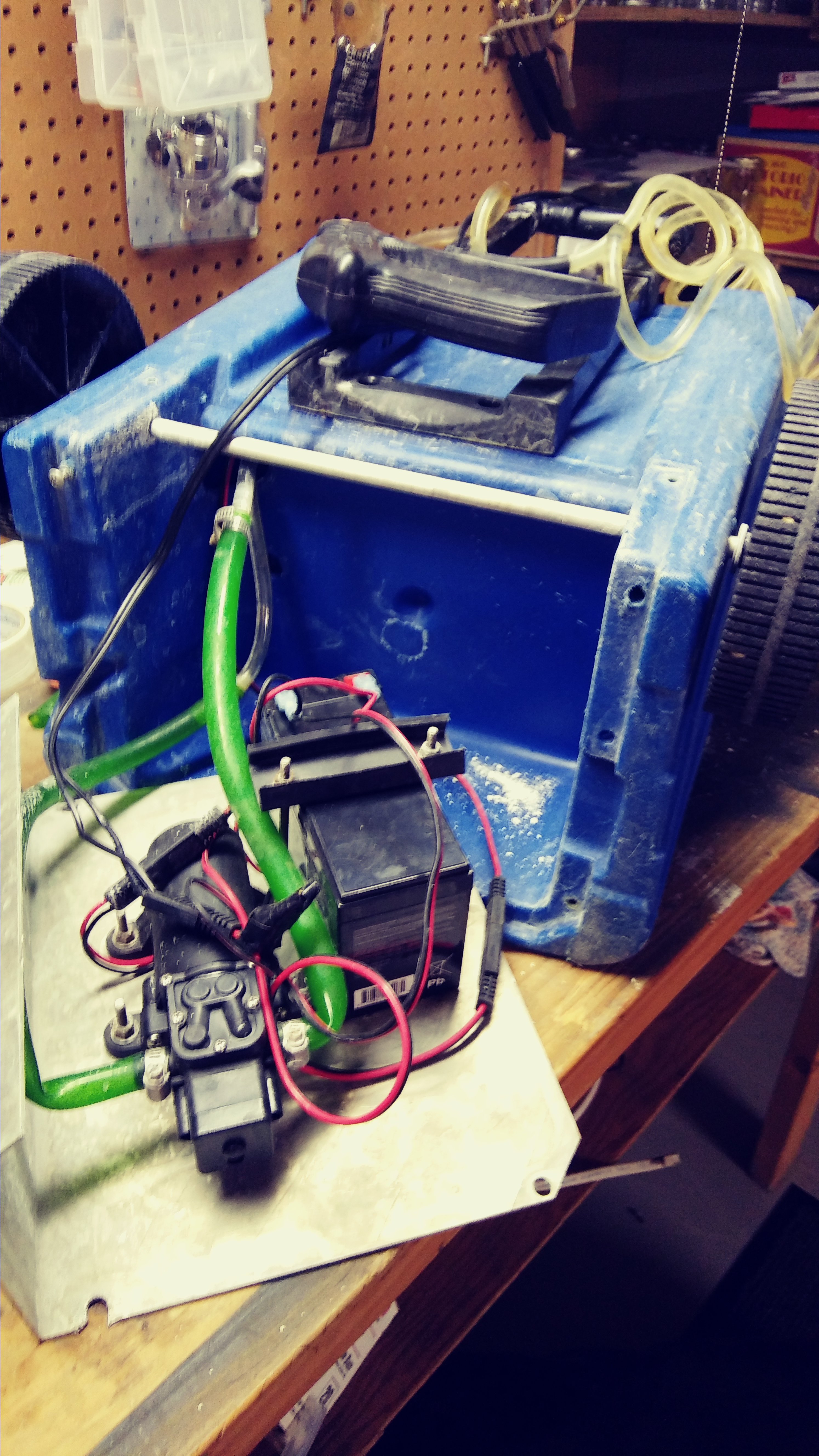

I would put the battery where it easily accesible. I've fought this Crap for several years. Everything from wires coming loose on the switch and baterry connection to I had no clue so rewired the whole Damn thing and I still keep having issues getting the battery to charge correctly.
Rural king chemical pumps. Smallest one for $30 or so. 60 psi I think. They last me a long time. I could go bigger but it wouldn't fit the mount correctly.

Steve shoot me your cell number by PM and I will send you a pic of my sprayer for ideas. Used it last ten years and only replaced battery twice.
I keep bayyery on on the sprayer and a spare in the truck. Bring home and put on a trickle charger. Use it mainly for bonnet cleaning.

20190429_111641_Film1.jpgthe cover sucks to get off and on. Thinking of a way to make it easier. One screw should be enough not 6 that get soaked in product regularly from the wand dripping in the holder. Just haven't got angry enough yet to do it lol.
