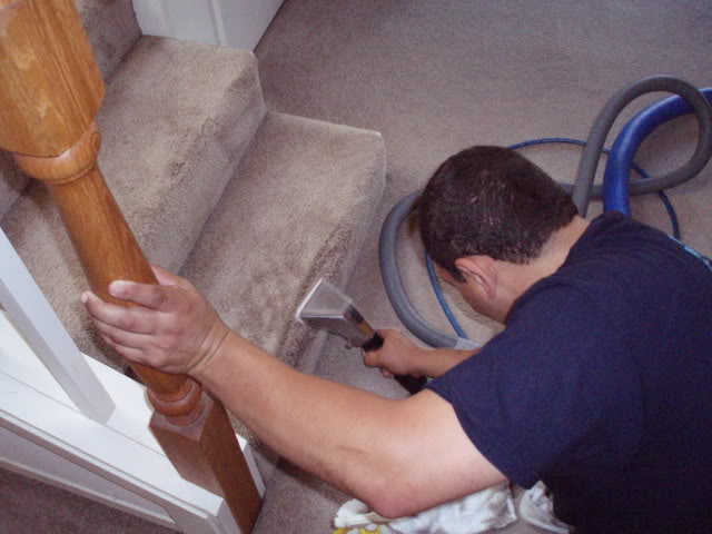

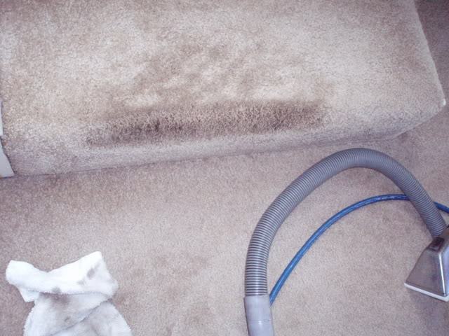

Tell me how you handle filthy staircases.
I had one today that pitched pretty bad.
Cleaned only a few times in 20 years.
We vacuumed, pre sprayed, granditated and V rinsed but the bull nose still looked bad.

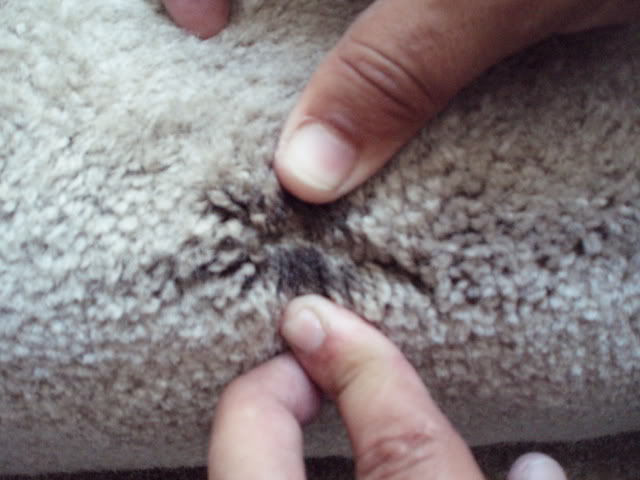

I parted the fibers to find thick gooey crud surrounding clumps of fibers. No real pattern to the cruddy areas but each step had a few goo gobs.
Mrs Piftleton nor I had any idea how this happened.

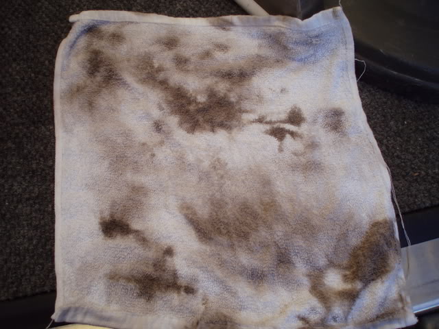

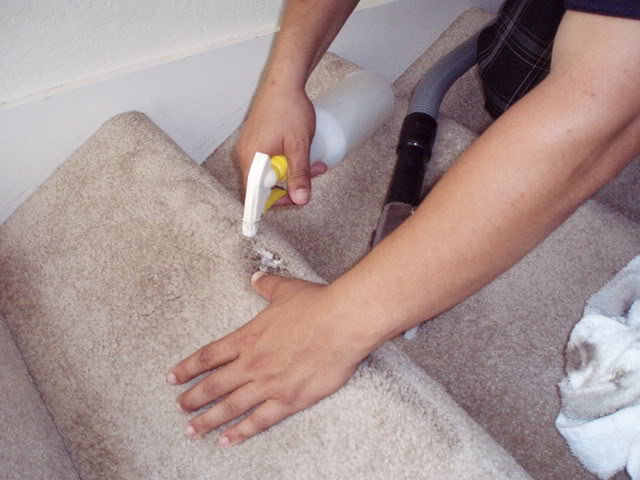

I tried spraying ENC and toweling it off. I stuck my fingers in there real
good and scrubbed like hell but all that did was spread it around. We are talking thick sticky mud here.
So I attached the PC hand tool and cranked up the pressure a bit and basically pressure washed out the goo.
I tired to imagine using one of the mini pad machines to do this and had to laugh. No way.
Flush baby FLUSH!!!!!
Took way too long but we got it looking pretty good.
Twenty years of wear but she was stoked.

That rag work was before I pressure washed it.
This job reminded me of the many car mats I've pressure washed where it takes over 15 minutes for the water to run clear.
I've never seen a staircase so gooed up that was not directly connected to a garage before.

Do you open up each and every bull nose to see if 20 years of hidden goo lies within?
Yeah right....
I would bet not a single one of you who commented have a glided PC tool.
It works just fine on bullnoses.
When we were trying to remove it with a towel it just spread the crap around. No matter how many times we flipped it or added more ENC, cotton was NOT going to make this go away.
What finally got it all out was ENC and tons of HWE!

We did do a heavy PS with the HF, grandi groomed it in as well. Every thing came out fine with the TI wand but these random gunked areas.
It was way wierd how they were so thick and spread out. And for what ever reason only on the bullnose.
The glide pops (pulls) off that tool pretty easy. It's a slot type so I dont see how going glidless would have helped.
