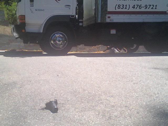

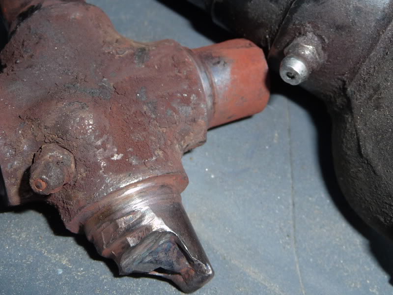

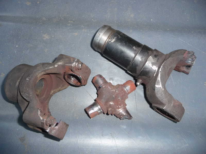

PTO universal joint exploded today on the POS ******.
Shaft looks good but will get check for true-ness in the AM
My fault for not checking each and every time my guy Zerked it. :roll:
From the looks of the fitting its been a long time. :shock: :!:
If all goes well it will be up and running on Friday.
116,462
Landed 20 ft away...

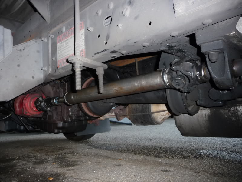

consider yourself lucky.....when mine came undone it went off like a grenade under the truck ...shit went everywhere.........including threw the transmission pan....tore up the shaft and the yoke....
had to get it towed.....
hole in pan welded.....
replace the yoke and the shaft off the PTO.....
and give some guy that was standing by it $20 bucks for a new pair of under ware because I am pretty sure he shit himself when it came unglued.............

Notice the unused Zerk!!
A fabricator took both ends off the old bent shaft and welded them on to a new home.
All said and done $425.
