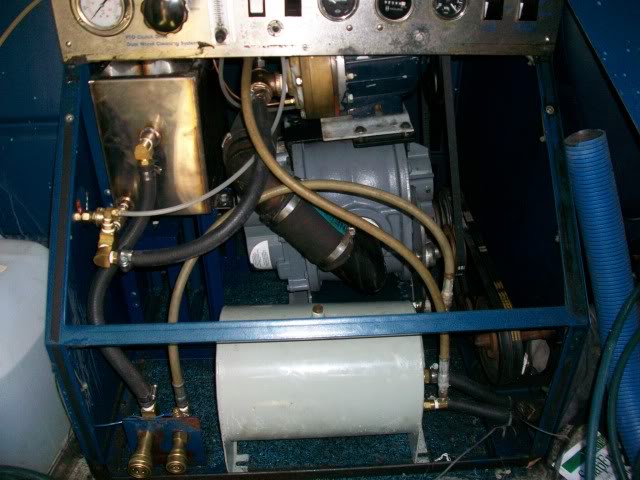

Ashley, I must admit I don't remember ever seeing your custom-built truckmount, did you ever post pics? I tried a search but couldn't find it.

The pics I posted here are gone for some reason, and I cant find them save on my hard drive.
...it was a monstrosity :)

I'm still learning, but was there a shaft directly driving the blower or a belt?
