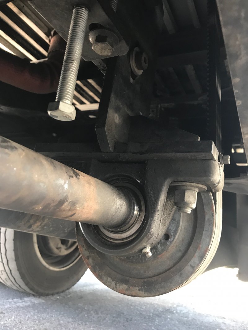

My new guy is going to replace the blocks and U joints this weekend, he asked if the drive shaft will slip out of the Pillow Blocks or if they'll need pressing out...

And have that top bracket bolt checked. It looks like the bracket slipped down 1/8 of an inch. It'll cause the U-joint to fatigue early.
