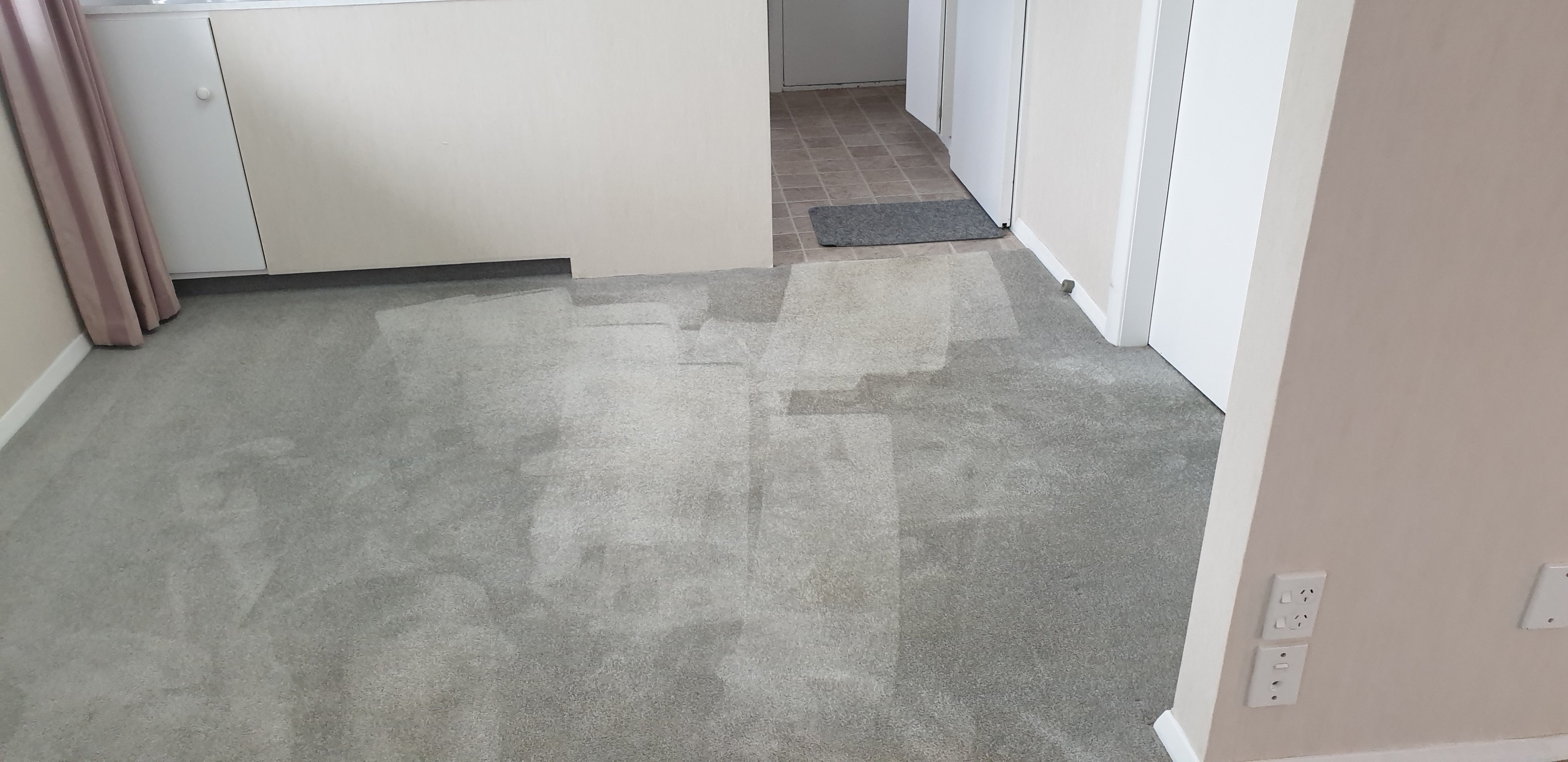

Although wool is very durable it's not without some issues. Wool will keep shedding for the life of the carpet. Clogs up your vacuum and you will see wool fibre drifting in the air. Wool is also subject to pooling or shading. I just a 5 year old wool carpet in a condo and although it cleaned up great. It has large areas of pooling scattered through out the unit. It's part of the patina but can look unsightly.
24,126
What's pooling? Is that dye migration?

A good explanation here:
Back "in the day", carpet retailers would tell people that pooling was a part of the natural beauty of only the best quality carpets, and their customer should be grateful that the carpet they purchased was proven to be the best.
People were more gullible and forgiving then than now, to say the least.
24,126
Oh ok, I always referred to it as Knap (Nap?) reversal. Thanks Jim.

spent an hour with a customer and a loss adjuster yesterday trying to explain to the customer the pooling/shadowing is not a defect or water damage (place had been flooded and with all furniture out it was more obvious)
the loss adjuster knew what it was but customer isn't convinced.. the adjusters problem, call me gone!
Well put in snippet below Damon.
. In early days we tried to do corrections with very very limited and usually only temporary success with pile-lifters. Problem is it can happen years after it has been laid and manufacturers have come up with all sorts of theories but nothing conclusive.
"Featured snippet from the web
"Pooling' and 'watermarking' are forms of pile reversal that can change the appearance of both wool and synthetic carpets. ... Even the best and most expensive carpets can pool. Unfortunately it is irreversible and permanent."
