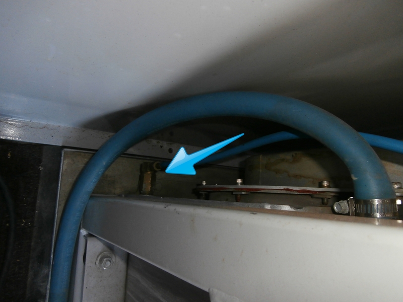

Dang if I didn't get sucked into this thread. I'm looking serious at a new Sapphire TM and this thread's not necessarily gonna chase me off but I'm wondering about design flaw/s. I've had a belly full of them on my WM commander. Sapphire boasts a lot about their water box/heater assemble and yet the quality of this single component (the thermal relief valve) and placement of it sounds a bit goofy. Hasn't Prochem been using the same valve on their water boxes for years without failures? Perhaps(?) combining a water box into or physically surrounding the heat exchanger assemble was to much; to much heat.

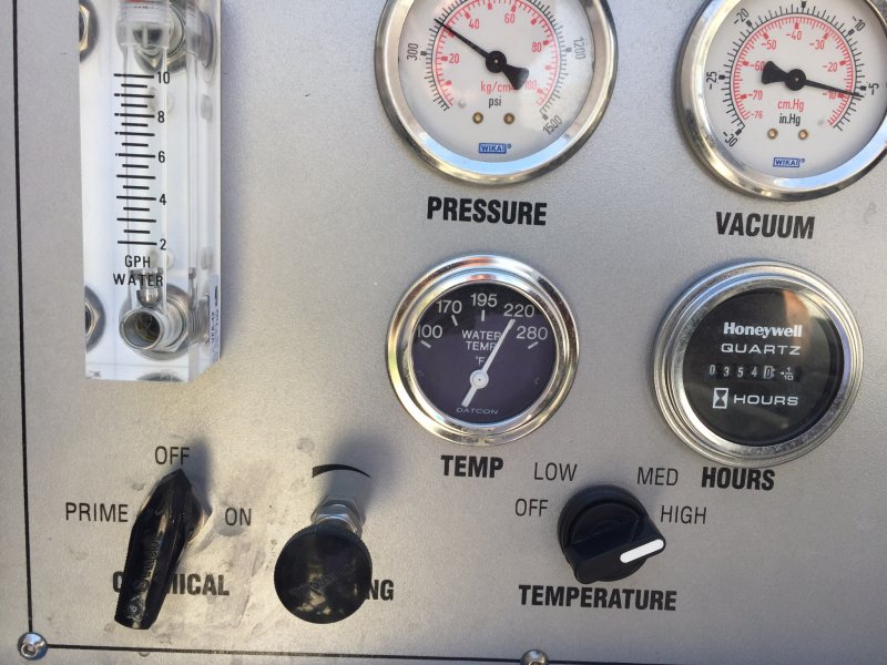

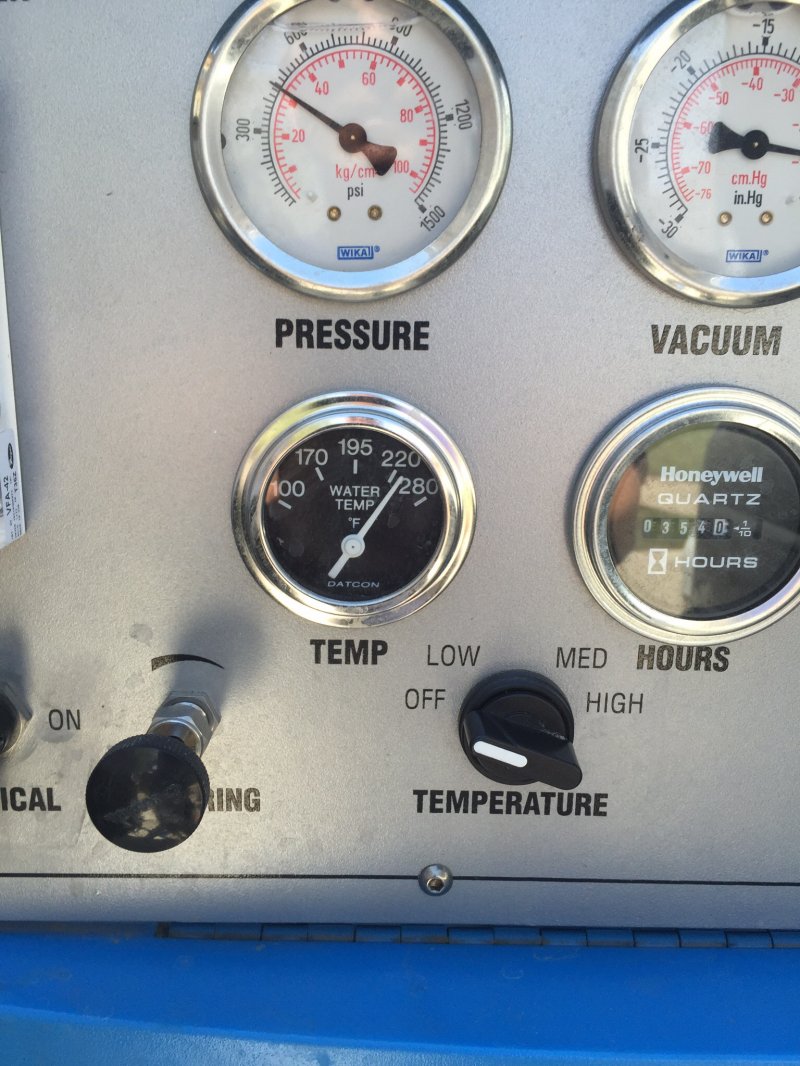

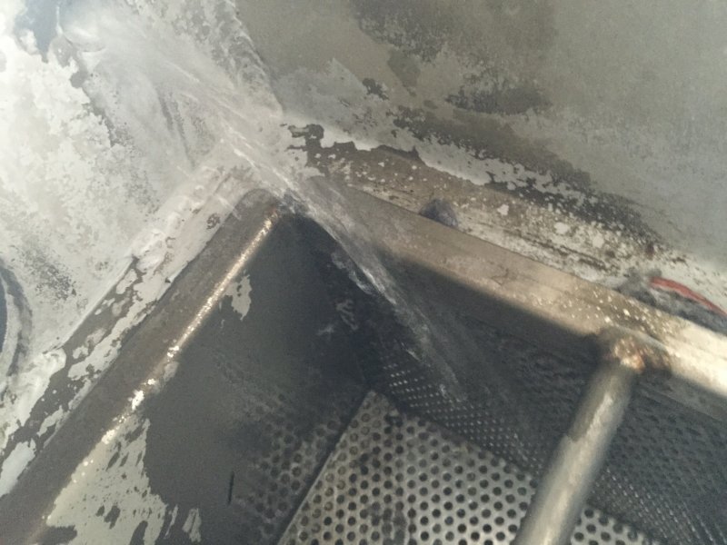

The machine holds reall good heat and cleans like mad, the issue with the temp switch is something i'll get fix when I can go to mitch. the uber bypassing was making me mad after fillling up after 400 sq ft of tile and 200 sq ft room. I notice the bypass was just running running running, and new a few people here had the same problem was hoping it was an easy fix. Hopefully Empire can tune it in and make it right.

Hum, how to make a $13,000 Sapphire Rage into a nicely temp adjustable machine? Maybe, just maybe if you routed the exiting hose coming from the bypass valve through a remotely located electric (bout 4 amps) cooling fan/radiator, on it's back to water box, you might have the beginnings of taming the Rage for upholstery.
And, you might go further and install a variable temp control valve (they show installed in the flow diagram) and use that water circuit routed to a remote cooler back to the water box. You would still have a fail safe thermal relief valve in the water box dumping to the waste tank (though it might not see a lot of action with a bypass cooling system installed), and of course any fail safe temp sensor switches installed in the machine would be not be effected. With this set up to could set your wand or tile tool down for many minutes to fool around moving furniture or mess with detergents and/or spotting.

We solved this problem by diverting the water into our fresh water tank.. also helps to pre-heat the water... but we also warn our techs to keep the water flowing at the wand and not to stop more then 5 minutes without using the water.
I blew an engine after about 30 minutes when I failed to run water through the TM.

Actually I said it closed the next morning! when the ambient temperature outside is cooler the machine doesnt get as hot and bypasses less when its 90 plus or hotter out and it runs for a while it cant bypass enough. thats my take on it.
The day it was bypassing like crazy was a warmer day!
As for the temp switch they called SS waiting on a reply.
I'm thinking of going 18 flow on my ti and seeing if that helps.

What you do when you know it's sticking is to reach down and smack it with a cresent wrench. Just like when a car starter would act up. Frees up the gunk an gets it flowing.
Is funny I know this guy who got a truckmount from the same place as Sam and was told by their mechanic to smack the dema valve with a rubber mallet
