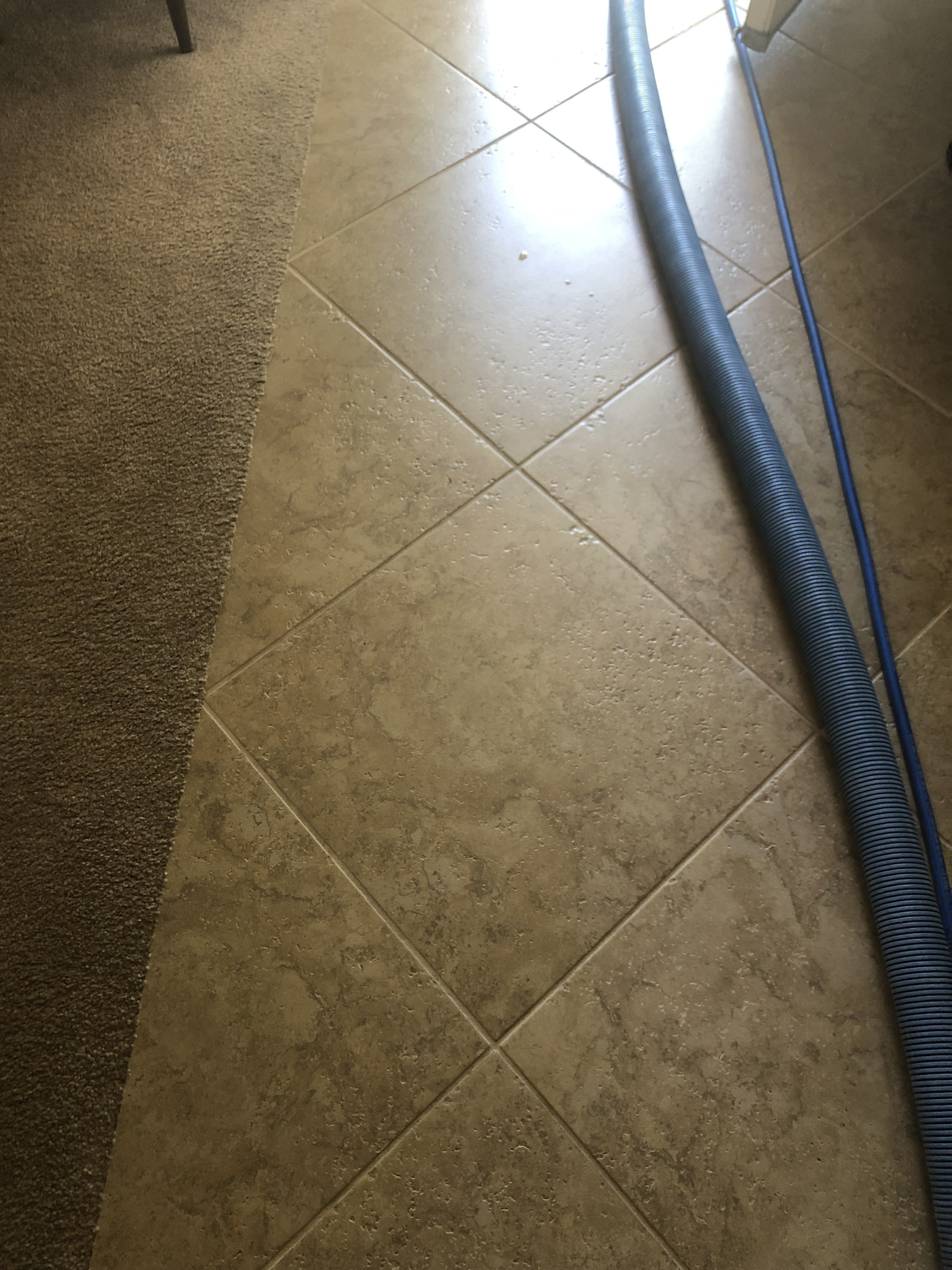

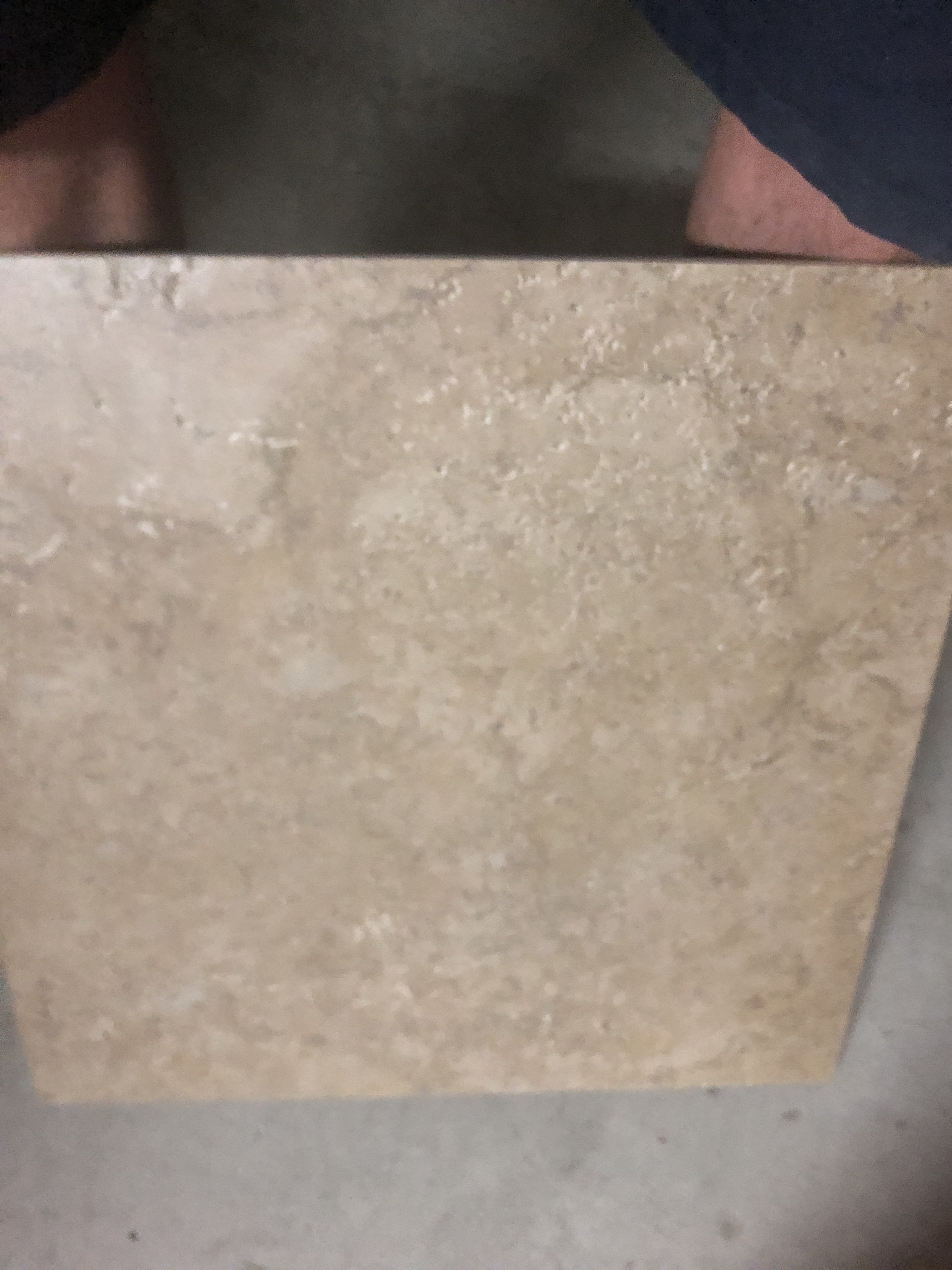

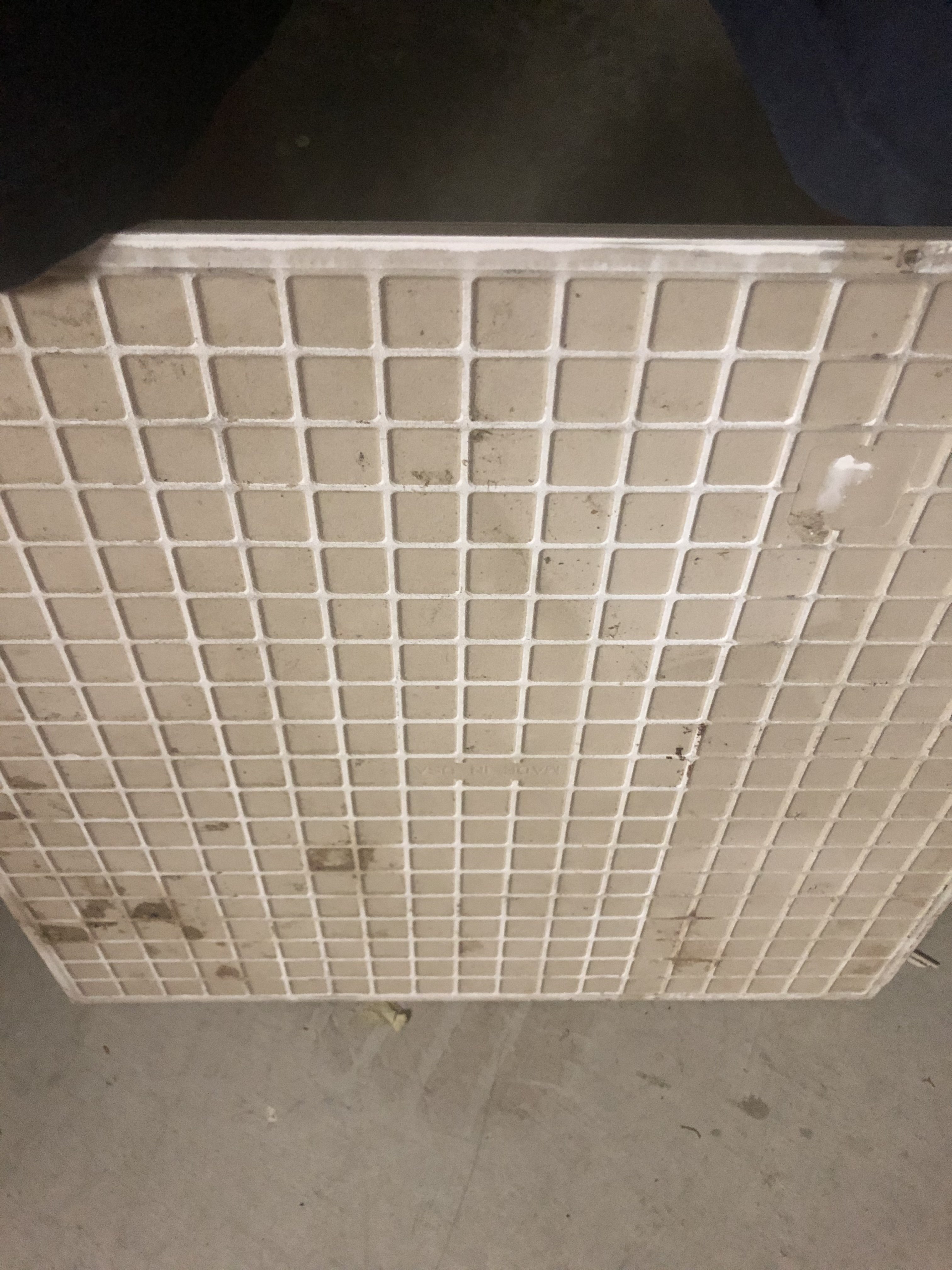

Lady said she had natural stone and paid 40k for the floors 500 sq ft.
Track housing. Pretty sure it was porcelain or ceramic. Either way paid way to much

I know it wasn’t real but she was super convinced she paid a ton to the builder and it was natural. If they did pay more they got robbed

When I walked in and looked at it, I called my wife immediately and said stay home I don’t need my stone products for this. I didn’t have acid and the scratch test pretty much made sure it wasn’t natural. But when someone Insist you start to question and check
