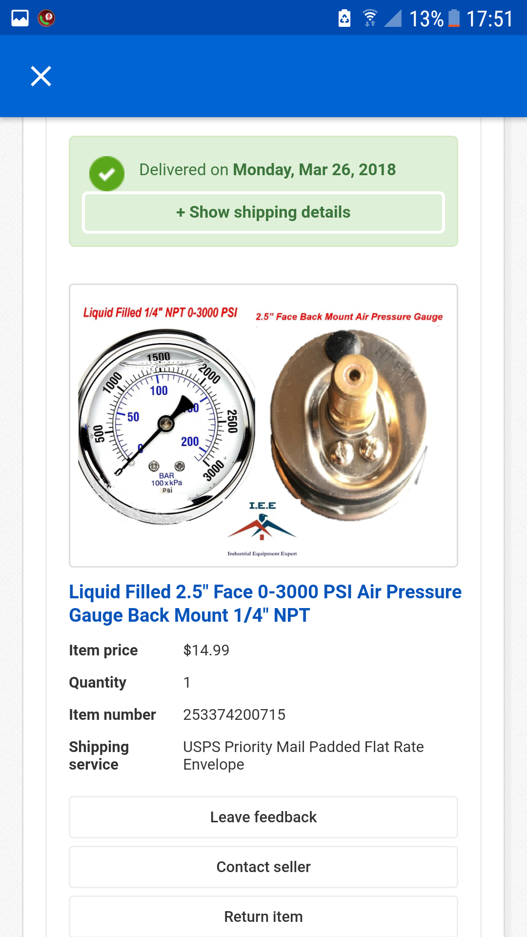

I bought this guy off EBay. No idea if it's going to work. A fraction of the price. Hopefully it doesn't fly off and hit me in the head.

I bought this guy off EBay. No idea if it's going to work. A fraction of the price. Hopefully it doesn't fly off and hit me in the head. View attachment 79072
If that is pic of exact 1 you bought it says its for air pressure.. It may work perfectly fine as pressure is pressure. I dont know if they're made differently for air vs water pressure?
