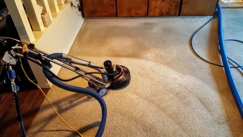

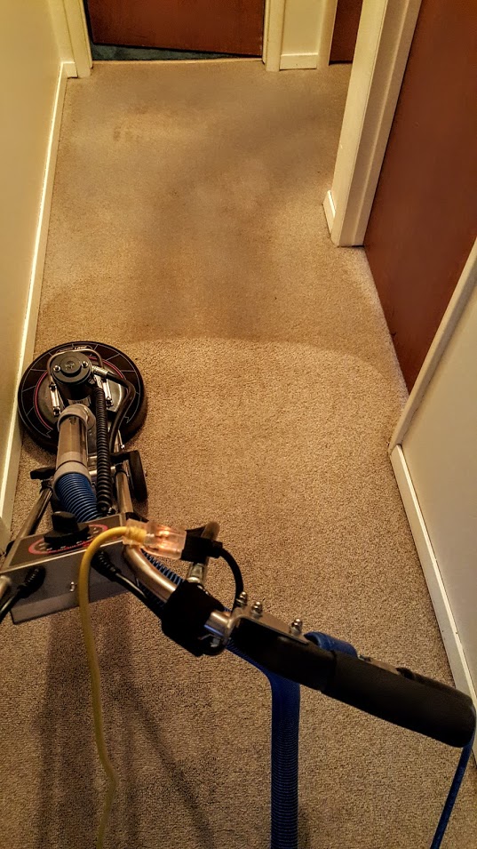

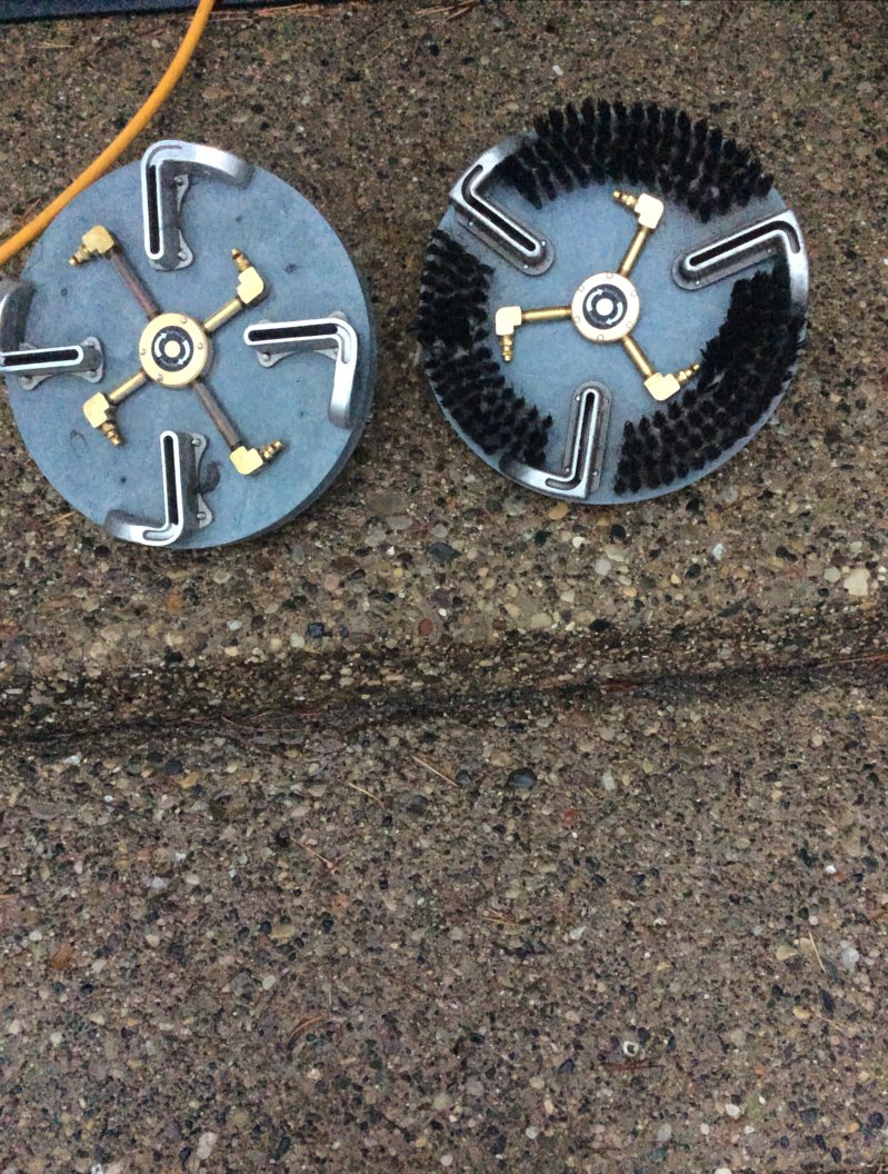

360i Brush Head..
116,023
is a winner.
I wish I would have tired this years ago when I had two "i's"...
no streaking and digs like mad..

Just thinking about this RV and brush combo, I would go out on a limb and say it mught be the best setup, the brushes will help Flick or pick the sand type debris with vac ports to boot to suck it up, very nice.

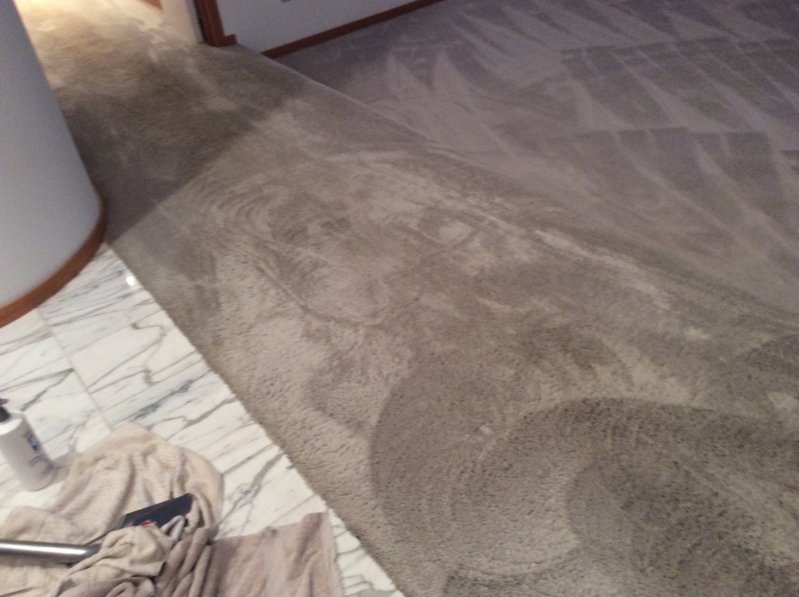

No tip bloom that I have seen, but I always prespray before hand. Plus the brush isn't so stiff that you break it in on concrete like a regular brush head. I tested it against a quad head on a hallway by a sunken living room last week
The brush head (used on the right) is more aggressive than the quad head (used on the left)
But there was no difference in the pile look when I wanded out the swirls.

I've got a brand new brush head that I used once or twice on CGD. It seemed to jump around too much.
But it looks like maybe I haven't given it a fair enough chance?!

As I did say, the brush head is more aggressive than the quad head. It is what I have always wanted in a cleaning device. Before I got the 360i I used to (sometimes) clean with both a 175 with a brush and a wand, simultaneously, one in each hand. It was awkward but highly effective on impacted traffic lanes. This brush head 360i cleans even better with ease. With it, you can touch the face of God.
