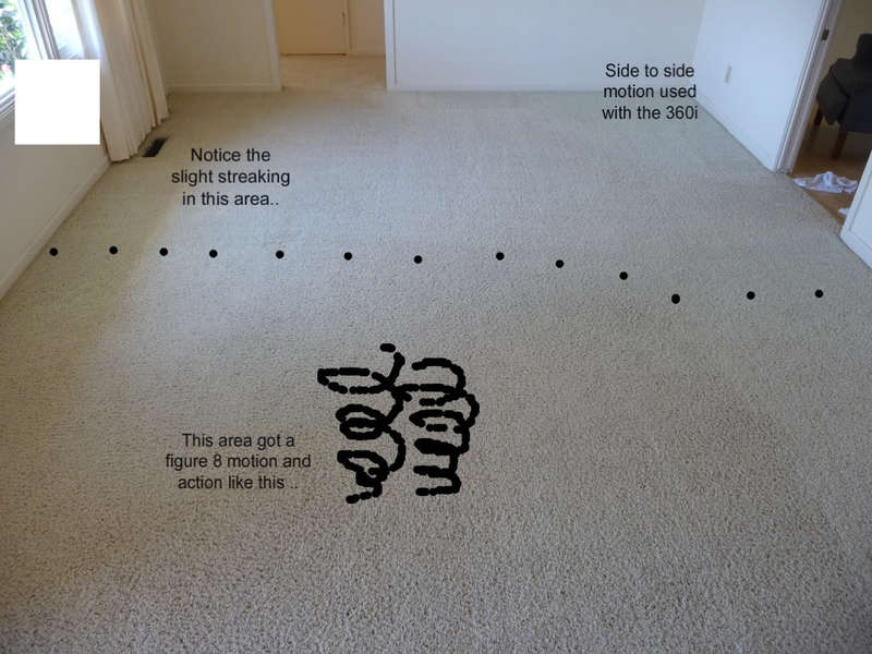

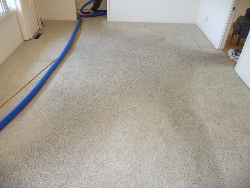

On dirty thick light colored piles it's pretty easy to cause some streaking if you use a side to side motion with your 360i.
I'm thinking its the dead spot in the center of the head that is getting less flushing action on the first pass or two. I tried to fix the streaks by cleaning at a 90º but it didn't help much
I experimented with different motions today with some success with a swirly figure 8 sort of swipe..

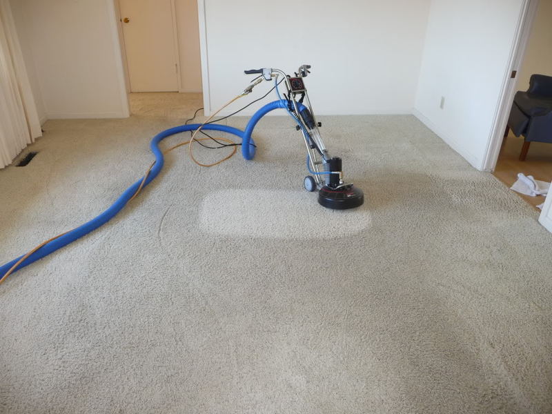

Yes Donald we use it every day, not every job but every day. Insted of breaking out the 175 and shampoo brush we use this baby on dirty carpet.

When they train you after you buy a Chem-Dry, they teach you to clean in that motion.
Although it is "side to side figure eights" sort of.
It eliminates the streaking and gets all sides of the fiber.
After a years of doing it, you tend to get it right or get out of doing it.
Do I have to teach you guys everything?? :mrgreen:
Looks like it did a great job, why do you suppose they make the head so small? It seems like if they would add a few inches the production would be so much better!

you did vacuum?
could be just the wand pattern and shading where you're seeing the streaking. You wouldn't get that with a Fig8 pattern.
As long as you're overlapping enough you shouldn'[t have to worry about the center area.

When I use a rotary I do three passes side to side then cover the same area forward and back. And groom as you go, don't wait. Especialy if you are using an airpath
