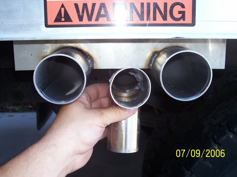

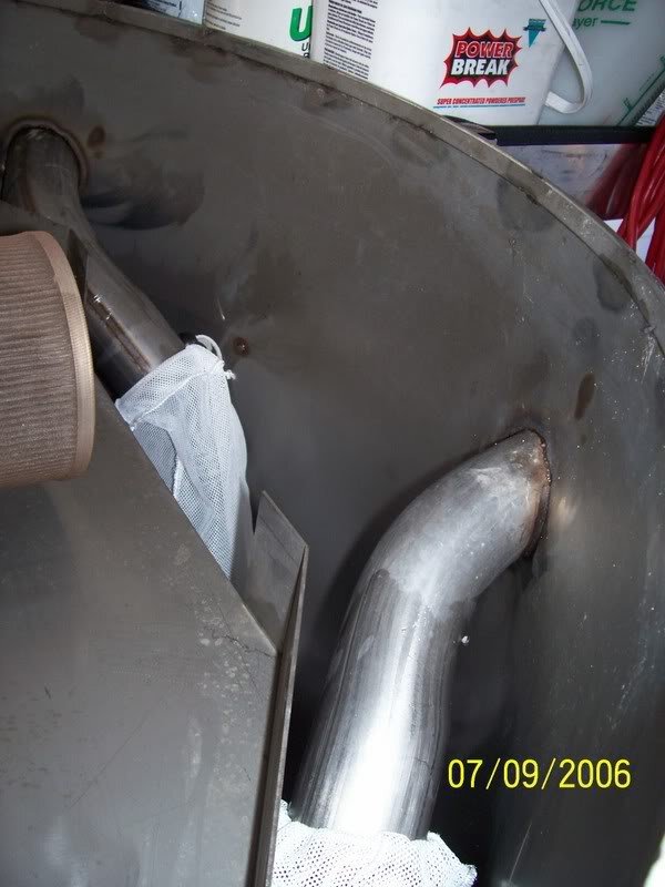

The best thing I ever did. That kit looks really good. AT did a good job on that. I had a local welder do all of mine. I think everything cost about $440, metal and welding. I got a good deal.
I dumped the filter sock in about 10 min. of use.

18,851
Benton KY USA
Lee Stockwell
The FlowEzy filter(s) at the top look to be pretty loaded up too. Spin them off and clean them from the inside out. Hope there is more than one??
adamh
1,533
Nampa Idaho
Adam Hale
Lee
There is 3 filters and the discoloration you see is the pantyose that I have on the filters. I clean mine everyday.

18,851
Benton KY USA
Lee Stockwell
Re: the filter comment
I see the kneehigh cover, but I was speaking of the stuff in the pleats, especially noticed at the ends. If you pressure wash the filter out from the inside it looks like you could blow that out.
We run two 3" ss Flowezy filters on each of our little 47's, so three sounds about right for the bigger blowers. I've seen a bunch of 405's with the fitting reduced to use a 2" filter...bad economics.
