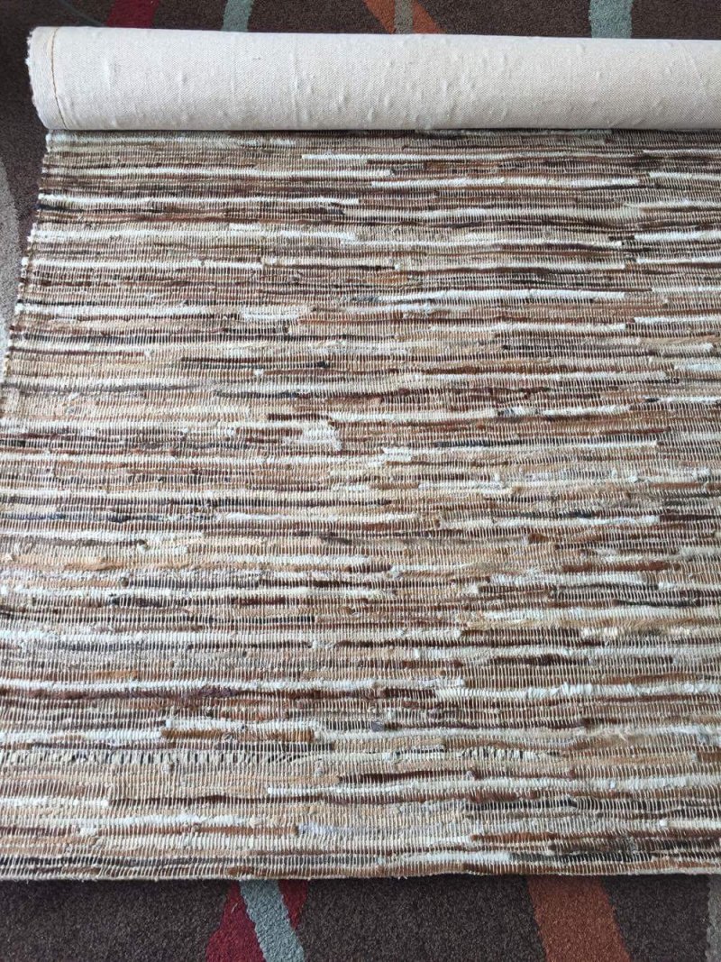

I've gotten a few tips from our local vendors on cleaning this. Have not come across 100 cow hide with 100% Cotten back. It can't have to much moisture on it as the glue from backing could start coming apart. Was recommended to use Solvent Cleaner by Bridgepoint. Hand wipe on and possible brush in and wipe to remove? Anyone cleaned one of these before and how?

I feel confused.
The rugs pictured in the first pic both seem different, neither one looks like leather/cowhide.
Also, I don't see on the label where it mentions solvent??
The pic with the label also does not look like cowhide??

@ShortyDownUnder it looks like patchwork cowhide rug... Will just said it was recommended to use solvent...it doesnt say that on label tho
